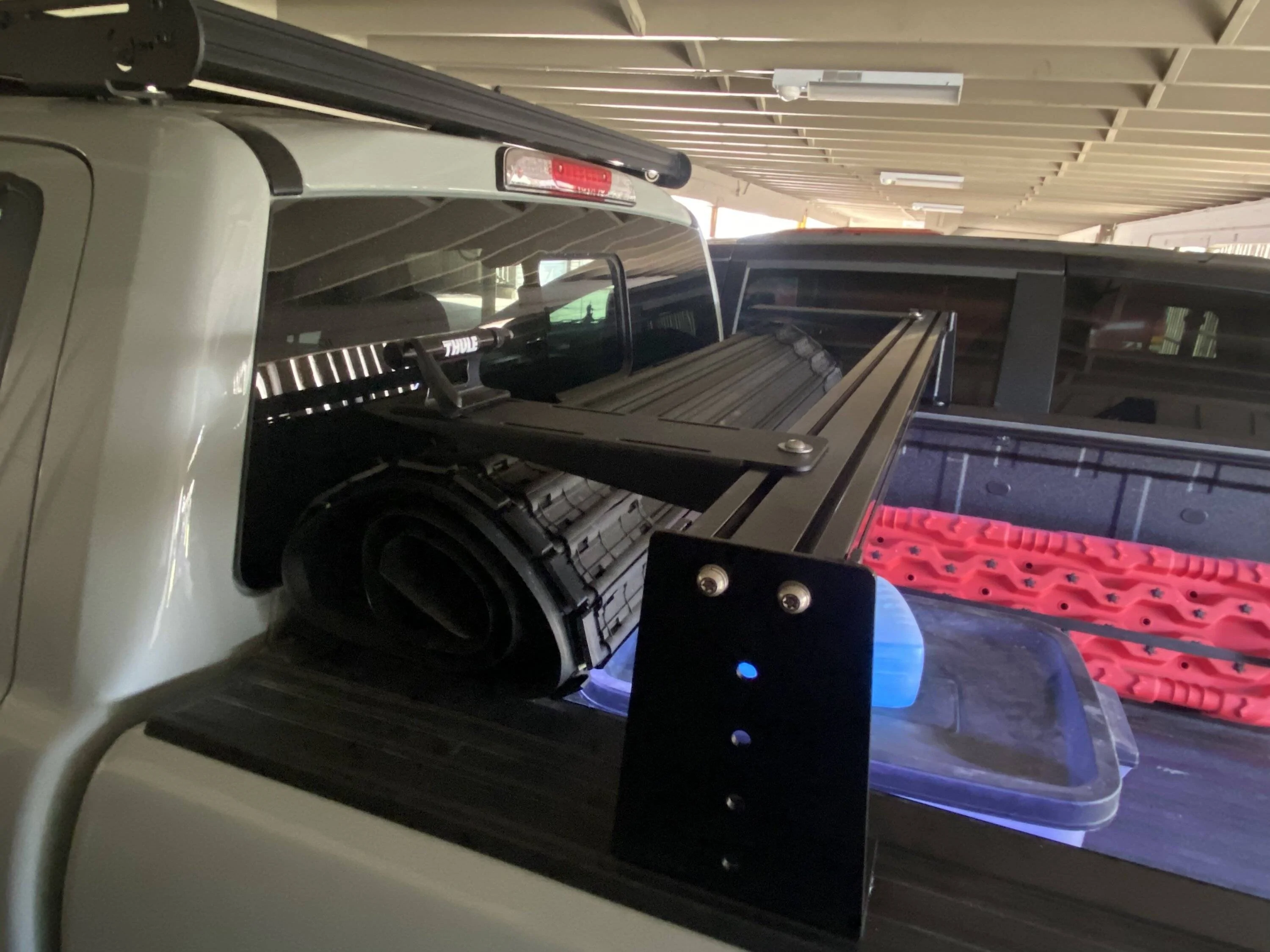

RCI has adapters that allow tonneau cover’s. Billie Bars also allow covers and a low profile for a tent to mount. RCI now makes similar to Billie Bars system. Some tents can hold bikes on them as well. I think GFC tents can accept bikes.

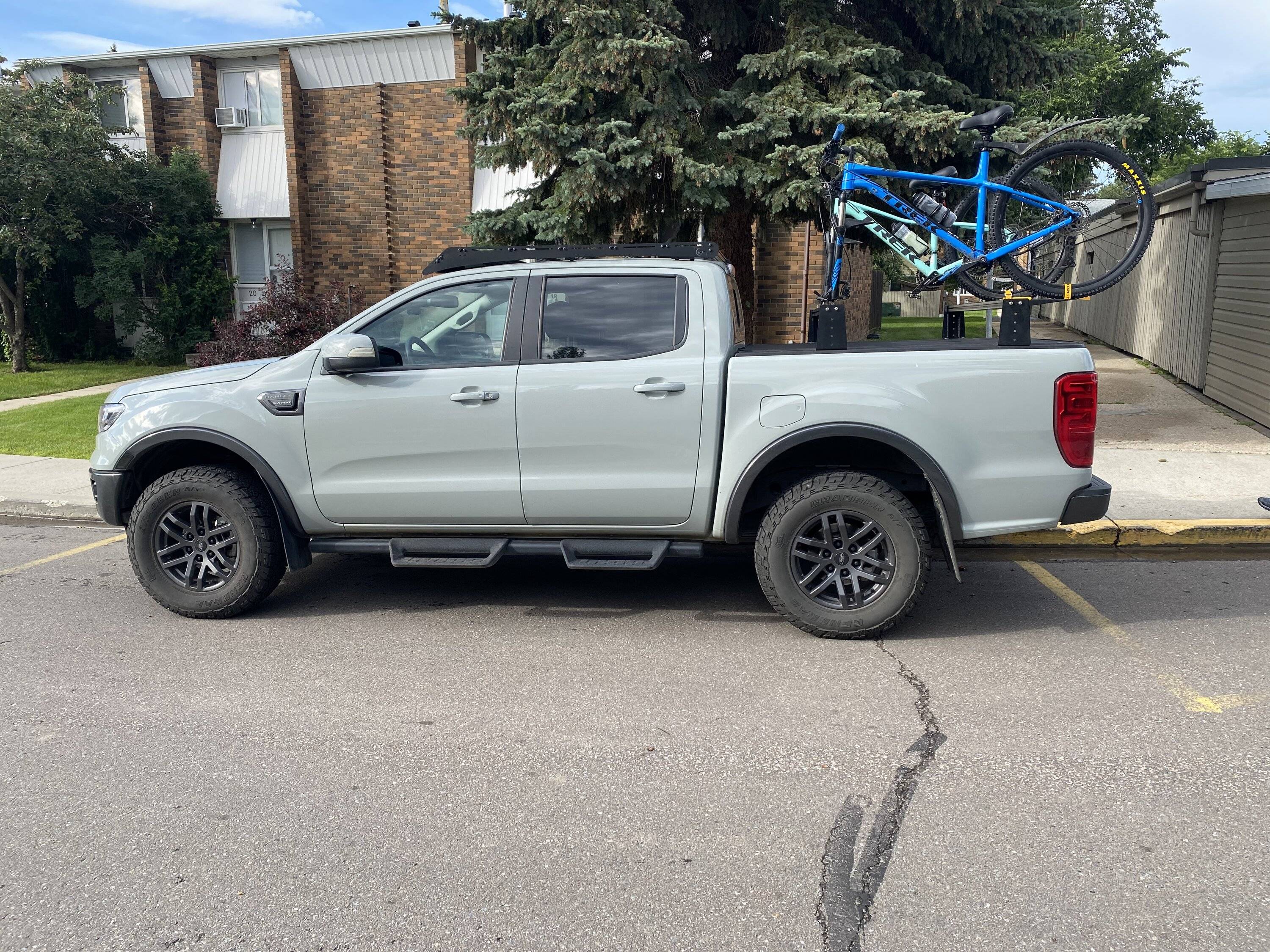

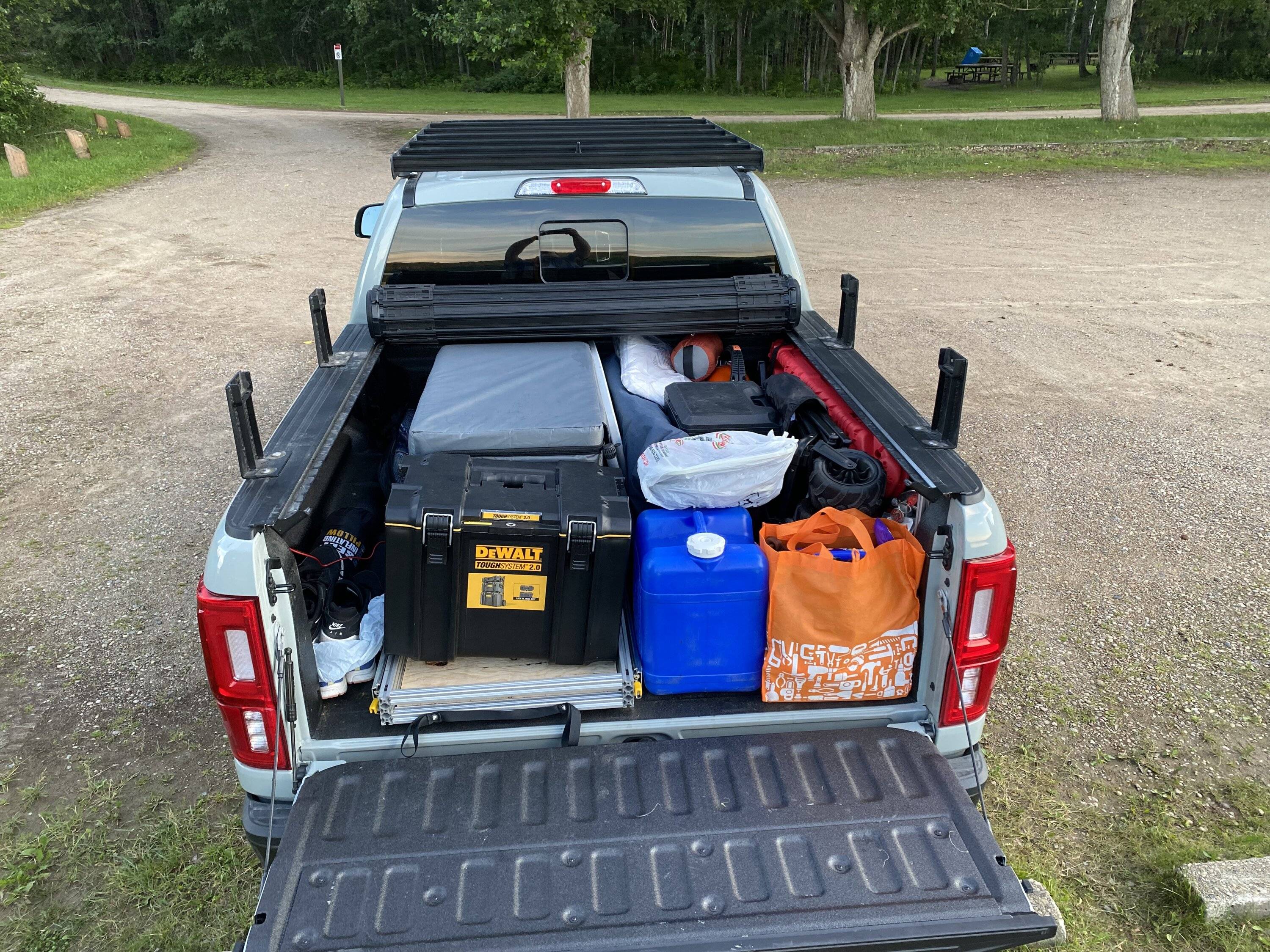

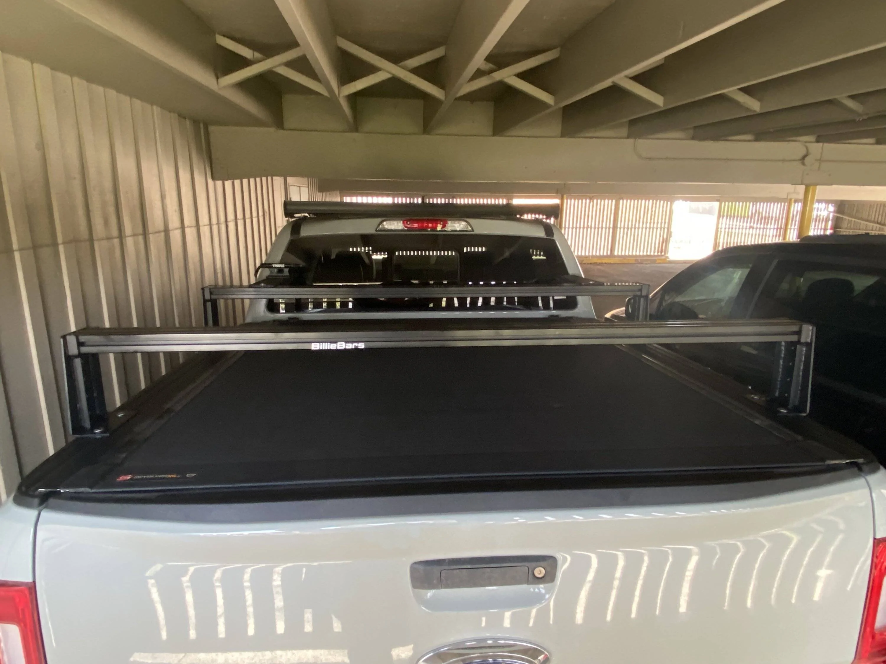

Have you considered the roll up aluminum covers? I have the Bak Revolver X4S. I installed the taller Billie Bars over top of it. Still rolls up. nice to have a secure space for daily activities and the utility racks stay in place too.
For the record - BillieBars use a clamp that wraps around the bed rail. Once they are installed, tonneau cover rails can then be added. This both raises the rails and moves them inwards. I didn’t want that. So I cut up the brackets and bolted them through the bed rails.
