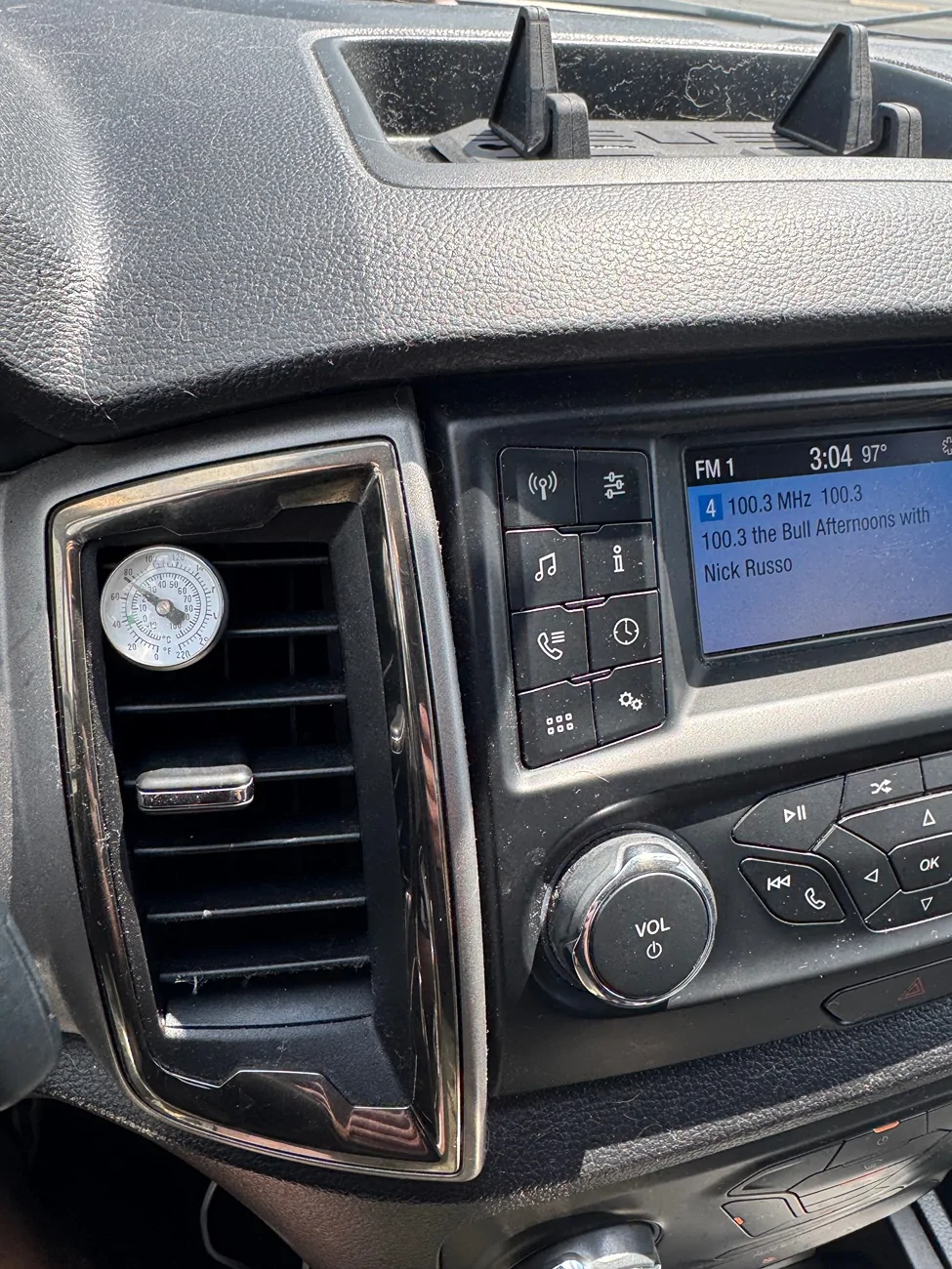

This is the temp at idle when it’s 97°F out and thermometer is showing almost 80. Why test it in the shade? That’s the only part that makes no sense to me
Edit to add: This is the thermometer that I use
Because the (Test) parameters (pressures) etc are set with a controlled environment of - Ambient Temps + Humidity (Ranges) - Direct sunlight can skew the results
but for that reading - its either slightly low on freon or the condenser is clogged with debris, this still does not explain the blower speed drop on its own
Would be curious what the AC Press PID is reading
