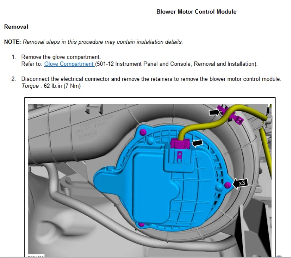

I have checked the diagrams for any obvious standouts for a tie in to both that would ONLY affect these 2 functions - nothing stands out (YET) - so unless there are other symptoms - (anything) that flickers or noted inop - I do expect its pushing out a code that may help pinpoint it down and its most likely a Lost (Com) type code.
Plus - if you have the ability to - Live Data Monitor - all the modules have a - Module Supply Voltage or Similar PID - these can be monitored to see if the voltage is actually dropping - this would be beneficial data if you are using a plug in volt meter in the power point and it maintains above 12.2 volts at idle.
If we only focus on the - Blower Motor (Issue)
Then we have - Always Hot (Relay) - so main battery feed to the BJB and related cables and then the control side via the FCIM
