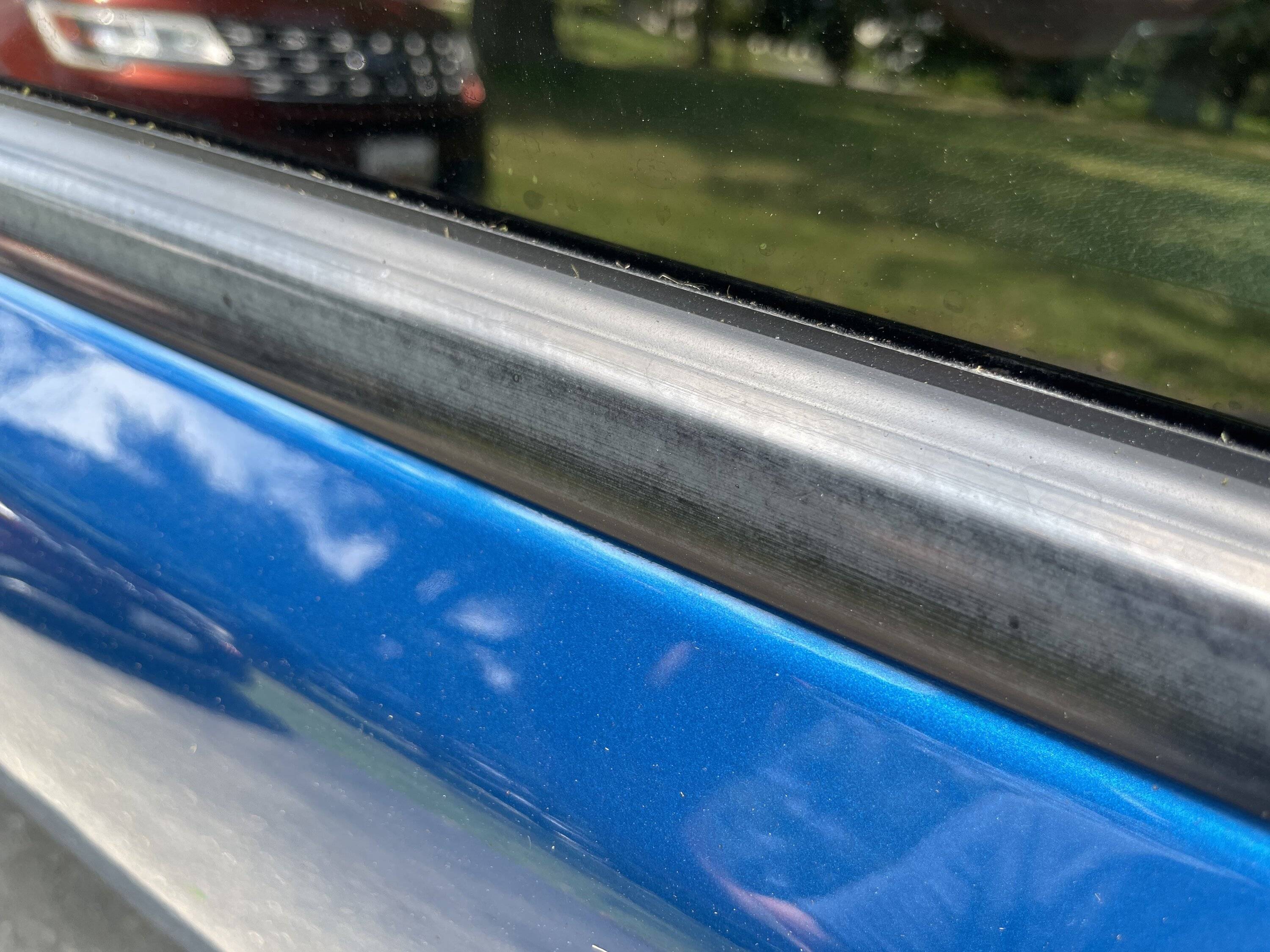

I just meguires ultimate black and magic eraser. It kinda seems that the magic eraser does the work, but the meguires softens the rubber a bit. When you sand away on the hard white level you get to more softer black rubber. I just used blue tape on the paint and did all 4 of them in about 30 minutes. I cut the magic eraser into little bits.
I was thinking of buy all new ones. This was easier, faster and cheaper.

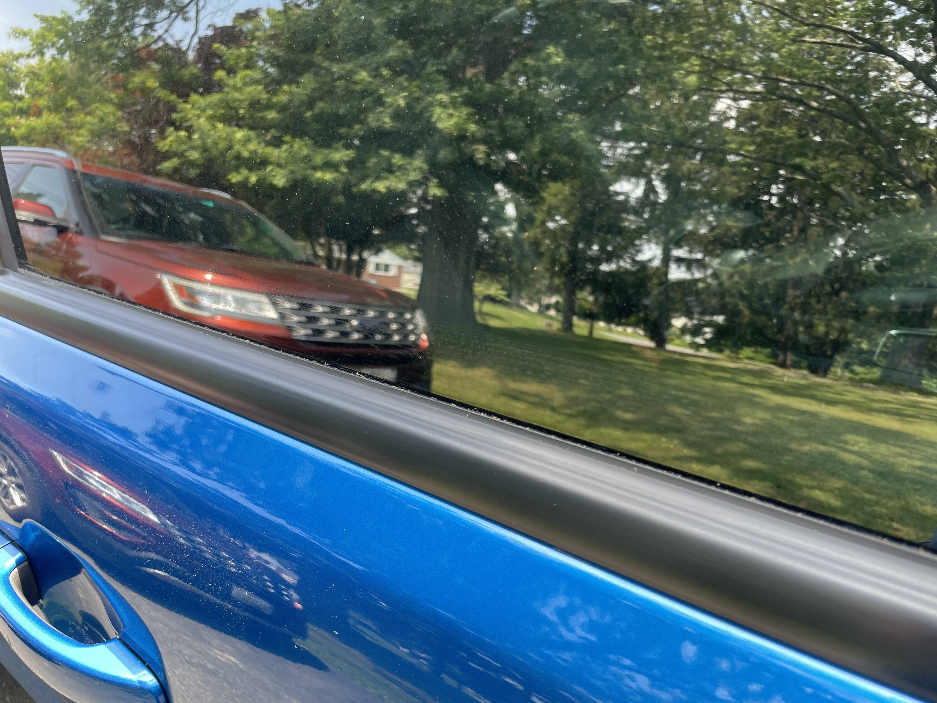

My window trim molding on both sides has faded from black to a scuzzy grey. It looks like there is a clear protective strip over the molding which has faded to a cloudy grey, causing the discoloration. I was tempted to peel that protector off, but thought twice. Has anyone experienced this, and how did you fix it?

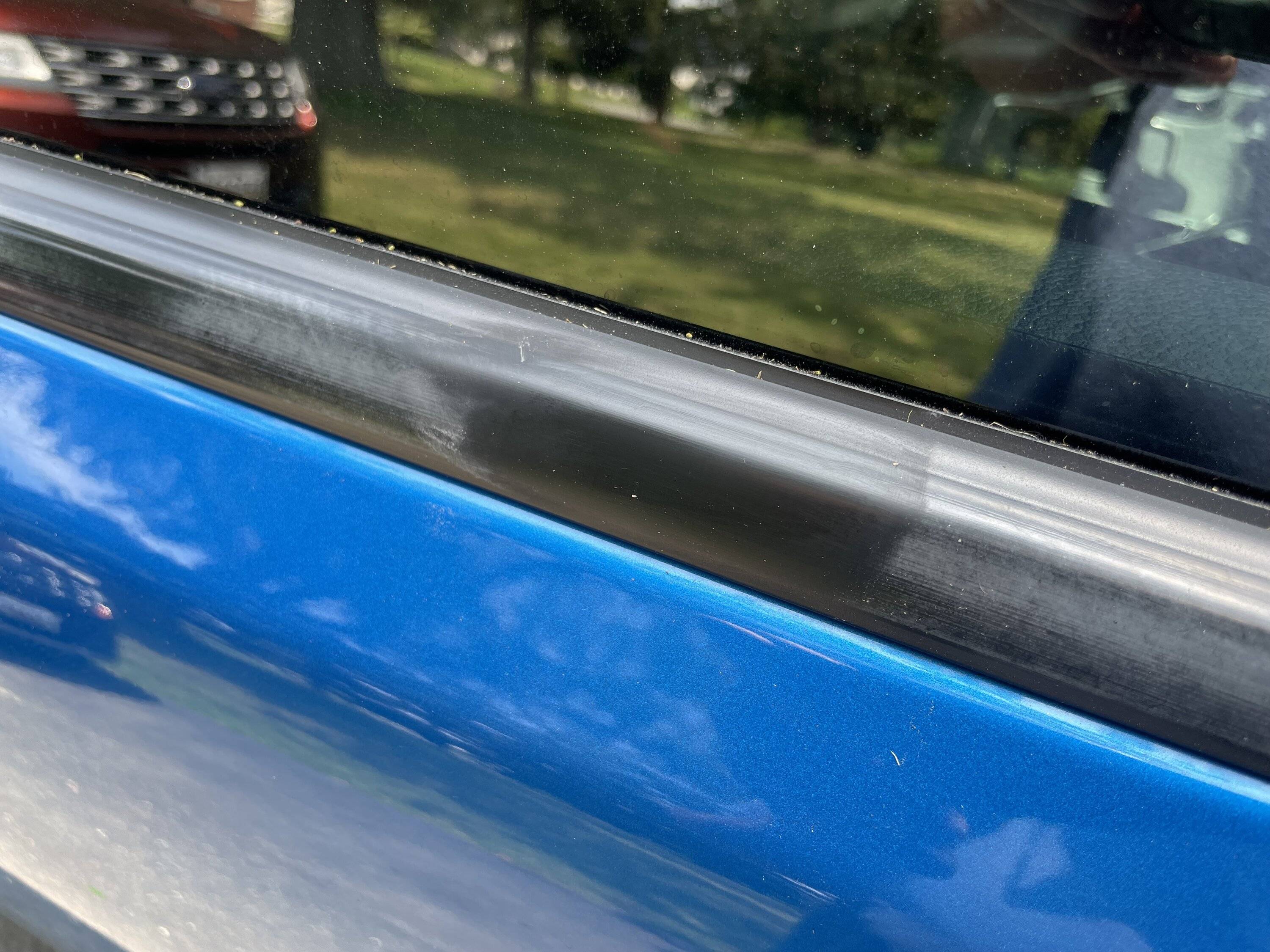

P.S. The dark area in the photo on the left side of the molding is where I tried a bit of rubbing compound, which helped some but still not great.
