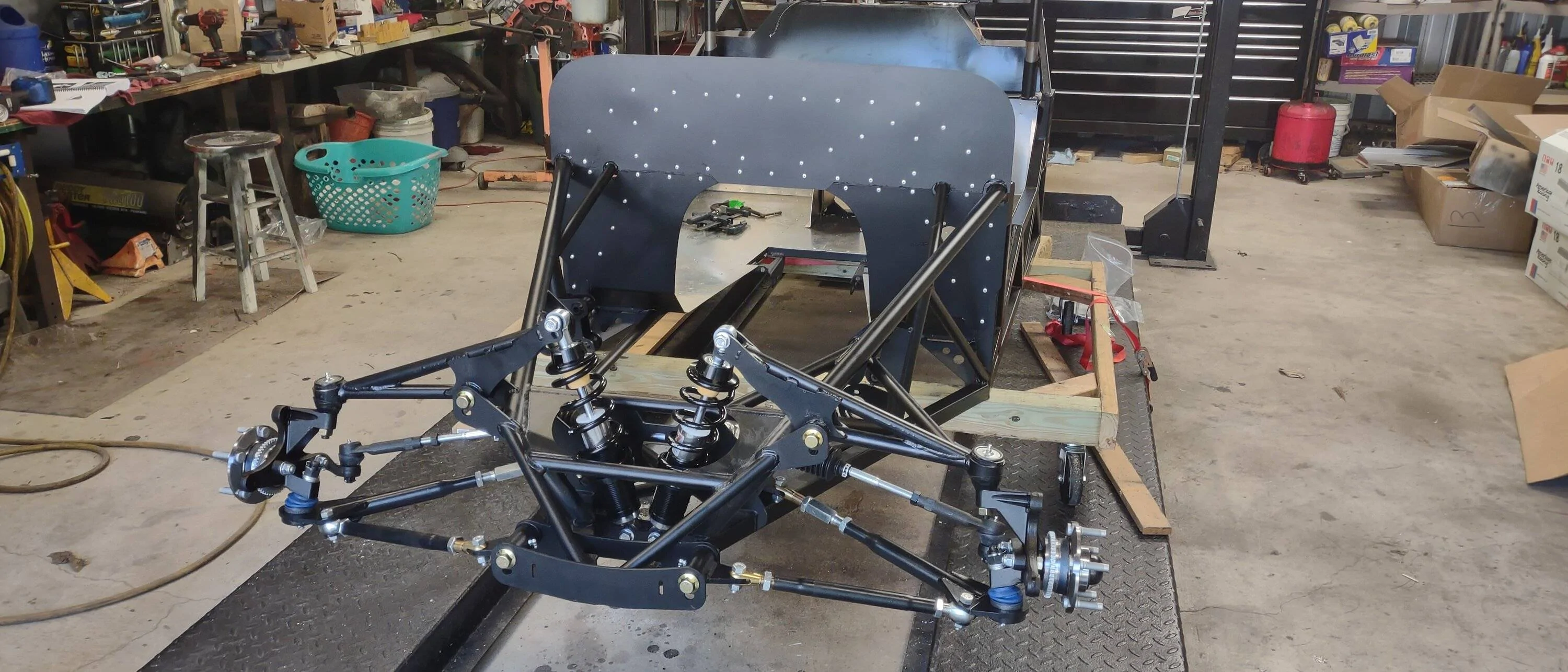

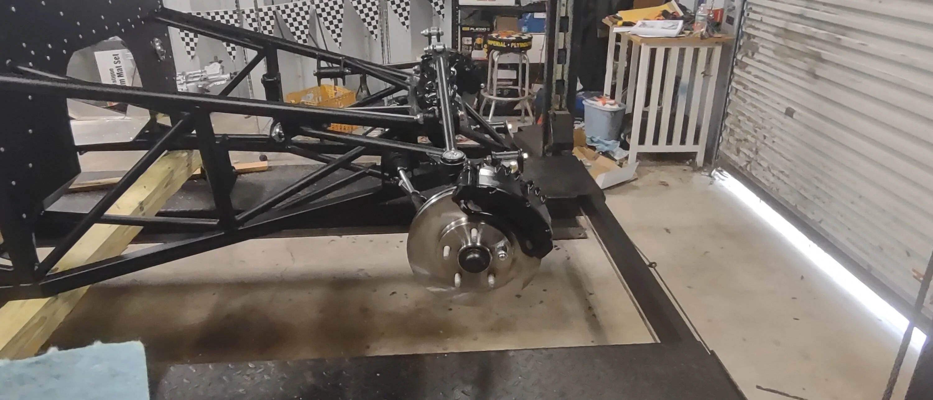

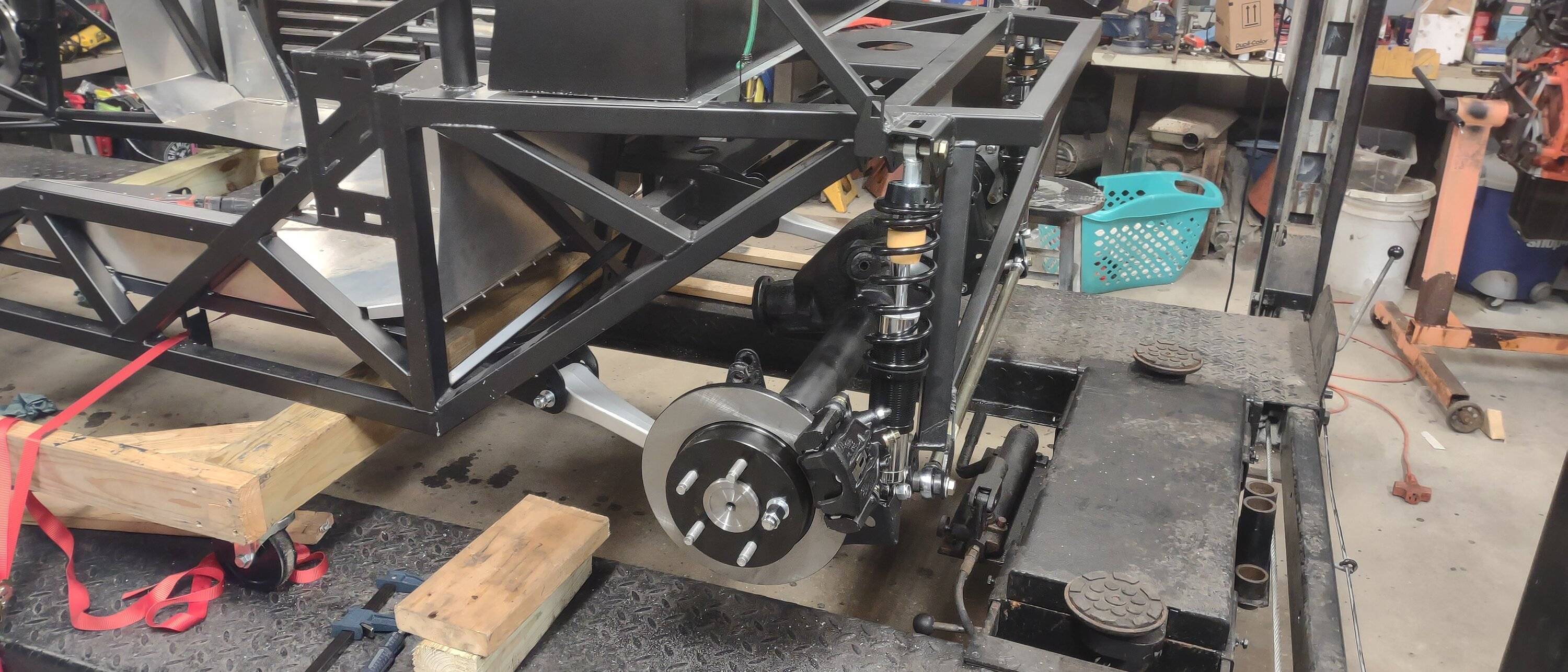

Well some of the back ordered parts came in. This allowed me to build up the front suspension. Hoping on getting the Three- Link upper control arm bracket and control arm so I can install the rear axle. I can then put it on it's wheels and install the power train.

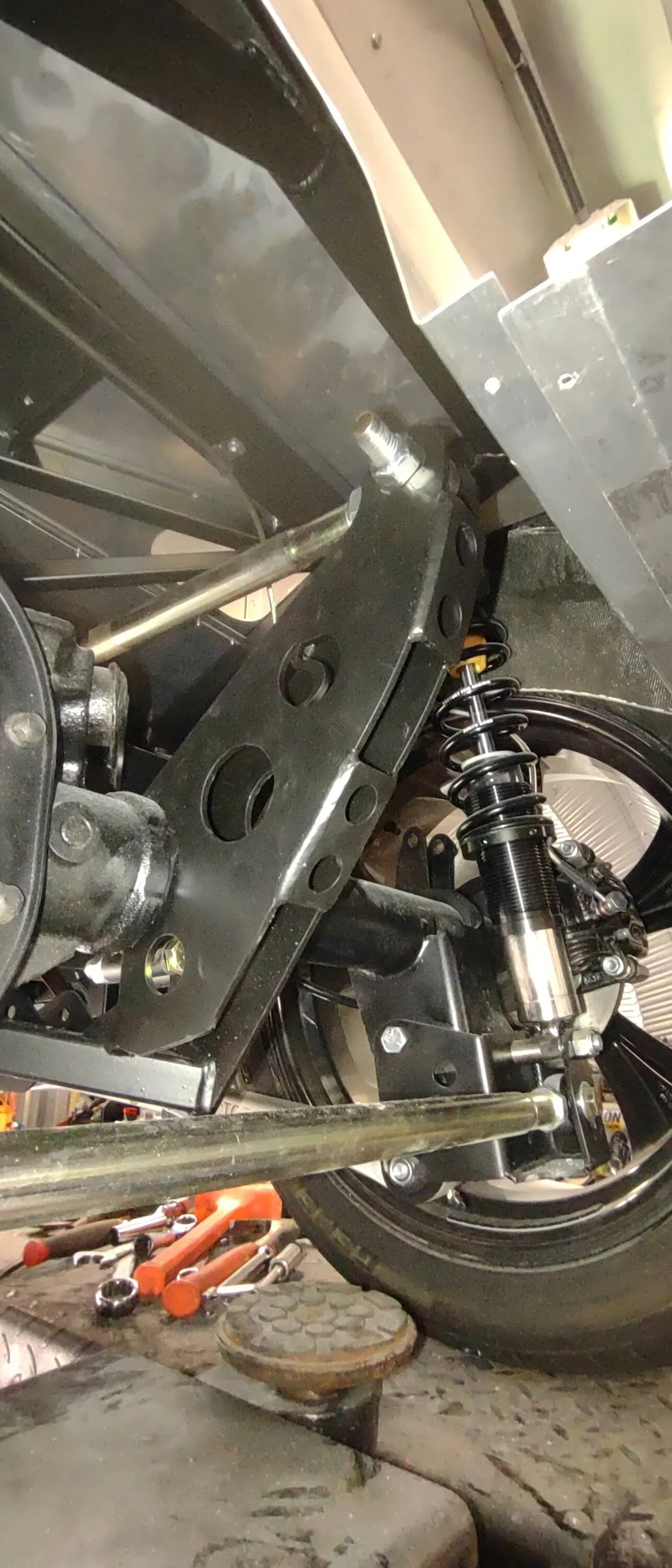

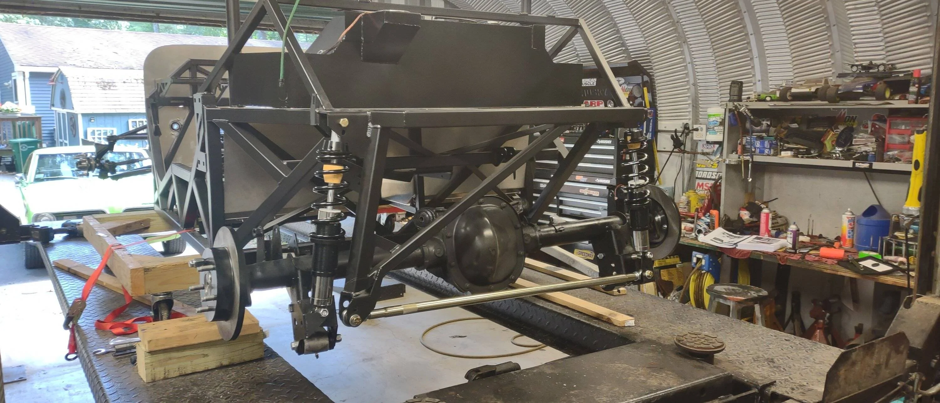

Well I hung the rear axle today even though I don't have the upper bracket for the three-link. I just wanted to see it with the front and rear suspensions on the frame.

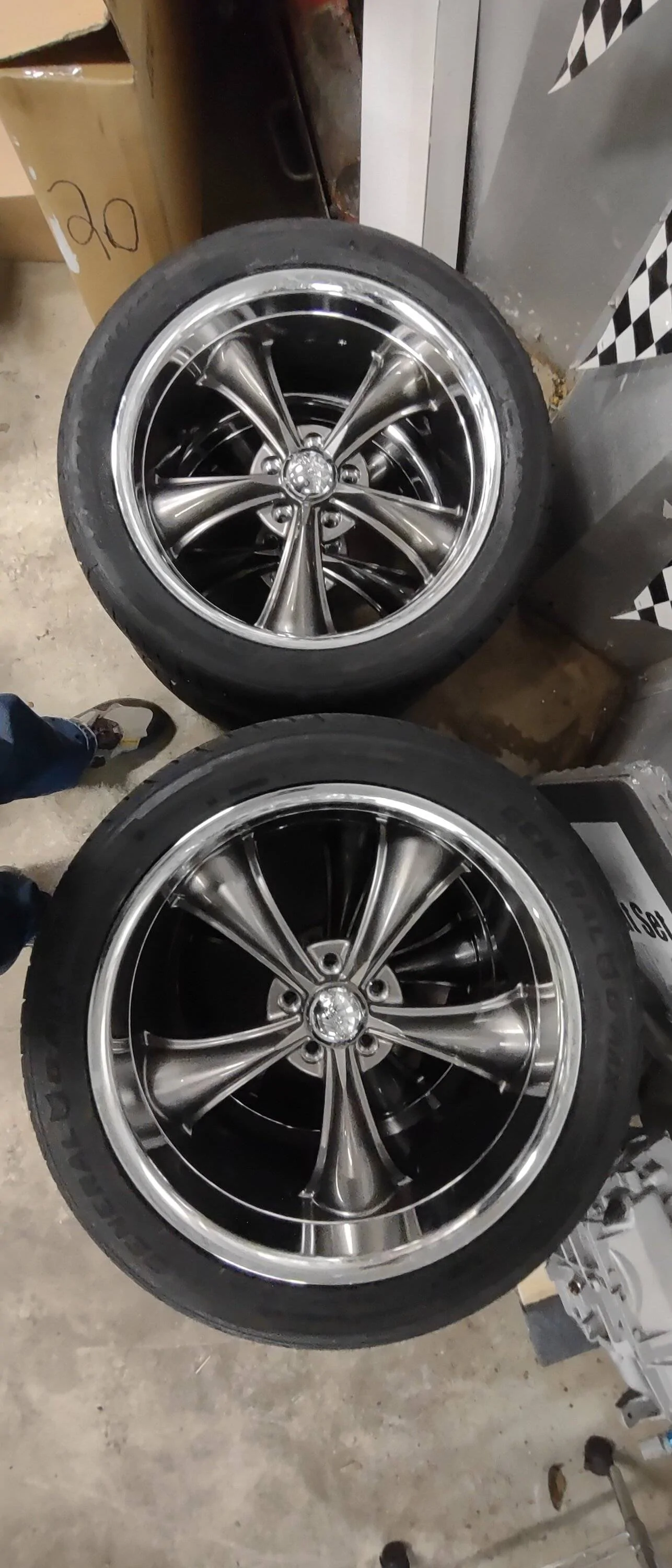

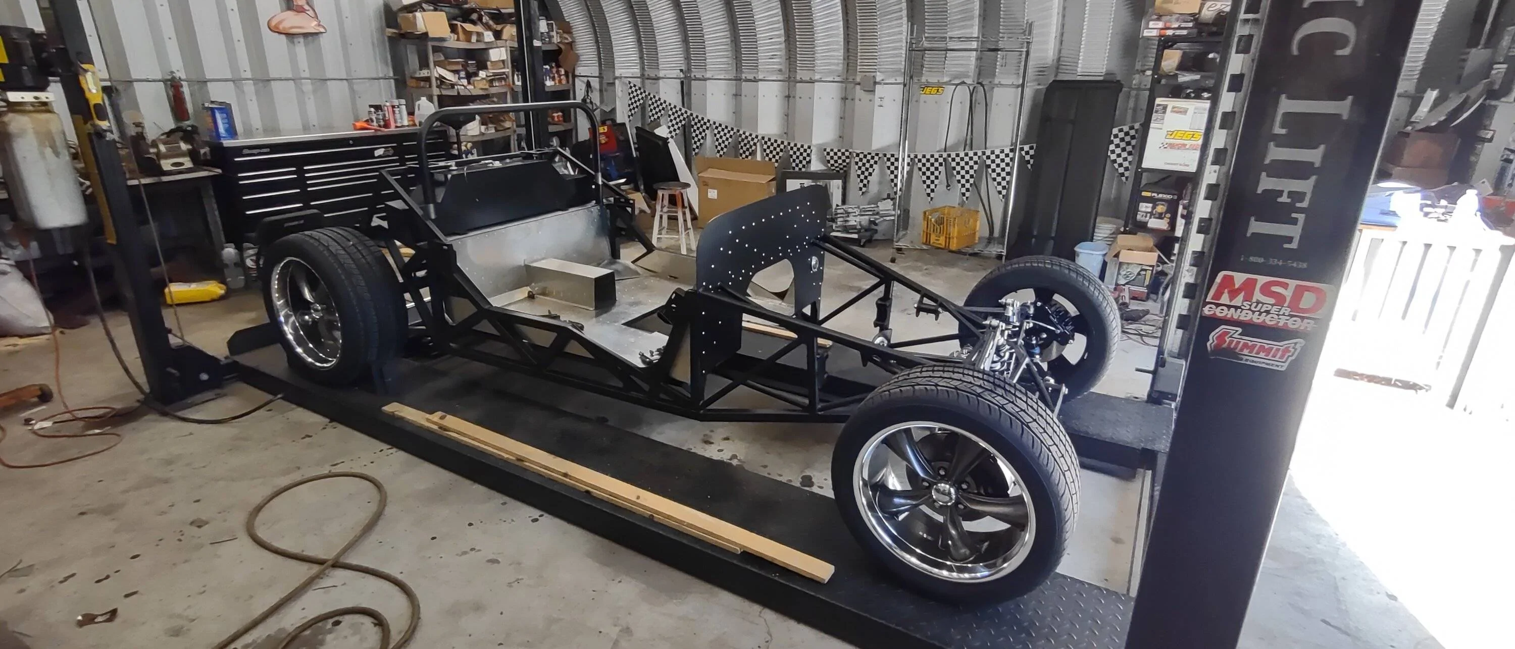

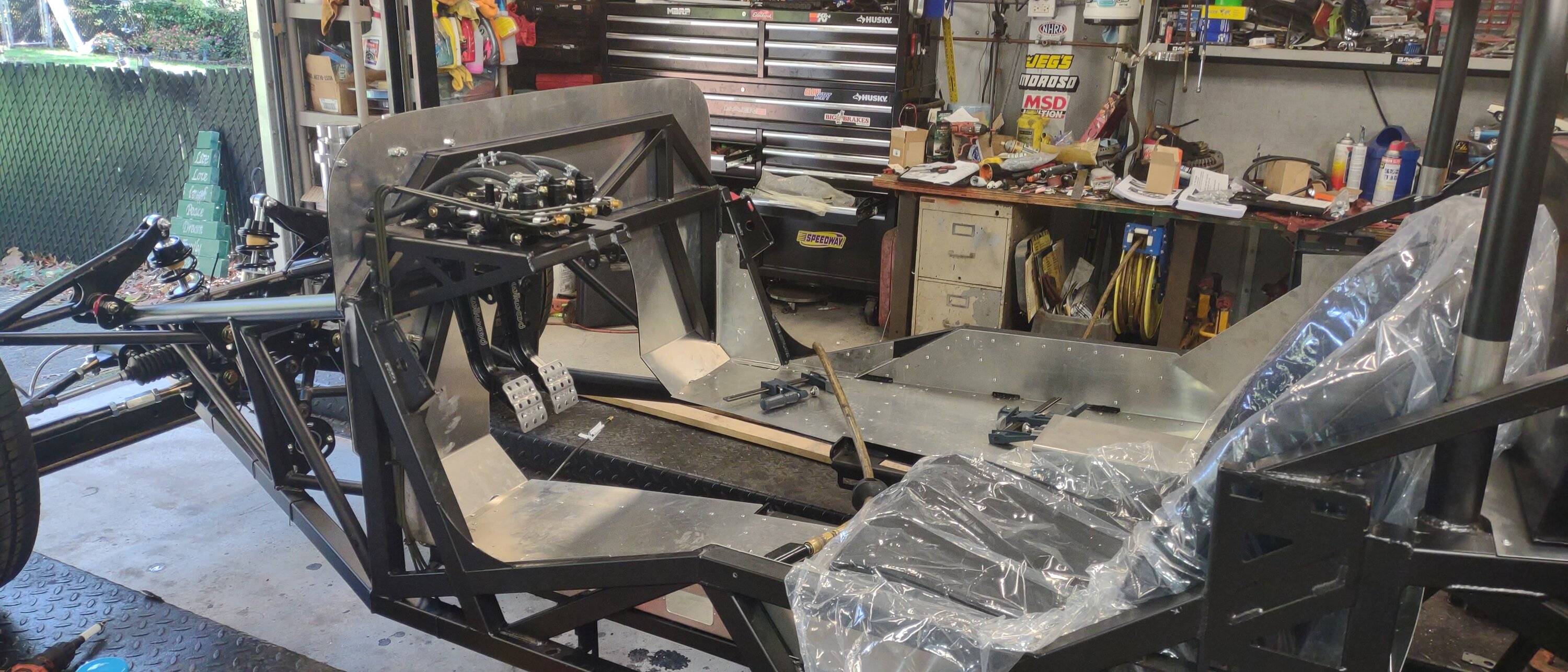

The car is now a roller with 255/40-18s on the front and 305/35-20s on the back. The wheels are American Racing Vintage Boss.
The brakes are installed, plumbed and the pedals are adjusted.
Still waiting on the back ordered steering column before dropping the engine and tranny in.

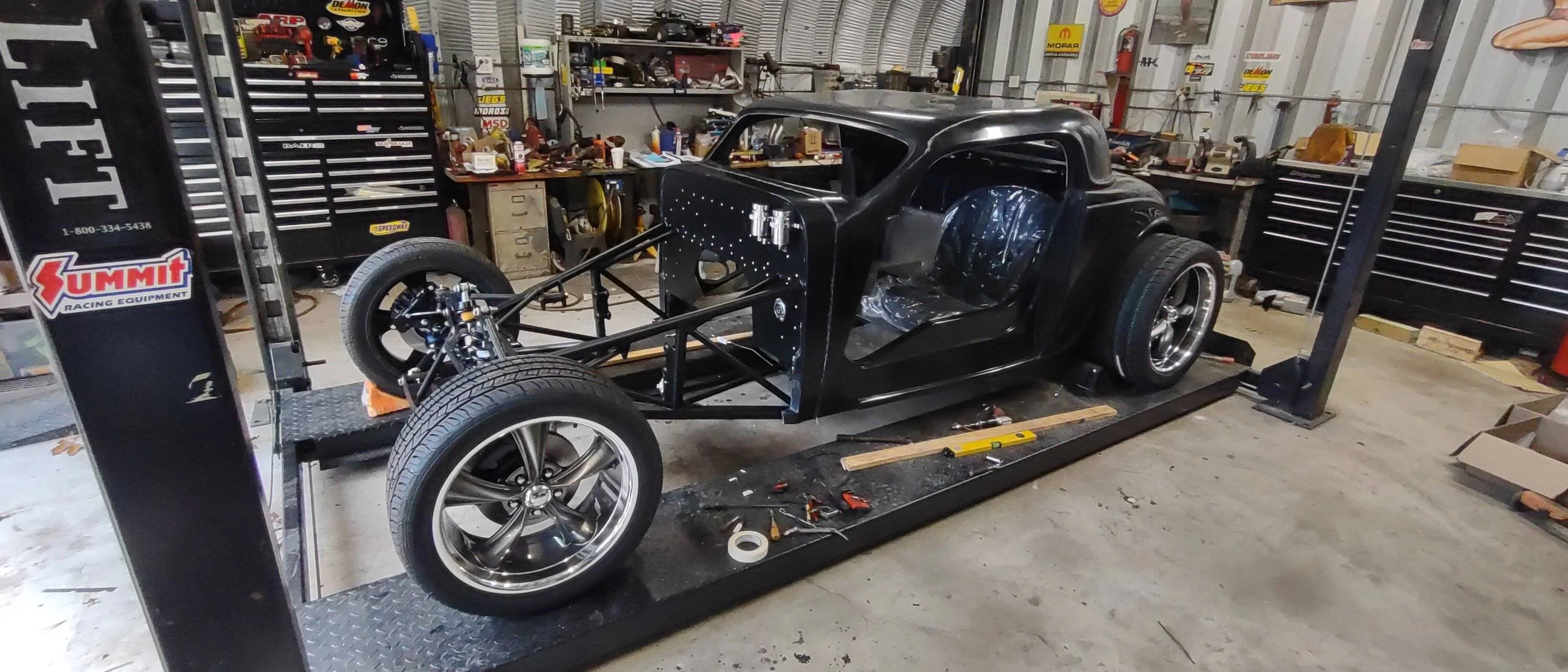

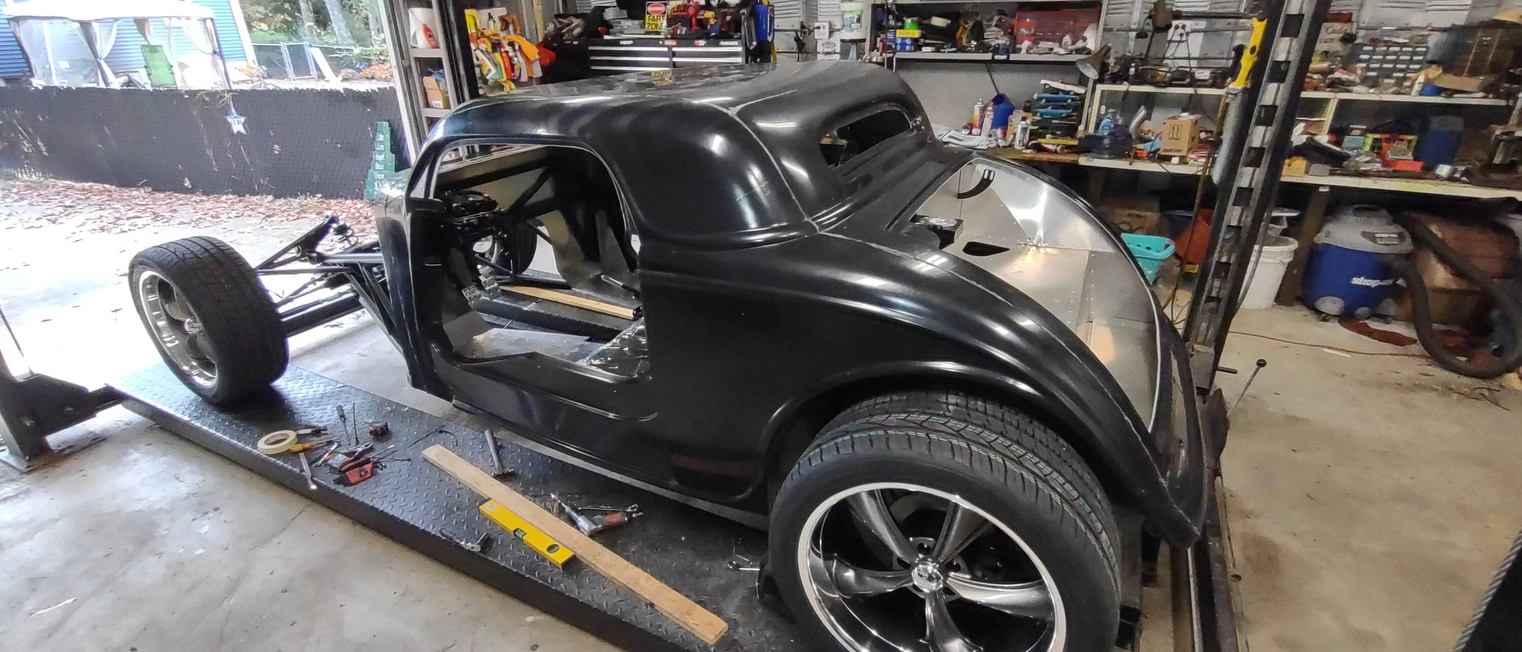

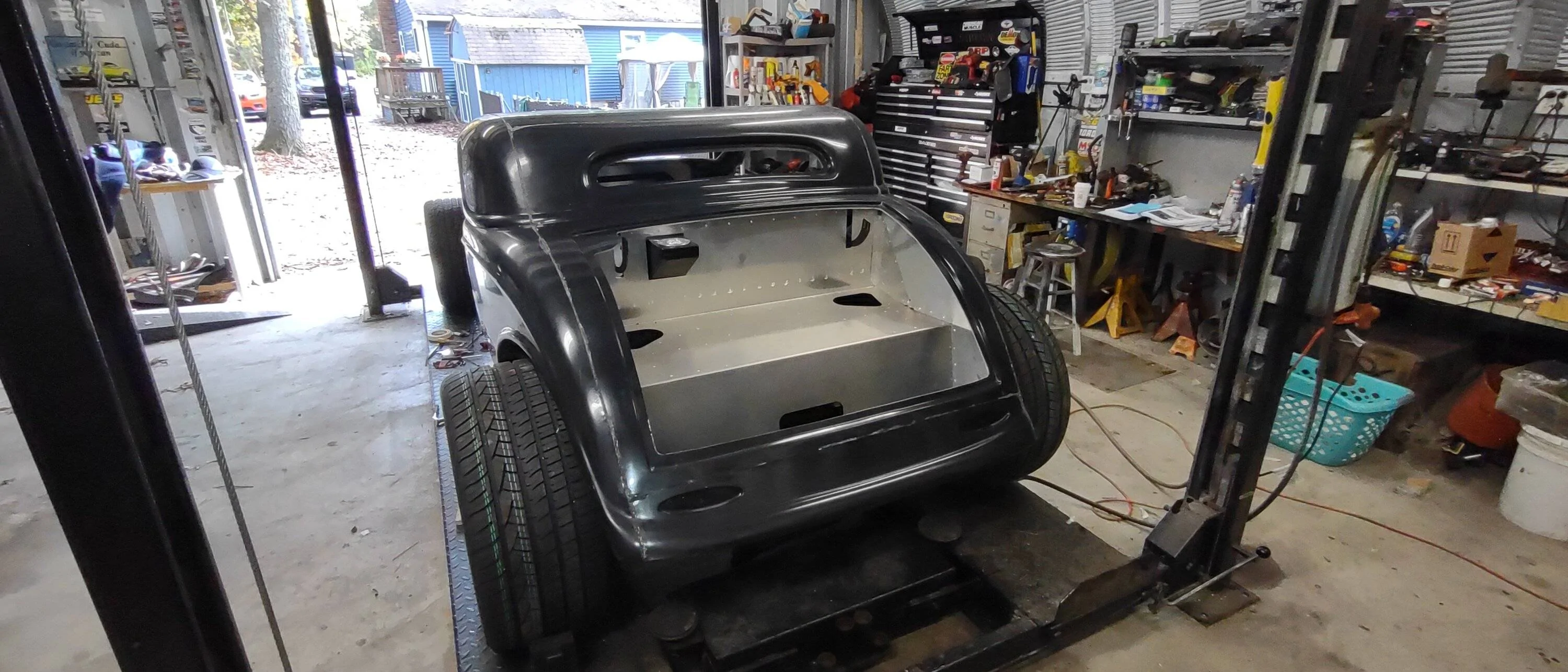

My son and a buddy of mine helped install the body for the first time. Several areas will need to be relieved to fit around the chassis but was great to see the car looking like a car. Once I have the body sitting correctly on the chassis I start working on fitting the doors and trunk.
The steering column and third link Bracket are still on back order so I am holding off on installing the engine and tranny.

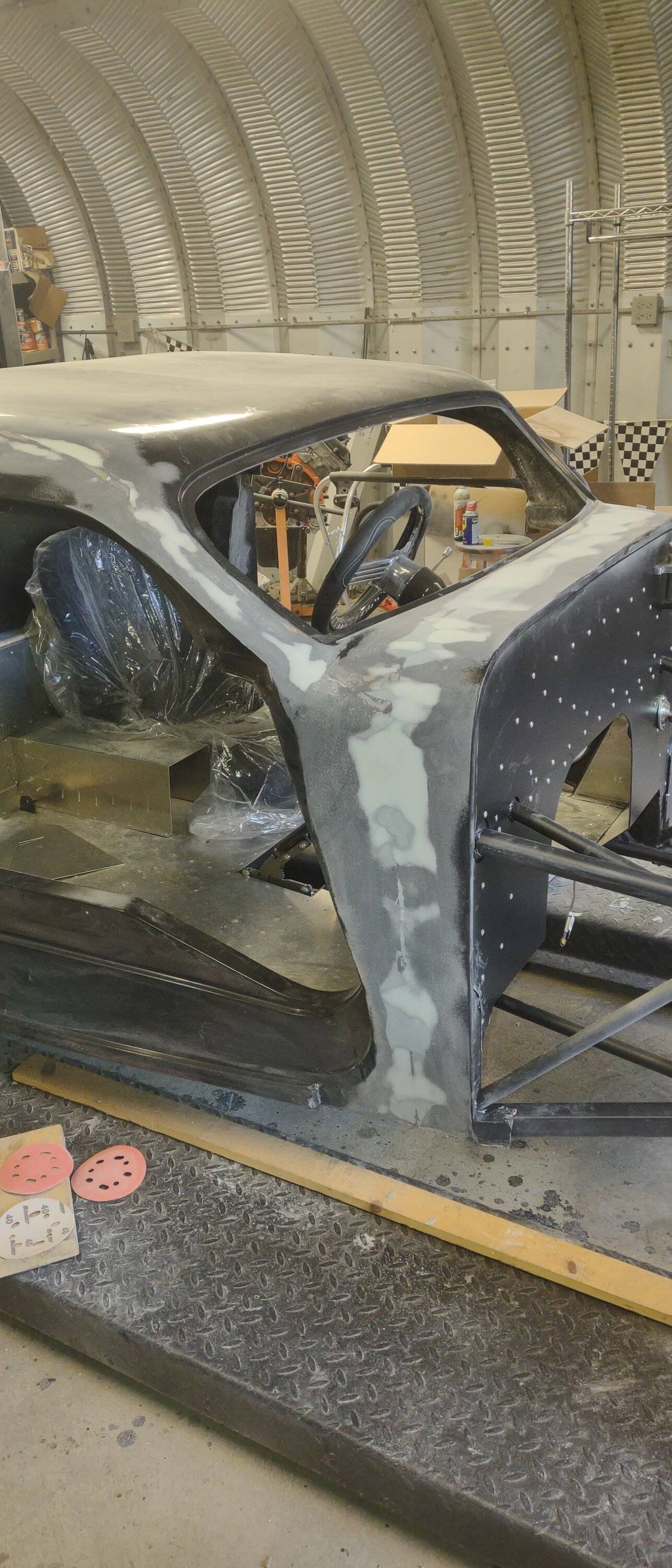

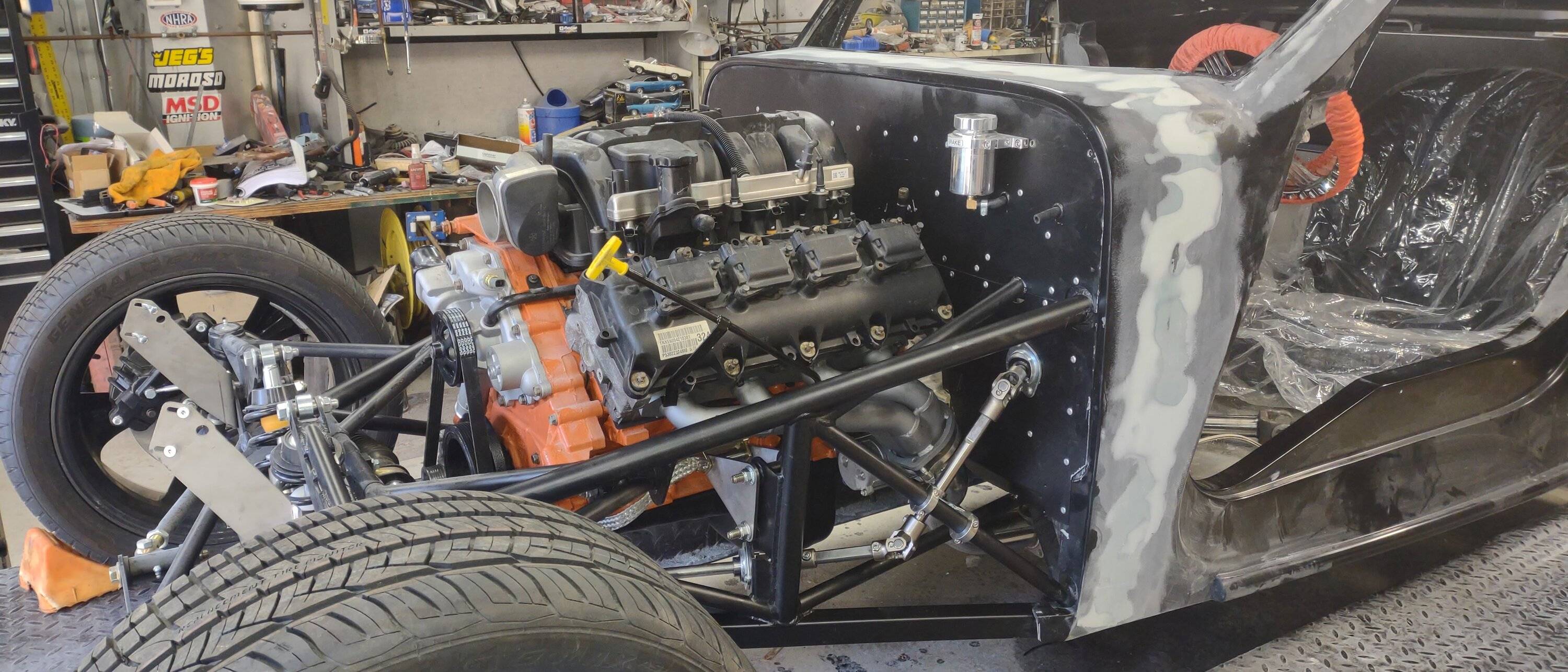

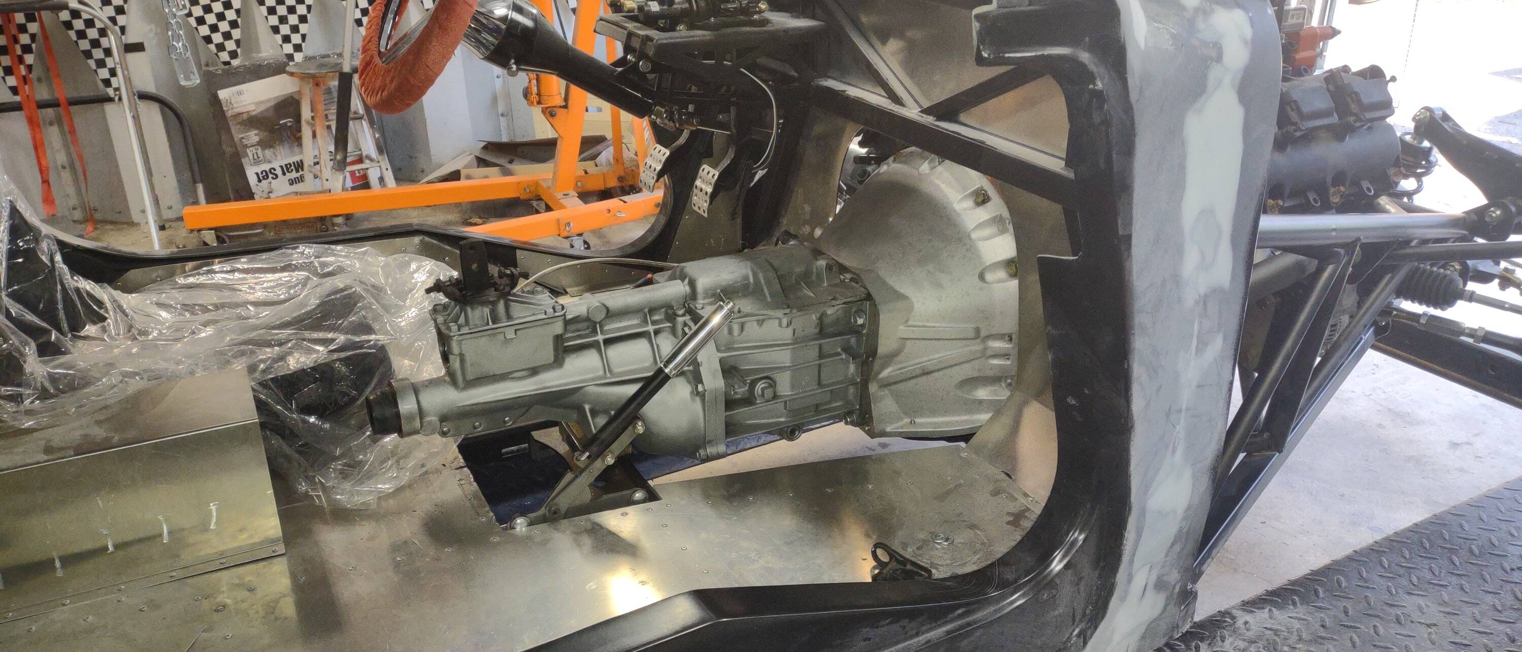

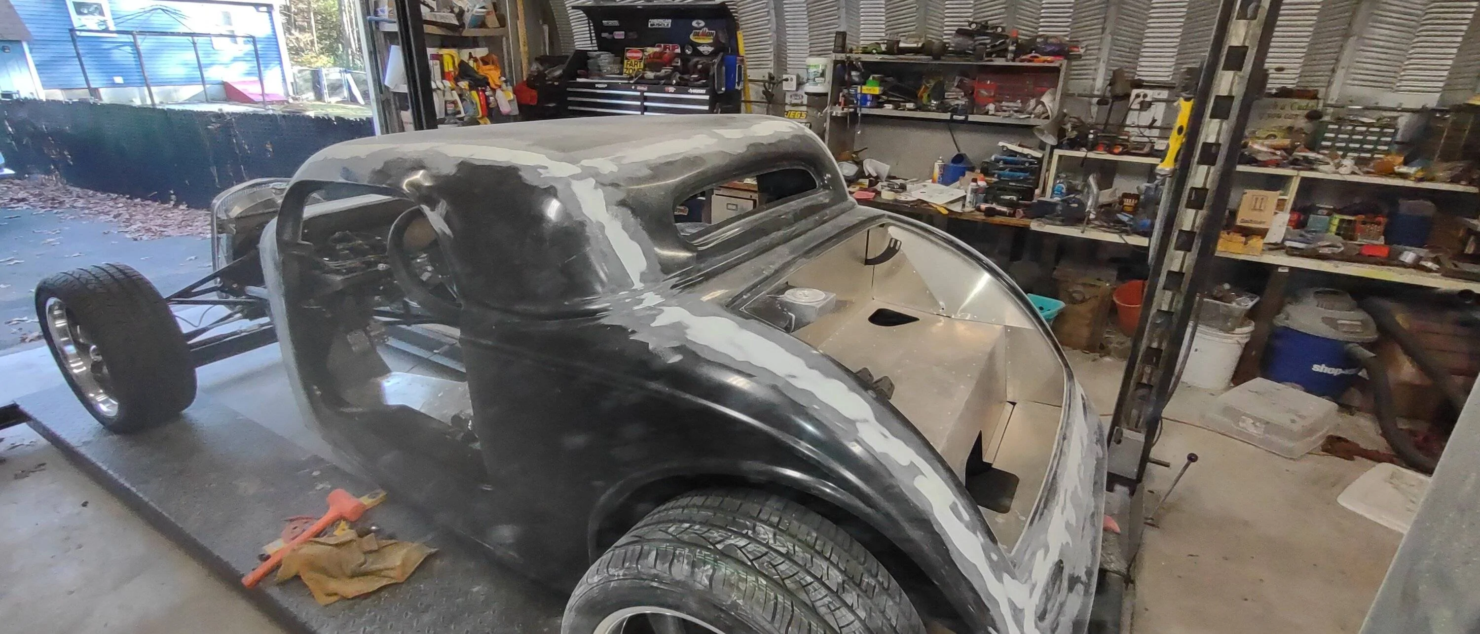

It's been since October since I posted any pictures of my Speedstar progress. So her are some. A little body work has been done, the missing suspension/steering parts have been received/installed, the engine/tranny is installed and I have started on fitting the doors/hood.
