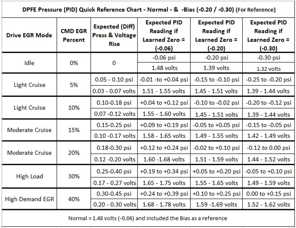

So by using my - Quick Ref chart I made:
Using a scan tool - pull up the DPFE sensor (Voltage/Pressure) PIDs and the (EGR Valve-Percentage - Actual & Commanded
This is the (ONLY) way to see what is actually happening - Live Data to properly diagnose the issue - however Forscan - unless it has been added does not include the DPFE PIDs and requires a high end scan tool.
Sure you can always - Shotgun the most likely part at it, I hate doing this and highly discourage it but also understand that some do not have access to the required scan tool to do it properly.
Focus only on the - KOEO - (Key On Engine Off) readings and compare to Idle readings.
The P0402 is being generated at this transition.
The DPFE is seeing a dramatic change in (Voltage) at idle over the KOEO reading - this being Learned Zero (Reference) of Zero Flow
Which should remain at - -0.06 psi or 1.48 volts (KOEO & Idle) for a perfect system operation and non biased (DPFE Sensor) which has a (variance range) incorporated into the system
and then use what triggers the code

I am leaning more towards a bad DPFE Sensor , diaphragm sticking and will most likely be showing biased (high) out of normal range at (KOEO)

The above is just a general - T-Shoot there are more in depth PIDs to look at for the complete system and I am only posting for the most likely cause - The DPFE Sensor - Itself as it has been proven to be a common failure point.
I highly recommend looking at this sensor (PIDs) first before replacing the EGR Valve.
The DPFE Sensor reading is what is triggering the code and it needs verified it is an accurate reading.
