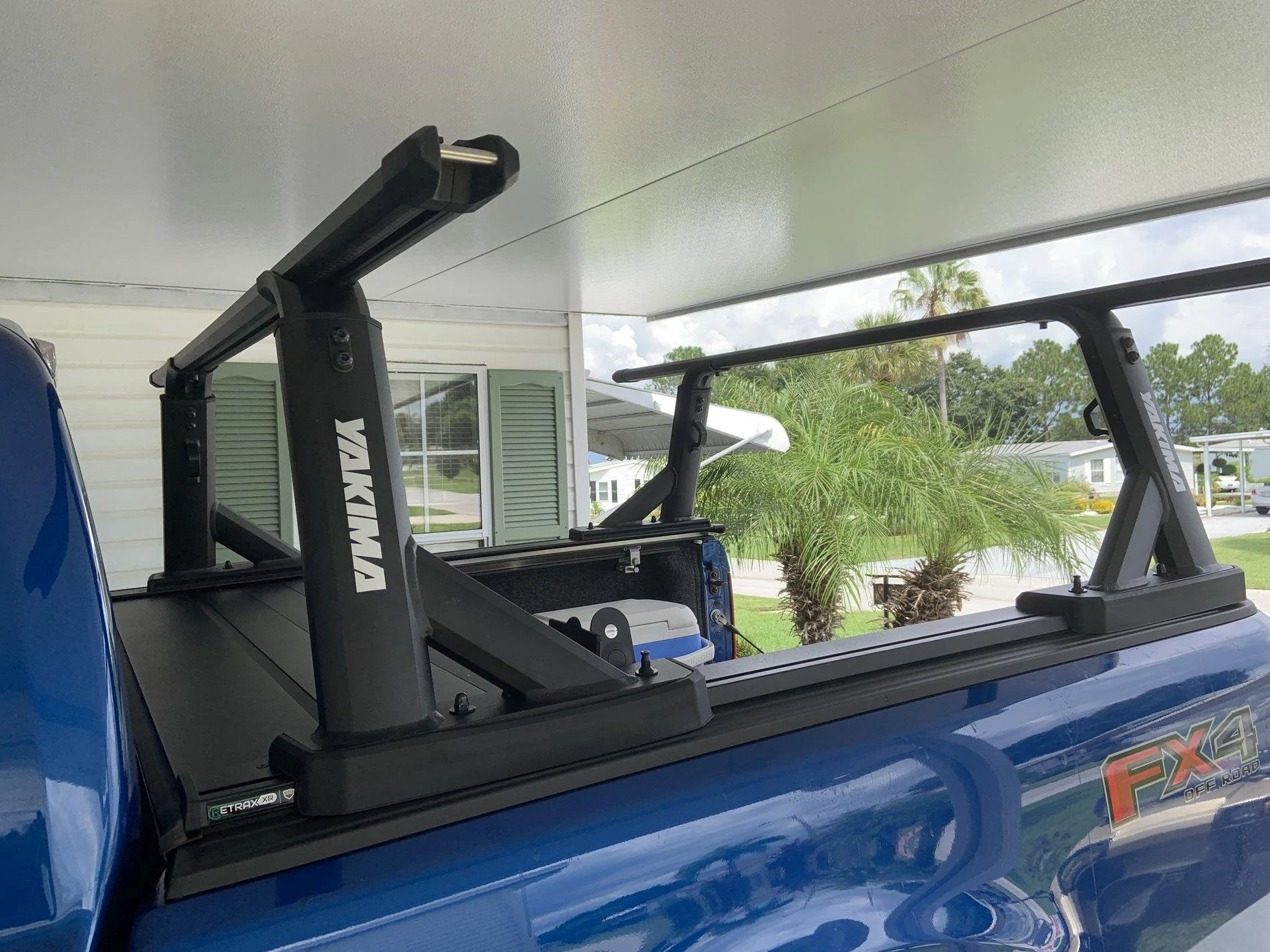

Tonneau Kit 1 finally got out of backorder and I installed the yakima rack on the retrax. I am going to mechanically fasten the cover to the rails with bolts, I will feel better knowing I have a solid connection and not a clamp ....
You didn't install your locks ;)
Bobkat already have the Yakima Overhaul, what adapter/mount do you have to get for the Retrax?

Tonneau Kit 1
Adapter Kit For Select Tonneau Covers
Product Details
  • Specifically designed to fit Retrax XR series, Pace-Edwards (except 2004+ Ford F-150), and Ford Embark LS tonneau covers
  • Engineered to work seamlessly with our OverHaul HD and OutPost HD truck rack systems
  • Securely carry 300 lbs. of gear on-road and up to 180 lbs. off-road
  • Build to last, with aluminum and corrosion-resistant hardware
  • Integrated SKS (Same Key System) locks to secure your rack system to the tonneau cover

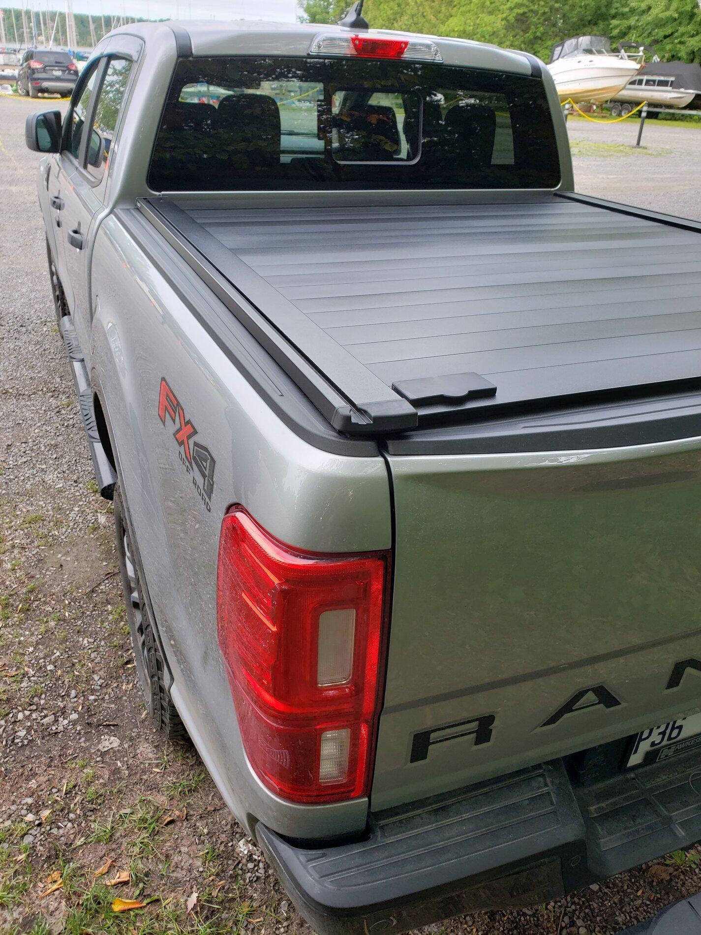

So a month later it finally came in and installed.
Happy with it but just wondering if there is supposed to be a bigger seal above the tailgate. I can stick my finger through..

Have you figured out the tailgate gap ? The instructions say, " It is important to push down on the rail while tightening ".
Did your kit come with white nylon spacers for behind the clamps ?
Did your kit come with foam filler blocks to plug the holes in the forward top corners of the bed ?

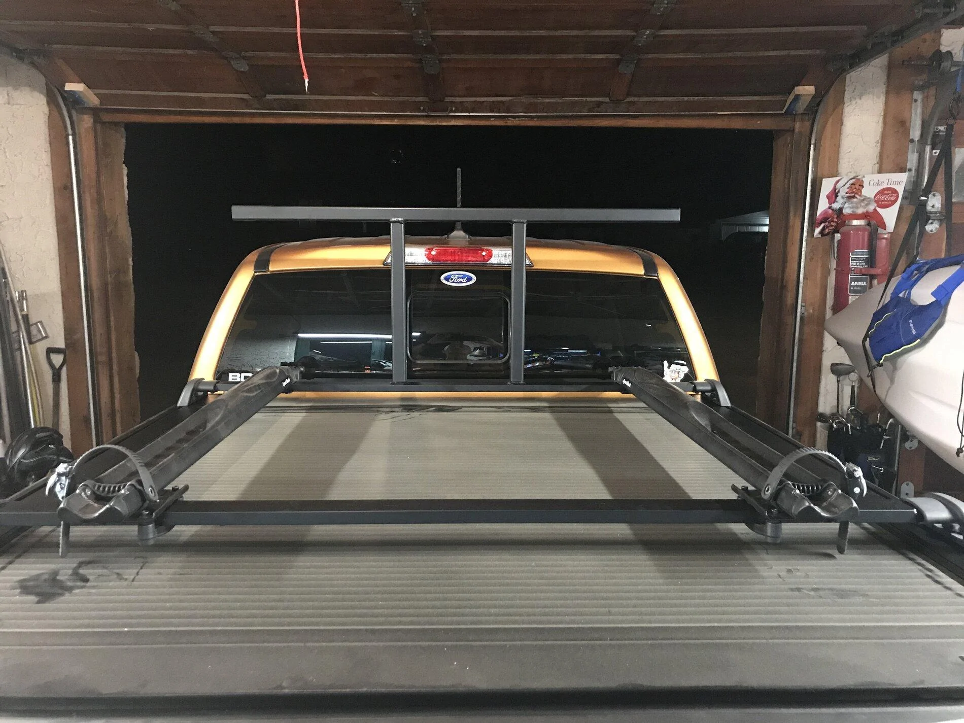

I priced the same cover when ordering my Ranger. It was $1400 more through Ford(Canada) than I could get it for direct from ReTrax. Took 2 months to get- install took me an hour and it had all the right pieces in the boxes. I love the cover- works great, keeps rain and snow out. I’ve sealed up the box and nothing gets wet inside. Made my own custom cross-bars and Kayak mount, installed mountain bike carriers on the bars. Absolutely the best option for my active lifestyle.
The tailgate seal is flimsy. I picked up some self-adhesive backed weatherstrip at a local body shop(5/8" half round) and stuck it onto the metal edge just inside of the tailgate seal on the cover. That took care of any leaks, I can pressure wash and it keeps water out now. As for the sides of the tailgate....still waiting for seal kit to arrive!
