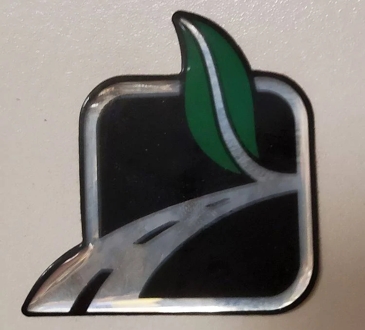

Hi Wil,
wannna bet? I, at the time, launched the largest Flex Fuel vehicle production with the 3.0L Ranger in 1999. Every 3.0L Ranger was able to run everything from E0 through E85. When on E85, you could watch your fuel gauge drop like an anvil off a building. Air/fuel ratio for gasoline is 14:1, E85 is 8:1. Engines ran fine. I hated this program but the Federal Government gave fuel economy credits for flex fuel and we, Ford, played the game. About 135,000 vehicles a year for the Flex Fuel Ranger....
See a older Ranger with a Road & Leaf badge under the tailgate Ford Oval....it is a flex fuel vehicle.
