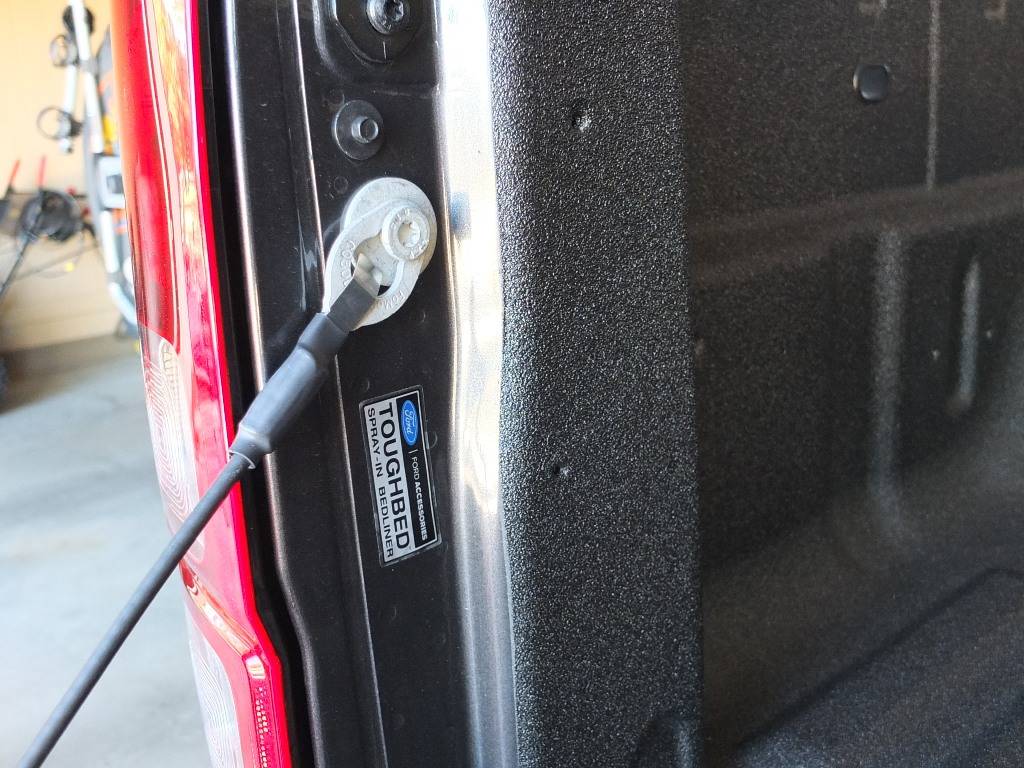

What is the primary use of the bed of your truck?
I had a 17 year run with our last truck ('02 Tacoma) and it had a factory drop in bed liner.
For the last 18 months we've had the Ford ToughBed that's applied at the factory on our 2019 Ranger.
There's many a time in that 18 months that I've missed the drop in liner. When you load something in a truck with a spray in bedliner, and that something is in a cardboard box and you slide it, the bed liner rips of the cardboard into shreds. Sure that means it's holding it in place, but I always, and I mean always, secure the load with ratchet straps. I don't need the rough bed liner surface to "secure a load".
Lets say you're hauling mulch or dirt. Piece of cake with the bedliner. Your shovel / fork is hitting the bedliner when you're unloading the mulch. and when you're done it's super easy to sweep the mulch all out of the drop in bedliner. Not true with spray in bedliner. Your metal shovel or mulch fork is rubbing right on the sprayed in bedliner, and it shows. For cleanup it takes a hose or pressure washer to clean up the spray in liner. A big deal, no. A hassle, I think so. Oh, and be sure not to plug up the drains in the front of the bed either.
If your hauling finished lumber, and drag it across the spray in liner, it scars the wood. Not true with a drop in liner.
Folks do say though that Ford drop in bedliners wear the paint off the bed. My Toyota drop in liner didn't do that.
I do like the ease of access to the tie down hooks in the spray lined bed. You have to access the bed tie downs through holes in a drop in liner... kind of a hassle. And the holes on a Ford drop in bed liner are down low, and if you don't keep the covers on those holes, you'll get debris under the bedliner... not good.
Bloody knuckles is another disadvantage of the spray in liner... but a pair of gloves solves that issue.
Opinions vary... but that's been my real world experiences.
Happy Trails...
