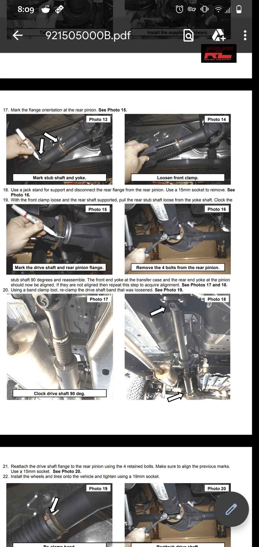

I work at a Ford Dealer as well. This picture from rough country is what I have seen done for lifted Rangers.
Edit: now that I think about it there may be 4 blocking splines only allowing movement in 90 degree increments. I never looked close enough.
Interesting. Thanks for posting this. I found the full PDF for this and upon closer inspection it does look like the shaft is all lined up after clocking it by 90.
If you look at Pg 20 in the PDF Drivesfaft clocking. You can also get a band clamp tool off Amazon for about $27 to tighten the front clamp back down. So this may be something worth looking into doing if it fixes the vibration/driveshaft phasing issue.
The funny thing about these instructions is it makes the center an rear u-joint out from each other by 90°. I'm no expert but i can say that will just make the vibration worse.
It's definitely a funky design but the one lifted one I've driven didn't shake and his driveline was clocked in this way. If I see it again I'll measure working angles, take pictures and see what's going on.

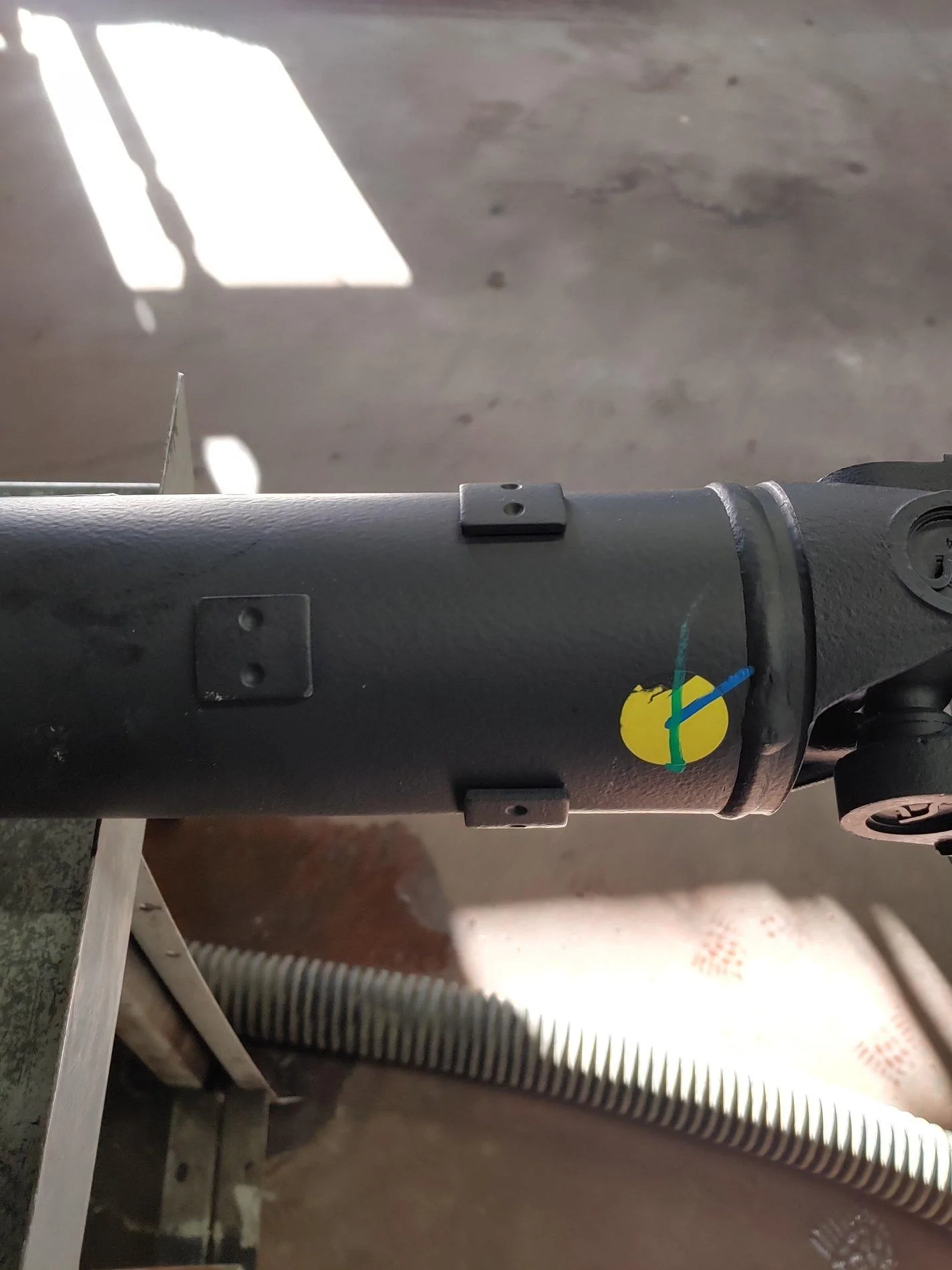

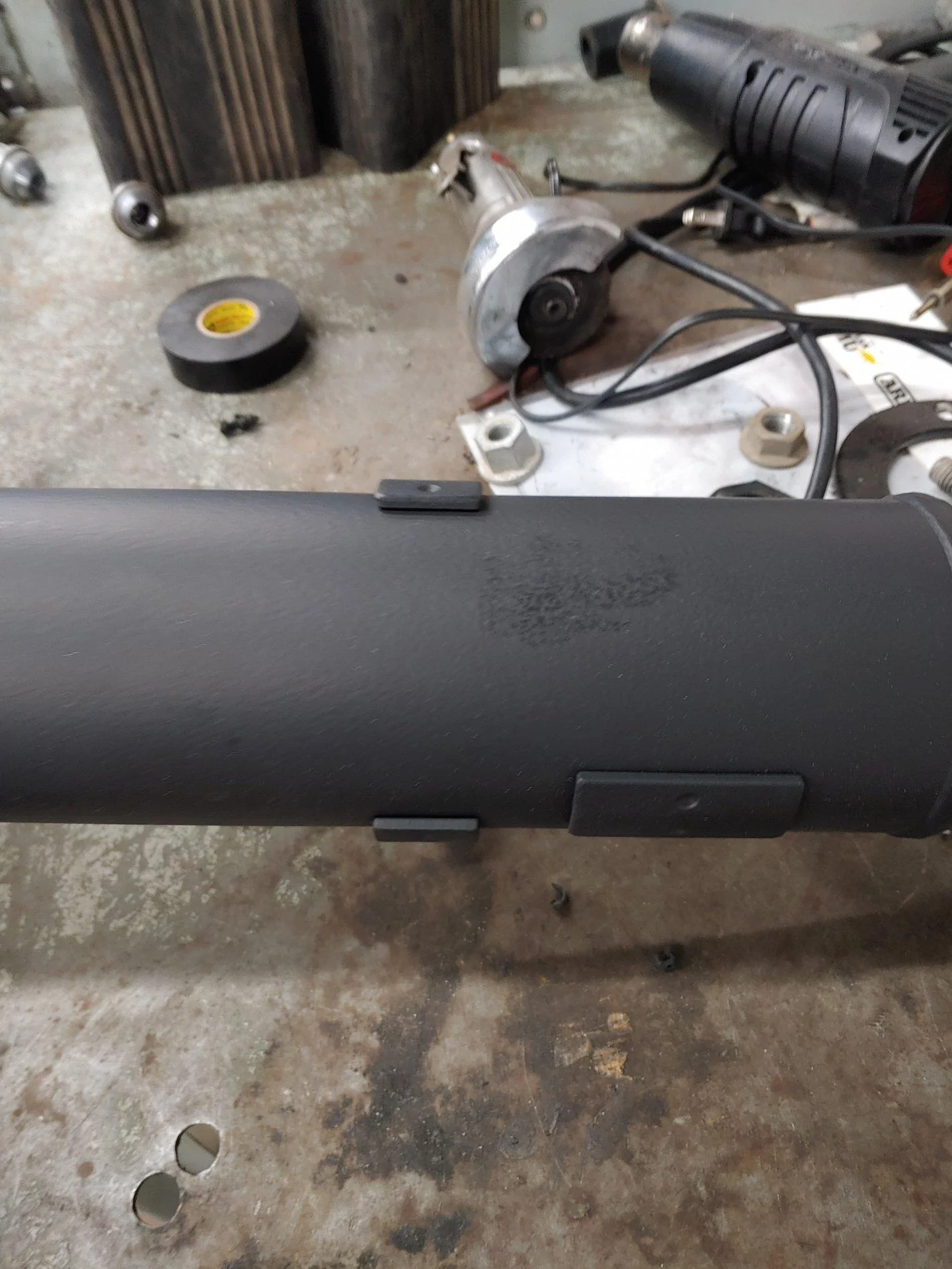

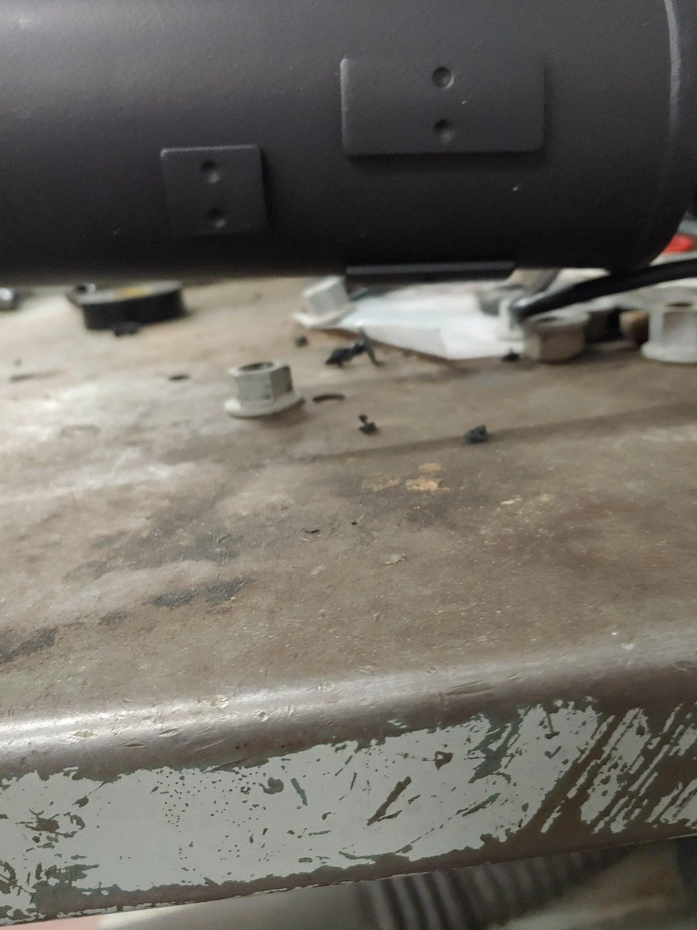

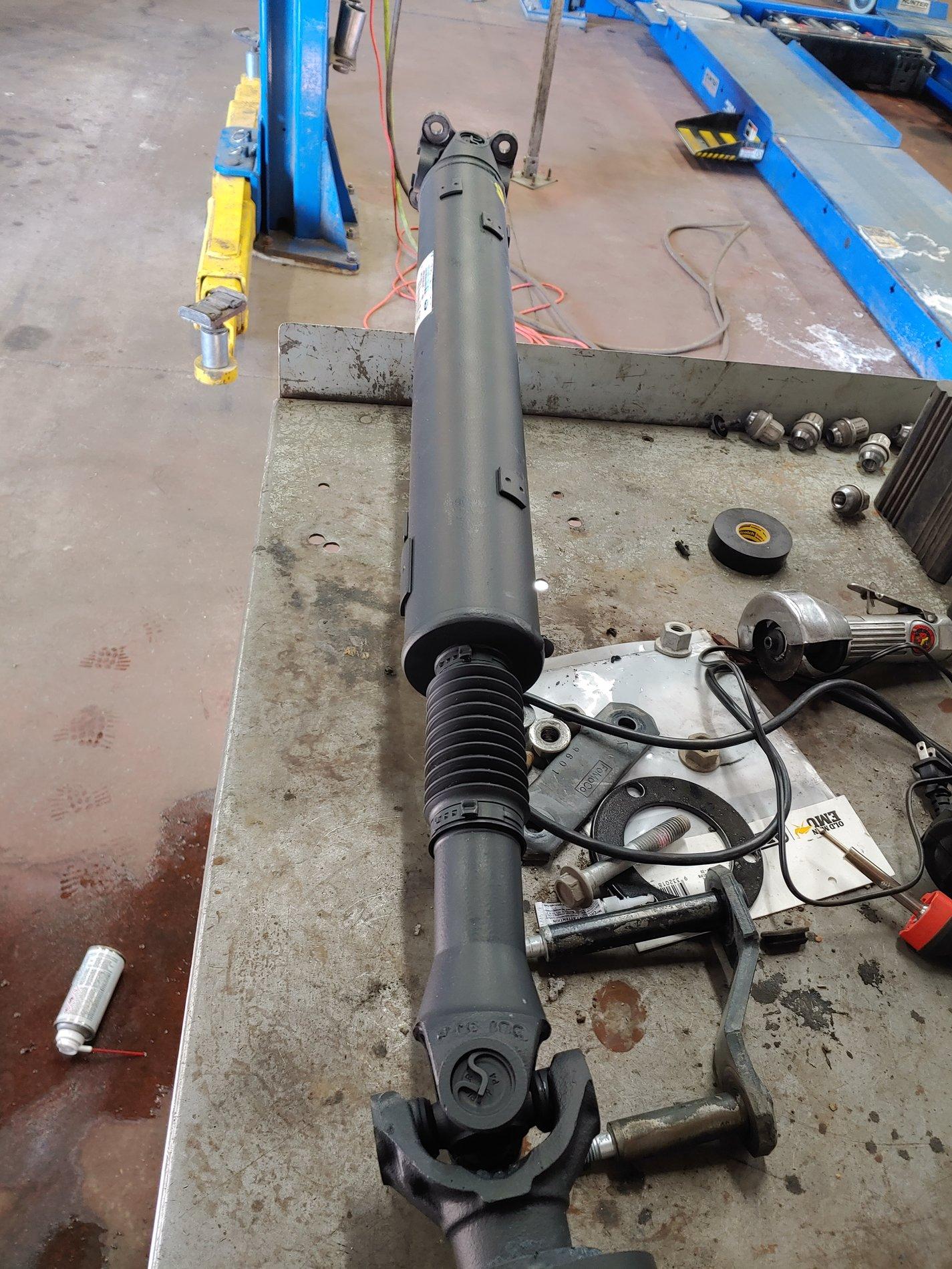

Soooooo.......... I orderex a new driveshaft for my truck and i took a good look at it this morning since it just got here. I'll let you guys look and see what you think........... I'm sure i know what the response will be......
Lunchbox88
Logan
Jun 21, 2019
303
Missouri, USA
2019 Ranger SuperCrew FX4
Judging from the pictures, it seems the U-joints are still clocked slightly off. They certainly went through balancing it based on all of the weights. Guess thats just how these get manufactured.
Frenchy
Mar 15, 2020
169
7,725
11,034
Elizabeth, Colorado
Field Service Technician
