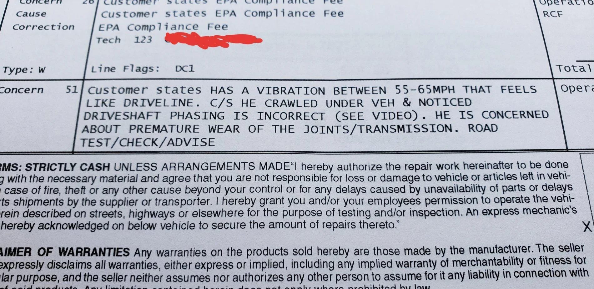

So I looked at my driveshaft today and it is also about a tooth or two out of phase. I will be contacting Ford about this since I have hotline access. One of the techs i work with said dont respline it since it already considered "balanced". Hopefully we can get good results like new correcly balanced and phased driveshafts.
Let us know what is said please.

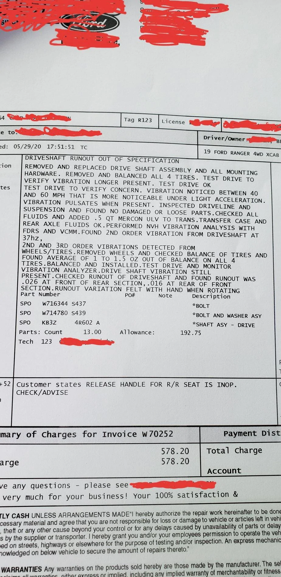

Just got it back yesterday evening. They replaced the driveshaft and balanced the tires. Haven't gotten to drive on the highway enough yet to verify it's fixed. I also haven't crawled under the truck to look at the phasing.
Just from reading that report it sounds like they didn't fix the problem.
7,085
37,253
Agreed....
Hi Ben,
Not sure of the amplitude but 2nd order driveshaft of 37hz is roughly 1100 rpm of the driveshaft but not knowing what gear, gives just a rough approximation of the engine RPM of around 900 to 1000...
Does not appear to be fixed, but maybe minimized....
