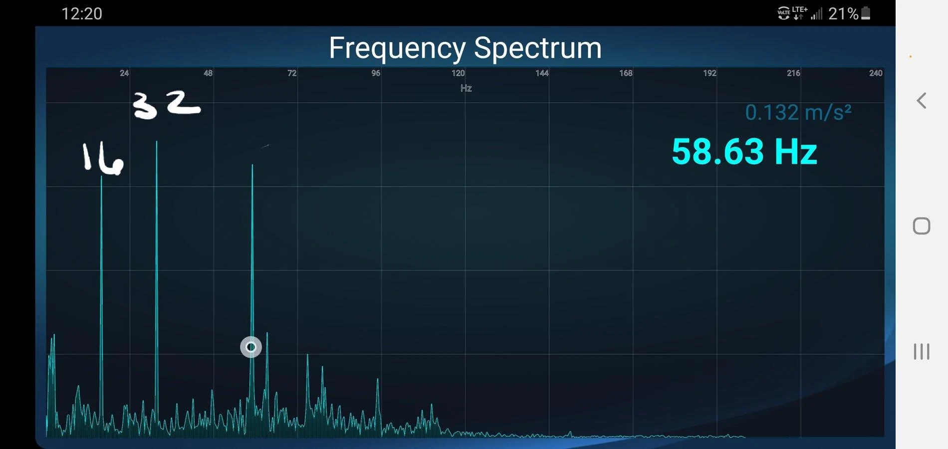

I'm using an app called myFrequency. It's on the Google Play store $9.95
Dan
Today I remeasured vibration frequencies again without the phone case. I seem to get better coupling to the truck without the case. in the attached graph you can see I'm getting spikes at frequencies of 16, 32 and 59 Hz. Measurements were taken at 85 mph. The 16 Hertz is the tire rotation speed. The 32 Hz signal is twice rotation speed which I assume is tire/wheel balance related (any suggestions)? There's also a spike approximately 59 Hz which corresponds to drive shaft rotation speed (16*3.73).

Hi Dan,
Not knowing the scale in the frequency domain as you show, I think the 16 hz first order is wheel balance...The second order is likely Ovality of the tires and the two are related such that force balance should reduce both. The driveline frequency could be driveshaft balance or driveline system. Try loosening the center bearing and retightening, but this can be induced by the tire imbalance. Once force balance, rerun placing the phone in the same exact position. Amazing that what I had to use with $10,000 of equipment and pricey cables and accelerometers can now be done with a smart phone! If it had the ability to use an instrumented impact hammer and accelerometer on the place where the phone was placed it would show the natural frequency of the systems as additional data. love it when the math shows the exact axle ratio, eh? Likely the background is what we called road hash...
What I cannot tell is the excitation source. Is it tire/wheel or driveline or both, however a rerun after force balance will likely be more telling on the systems sensitivity.
BTW...where is the phone placed to detect the vibration? We used the seat track, the steering column and the dash panel. Also throught a B&K microphone, sound analysis at what we called Driver's Right Ear.

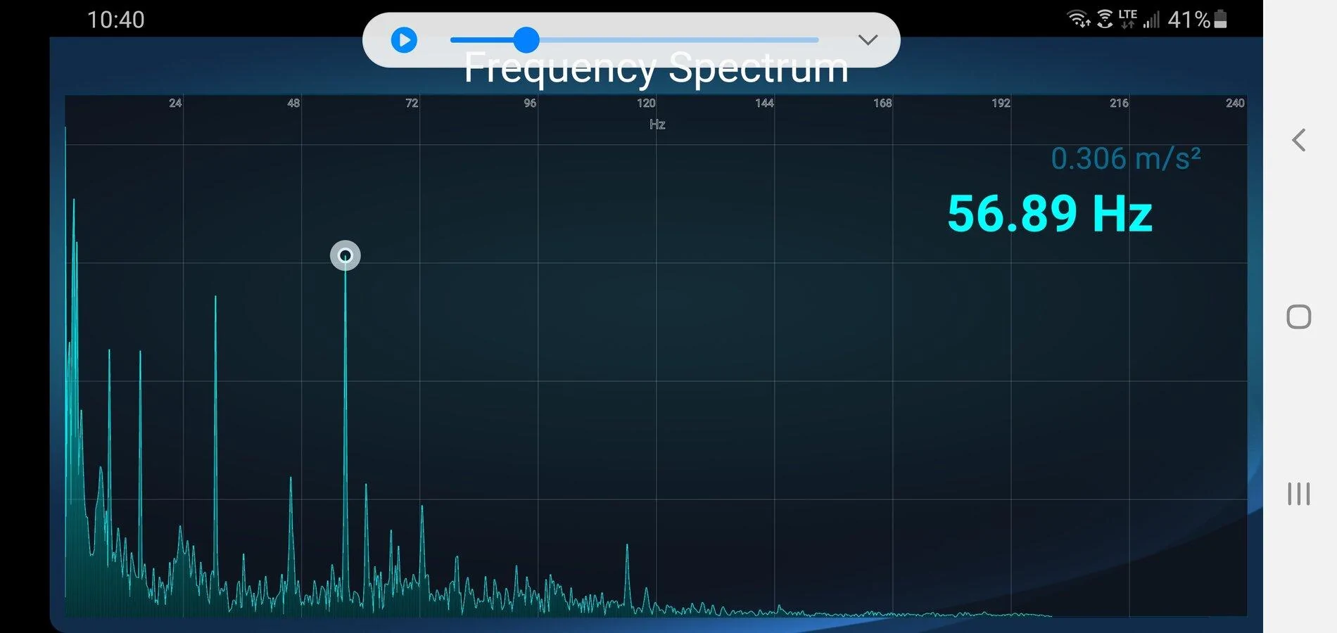

Had road force balancing done today. STILL getting bad vibration at 85. I reran the test with my phone. The 16 and 32 Hz signals do appear to be lower but the driveshaft frequency still seems to be very prominent. I put the curser at the peak of the 56.89 Hz signal where you can see the magnitude in the upper right hand corner of the screen. As far as phone placement is concerned, I was putting it flat on the center console right behind the shift lever. I have a Galaxy Note 10 plus so it sits fairly wide and flat against that surface.
Not happy I can still scramble eggs at 85 mph. ?

Hi Dan,
If you want to try to fix this yourself...try this:
There is a service trick that can be done too. Put two hose clamps around the rear driveshaft with both heads of the clamps side by side. Drive the vehicle. If worse, clock the pair around the shaft until you feel the imbalance is the lease. Then mark that spot and clock the heads of the clamps in opposite directions equal distance from the mark. Again evaluate. keep clocking in this same manor until the vibration is gone. If this equal clocking makes it worse, you need more weight and add another pair of hose clamps and repeat the equal distance from the mark clocking and see if that helps. I have used this trick before with pretty good results on shafts that clearly show a balance weight was thrown.
