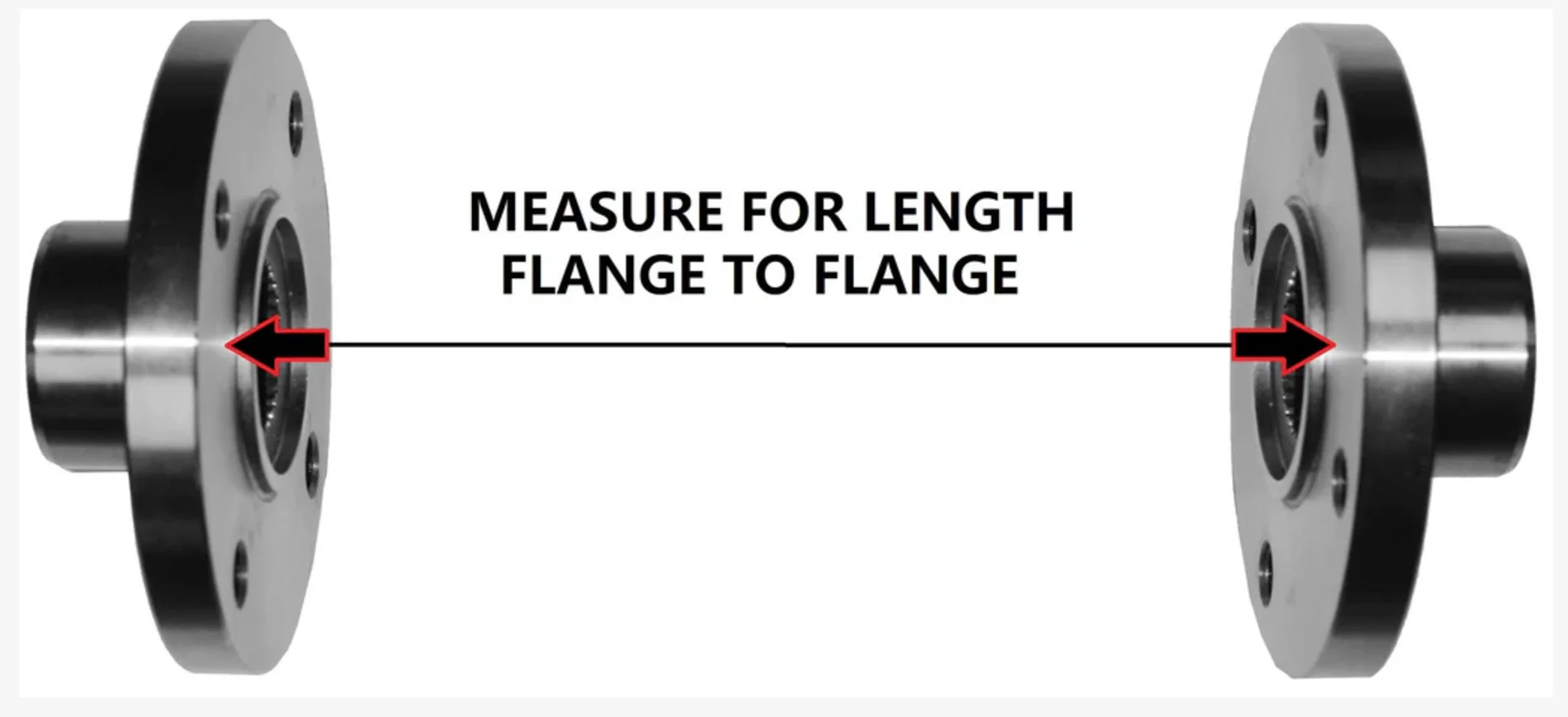

How do I measure the driveshaft to purchase one ? Thank You in advance !
The purchase page has instructions on how to do this: https://4xshaft.com/collections/ford-products/products/5th-generation-ford-ranger-rear-drive-shaft but essentially you crawl under the truck with measuring tape and measure from flange to flange. When I measured, it was 66 3/4" from end to end, and a measurement in that ballpark range is normal according to reports here on the forum. Here is the image they give you to reference the measurement:

Thank You so much. I have a 2019 Supercrew FX4 Off Road
