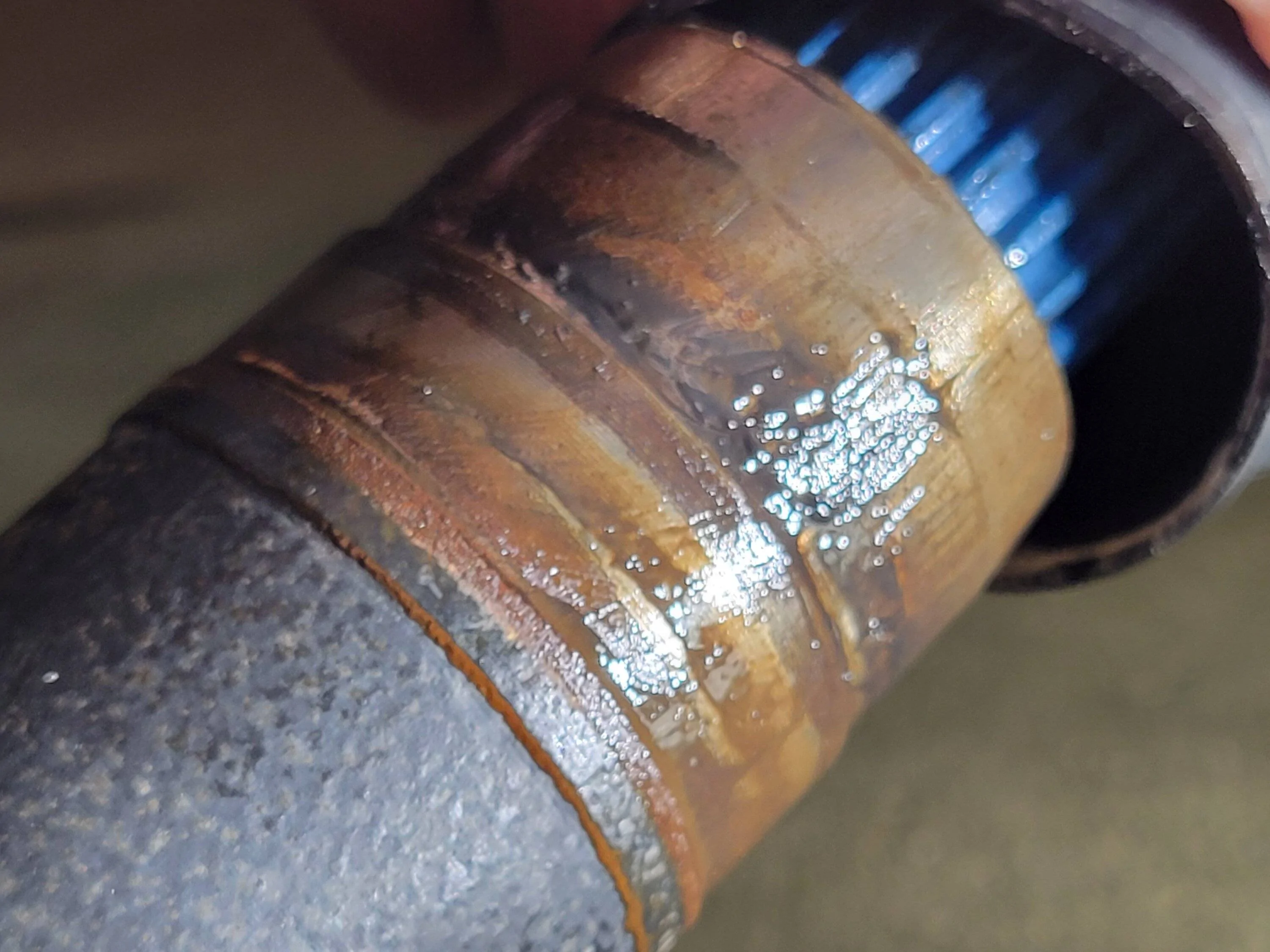

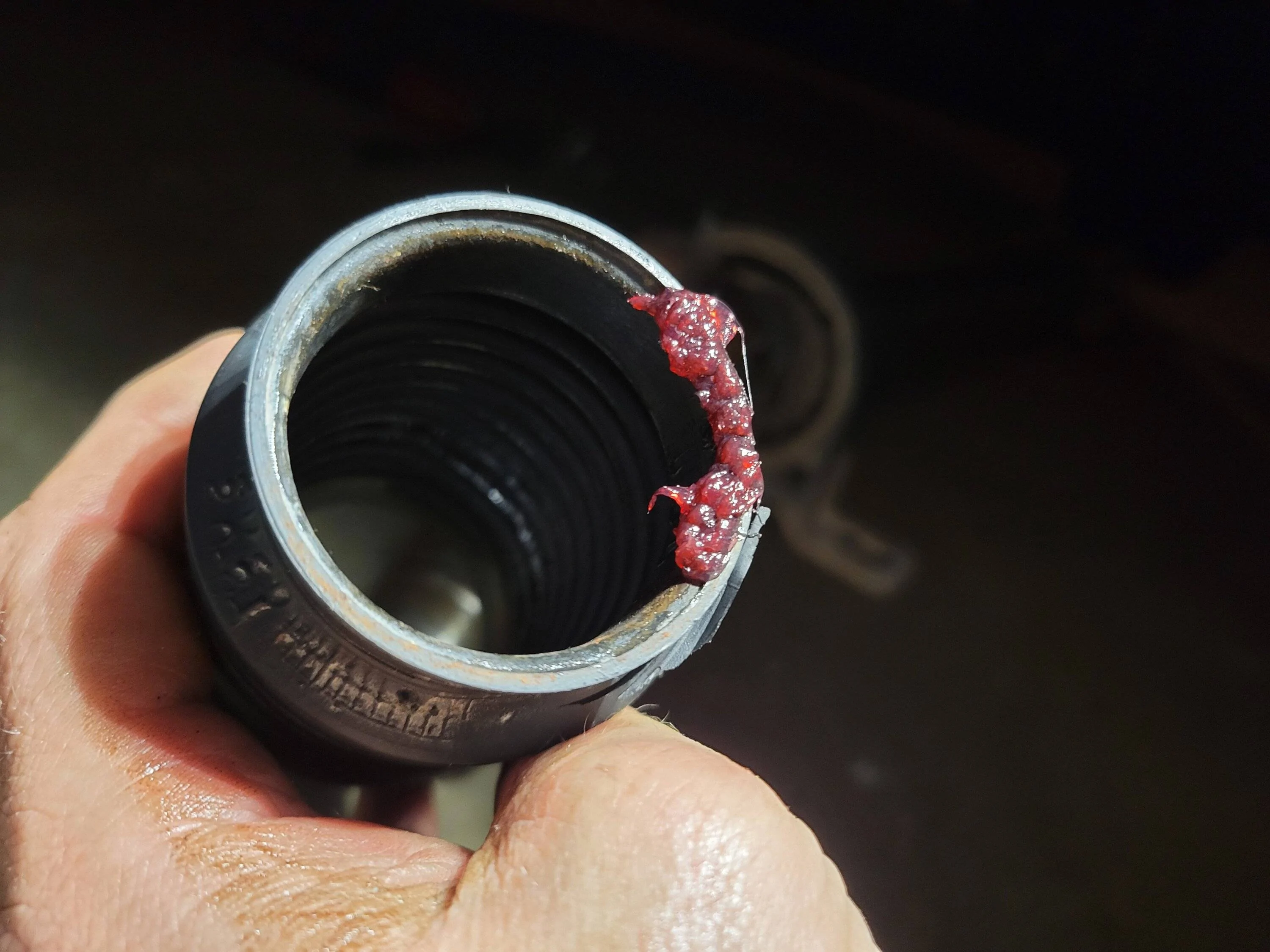

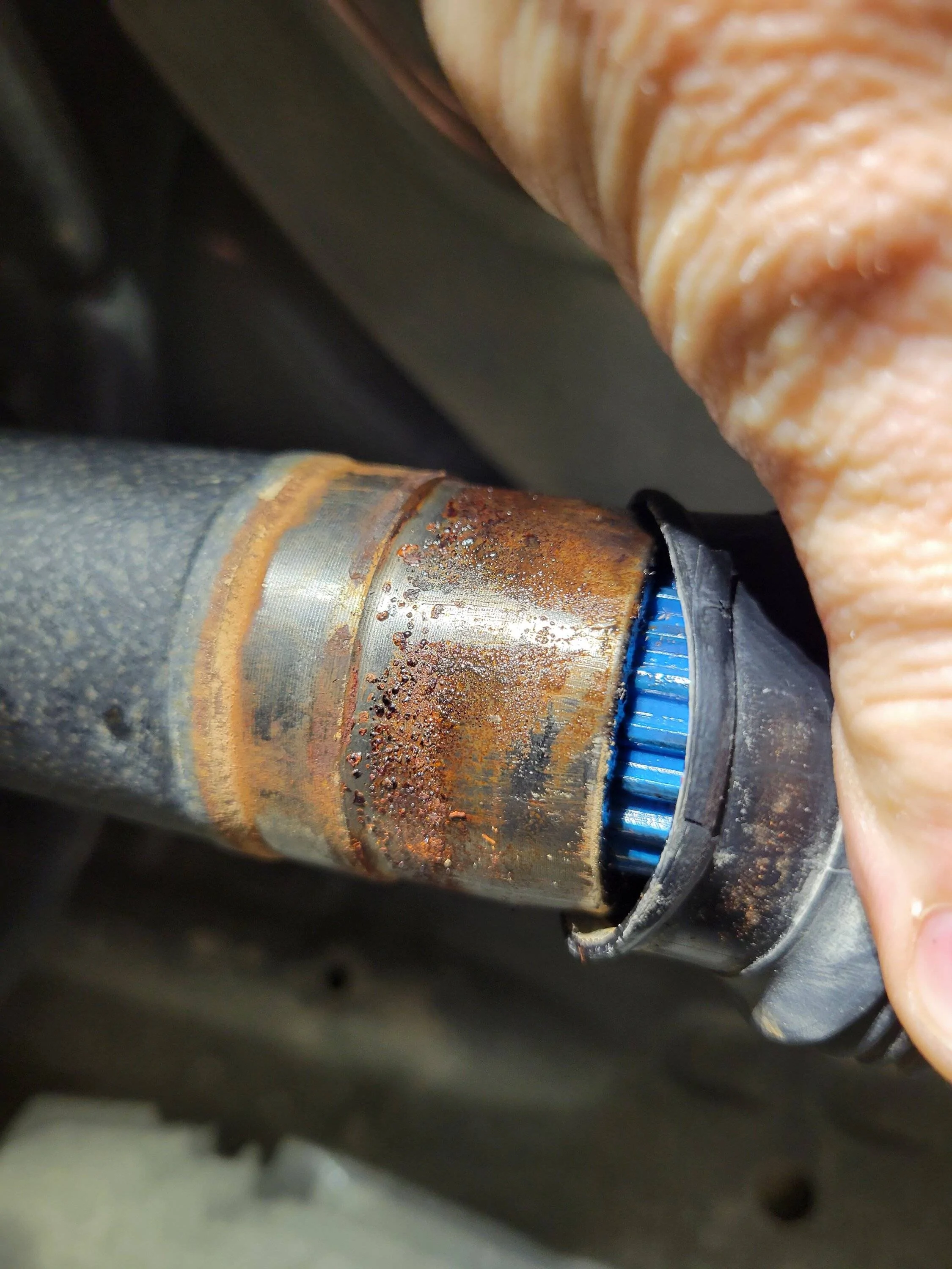

Seems many folks here are overthinking this a bit. If you're not a hack, you can simply pull the front four diff bolts, drop the center carrier bearing, carefully pry open the clamps then slide the front half of the shaft out. No need to touch the rear bolts at all. Clean the yoke and splines, grease it up with Ford TPFE and reassemble using the original boot and clamps. No need to use a whole tube of TPFE either..it will simply reject any more than the tolerances between the splines. Also, no need to mark the shafts either as they are keyed and can only go back one way. The shaft is not balanced on the car, so there is no mating at the front diff either. It's really a simple fix.
Now...if you're not careful and you trash the boot or clamps, well then you will need to replace them.
Like others the front clamp was loose on mine and I believe water was getting inside...take a look and tell me what you think....wtf???... there was also a tiny little bit of red grease (see pic) that had been squeezed out and mostly liquified.. smelled like rear gear dope to me.
This did solve my growing clunk on start and stop...hoping by some miracle it would do something for the vibration, but NO. Same crap their.

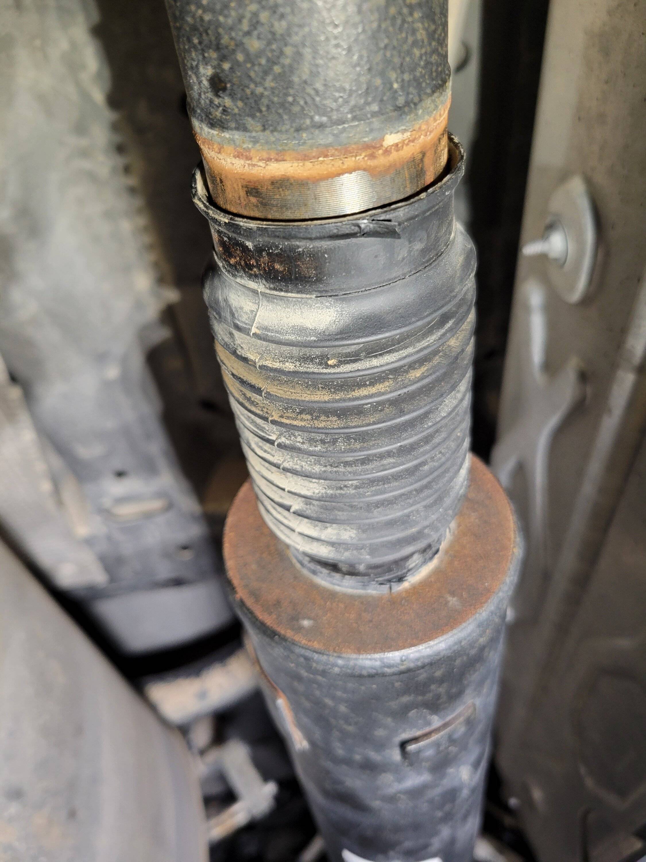

Hi Chris,
Your pictures indicate the rubber boot clamp was not tight and you got water into the slip splines....Not a good scenario...

Here is what I have done in the past on my 96 3/4 t PU. I put a zerk fitting in the slip housing. Then I put a little sealer on the old rubber and used two heavy duty zip ties to hold in place. Still there years later.
