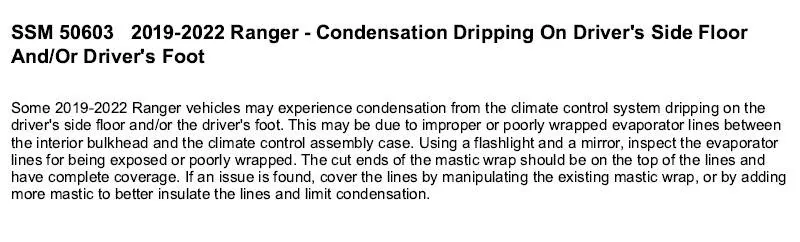

Possibly This:

Possibly This:

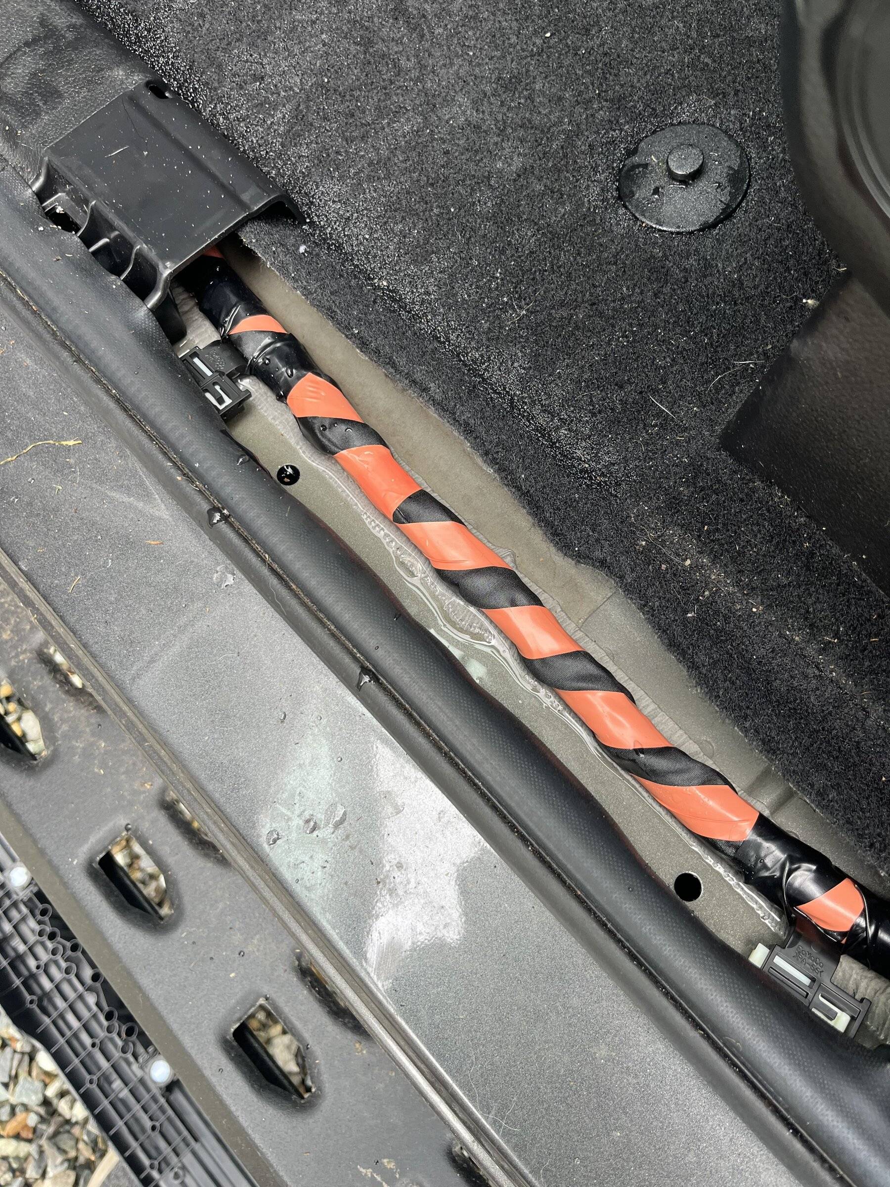

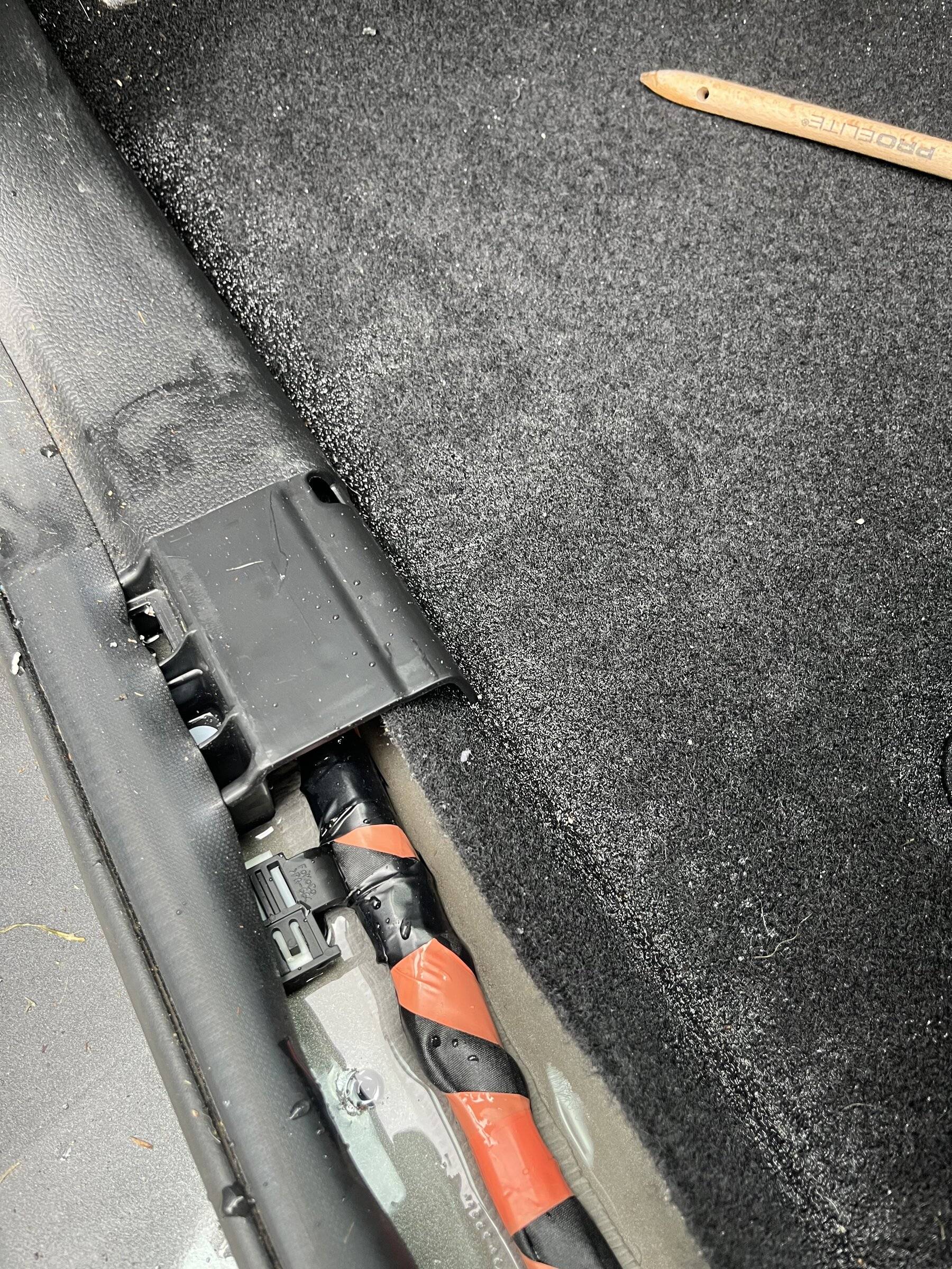

So I found that it is my ac dripping into the floorboard. Coming down from behind the center hump on the driver's side. I drove for roughly 30 minutes with the AC on max and the floor was soaked. I pulled up the carpet tried it out Randy AC again and literally watched it run down the side of that hump. Are there any easy fixes that you know of besides dropping the tranny to get to the drain plug and adding an extension like I saw in a video?
