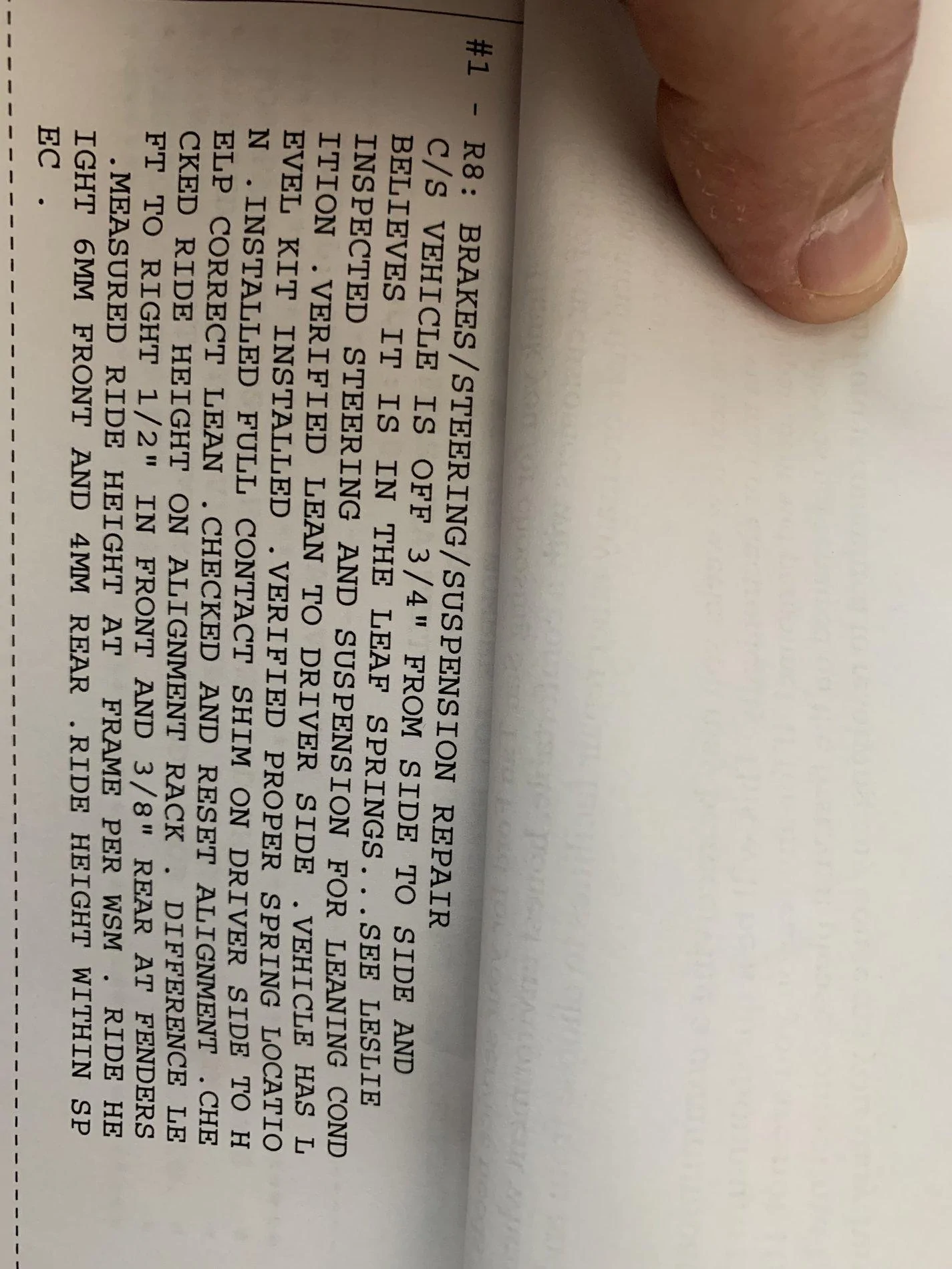

SOLVED: Driver Side Frame 1/2 Lower, Shim Added to Rear Leaf Spring

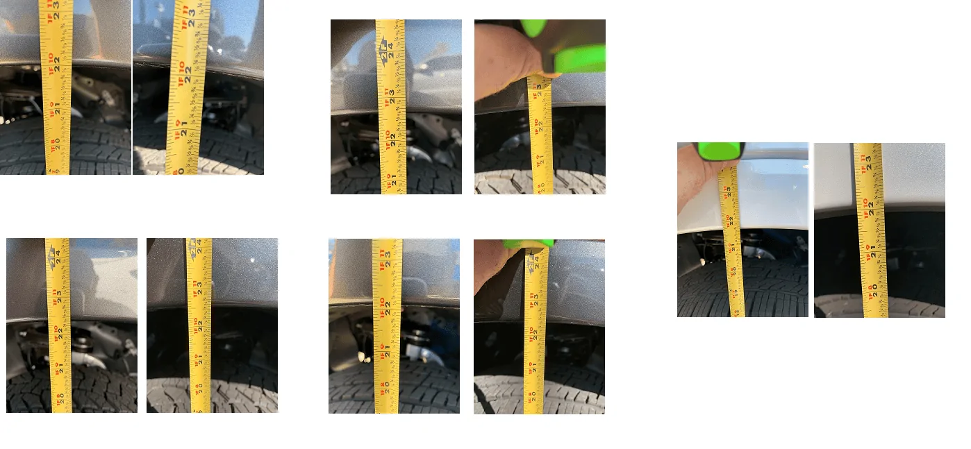

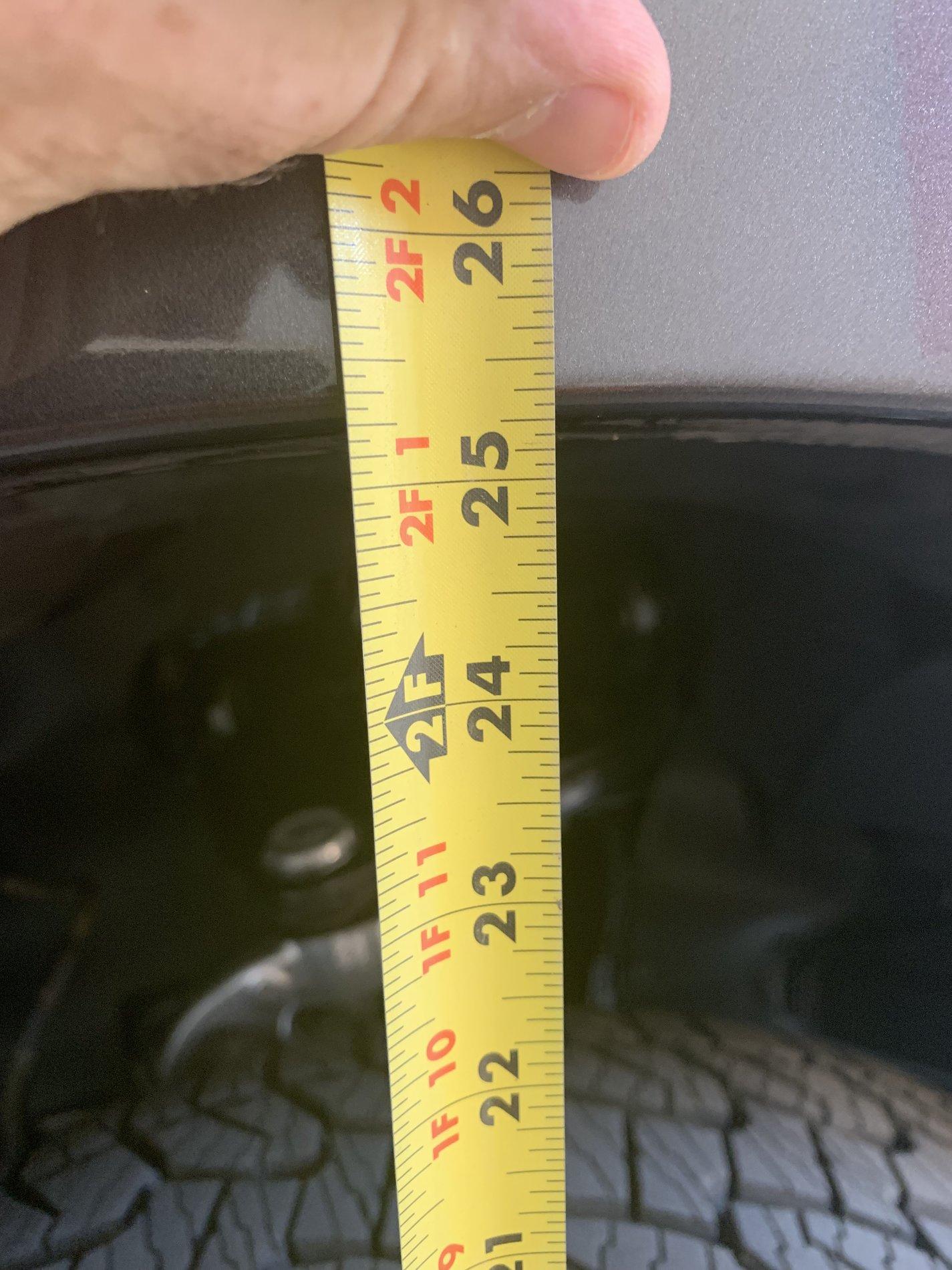

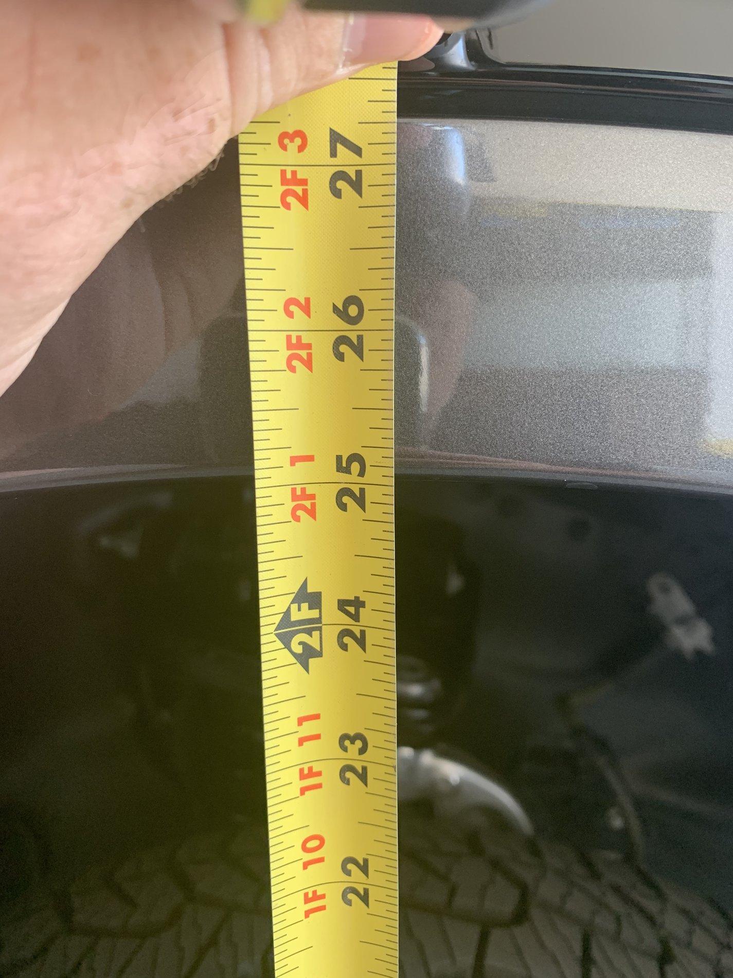

I went and measured a few at the dealership.. I measured these from the center of the wheel to the top of the fender.. They all seem to be "in spec" for the most part.. Not nearly as bad as mine..

Show the Ford rep the pictures.

The loaner is level! I’m going to measure the leafs lol...
Hi Gavin,
Further evidence that there is a problem with your truck... Did you ever count the leaves in both springs? I cannot believe the left spring is sagging so much unless a leaf was inadvertently deleted... Good Luck!

The suspension shop that did my leveling kit added a few spacers to drivers side front too..
