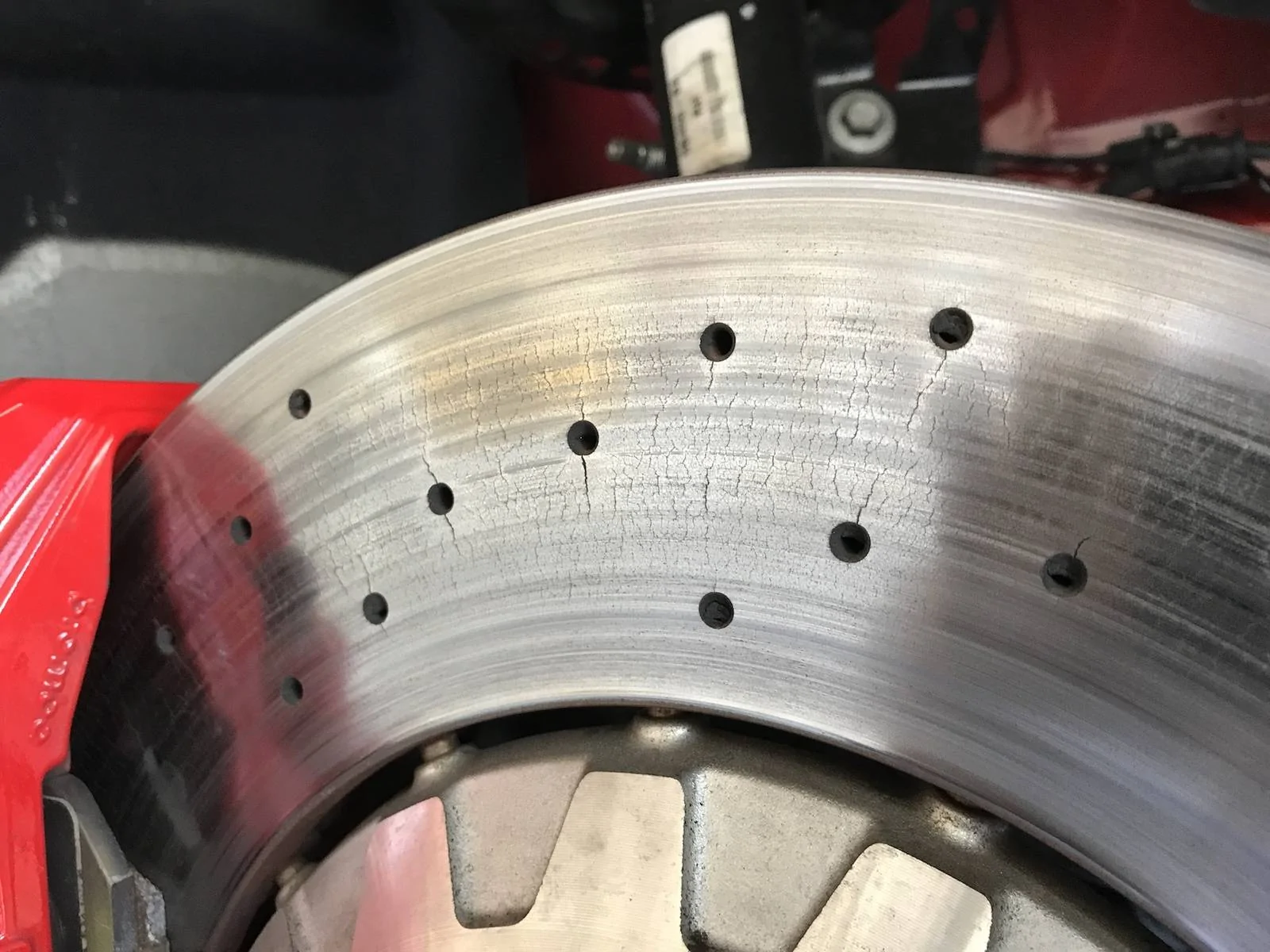

Let's think critically here for a second. Brakes are a HUGE safety component of a vehicle. Drilled rotors have been around since the 60's. So the question is why has the large majority of the automotive industry been ignoring this drilled/slotted rotor techonlogy for the past 6+ decades if they indeed provide a benefit over normal blank rotors and thus could provide a greater factor of safety for vehicles? Why aren't truck manufacturers incorporating these rotors into their heavy duty trucks that have 10's of thousands of pounds of towing capability if they are indeed superior?
Funny enough Ford put cross drilled rotors on their brand new "track ready" GT350R Mustang. And when a few guys actually took their "track ready" sports car to the track guess what they found out..........
......... Those fancy drilled rotors on their $70K "track ready sports car...... CRACK
It was enough of an issue that Ford stopped using the cross drilled the rotors in 2019 and started shipping the 350r with regular blank faced rotors. Who would've thunk:facepalm:

Poster said 12 hours of track time 4000 street miles.

Never had an issue with oem drilled slotted / rotors that came with the porsche sport package or corvette z51 package. Also have never had issues with quality aftermarket 2 piece drilled slotted rotors. I've done some track days and high speed events. On high speed events the rotors would actually glow / sizzle. . .With that said did they aid in stopping power vs non slotted drilled rotors? No idea, I think the calipers, race pads, and track tires did most of the work. . .I also don't doubt that cheap, poorly manufactured drilled slotted rotors could have stress cracks due to inferior metal / manufacturing. Same goes for any cheap part. I also don't doubt ford had an issue with drilled rotors on the gt350 and instead of switching manufacturers just omitted them completely. Stuff happens, just like the 2 piece exhaust valves on ls7 corvettes breaking in half and dropping in the cylinders. . . . Imo a daily driven street vehicle will not see enough stress / heat to warp or crack a QUALITY drilled rotor. I also don't think they will be beneficial other than looks. . . .. . In conclusion to my long, drawn-out post, I will be "upgrading" my rotors to drilled and slotted in the future. I will also only be upgrading if / when a company like dba, bear, wilwood, etc. comes out with a set. I even hear good things about autozone gold rotors
