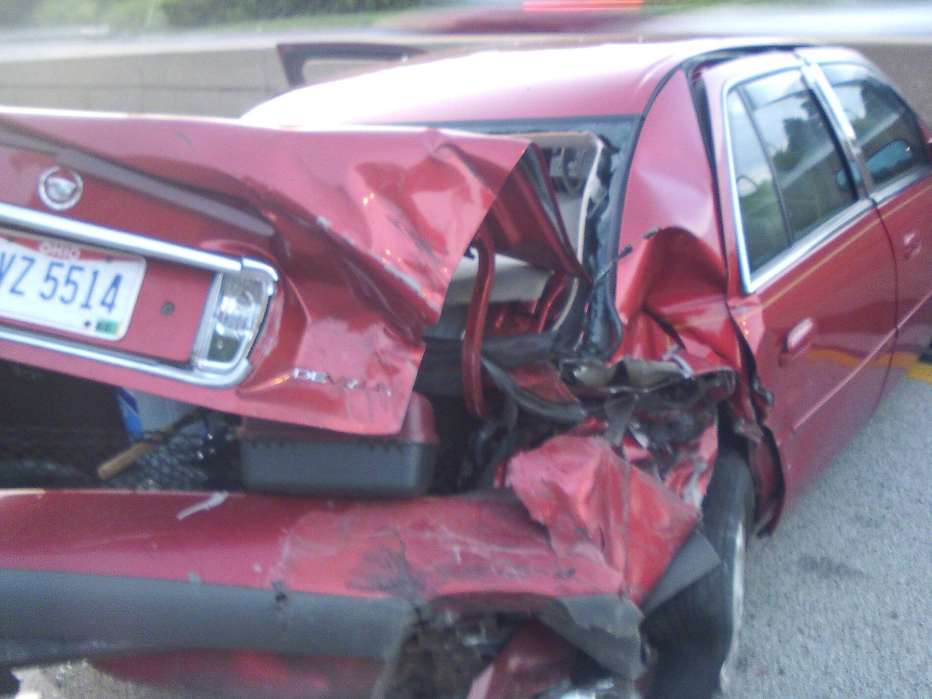

An argument could be made for slotted rotors as they can help remove gas build up that can cause brake fade during repeated or heavy braking conditions.
I went form 80-0MPH no fade and didn't hit the car in front of me. can't say the same about the the car behind me.
My 6500# hearse has slotted up front and drums in the back with no fade downhill. every car I have owned for the last ~20 years have had them and I can tell the difference with the ranger
