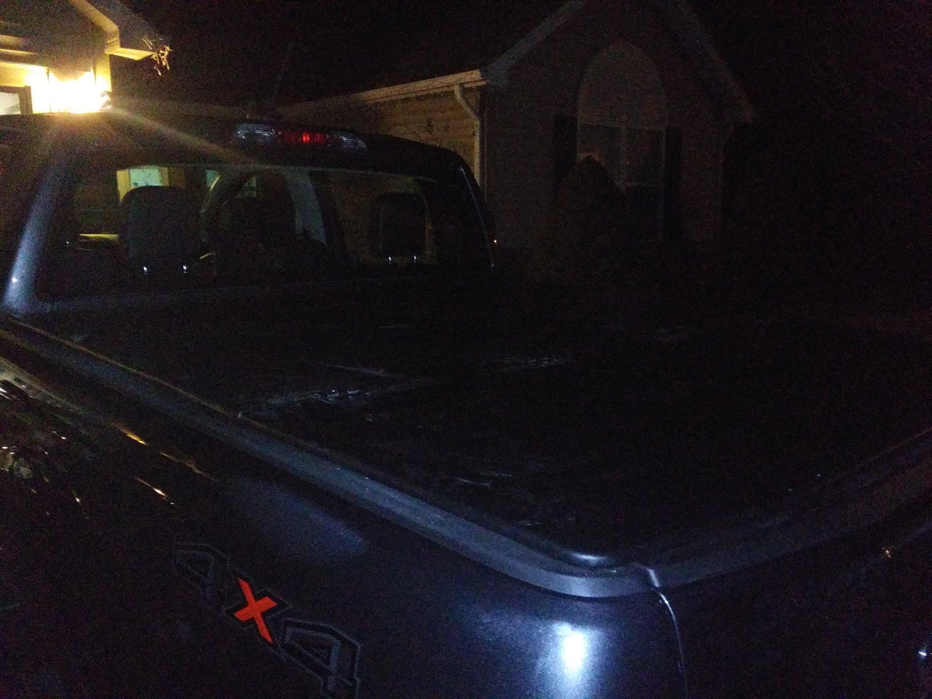

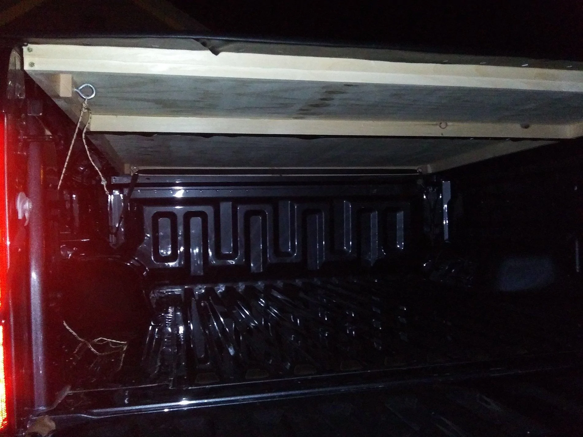

UPDATE:
About 9 months in, and so far so good. I only have the cover on about 25% of the time because usually I prefer the open bed. But when the situation arises that I need the cover, it only takes ~5 minutes for me to get it on and secured.

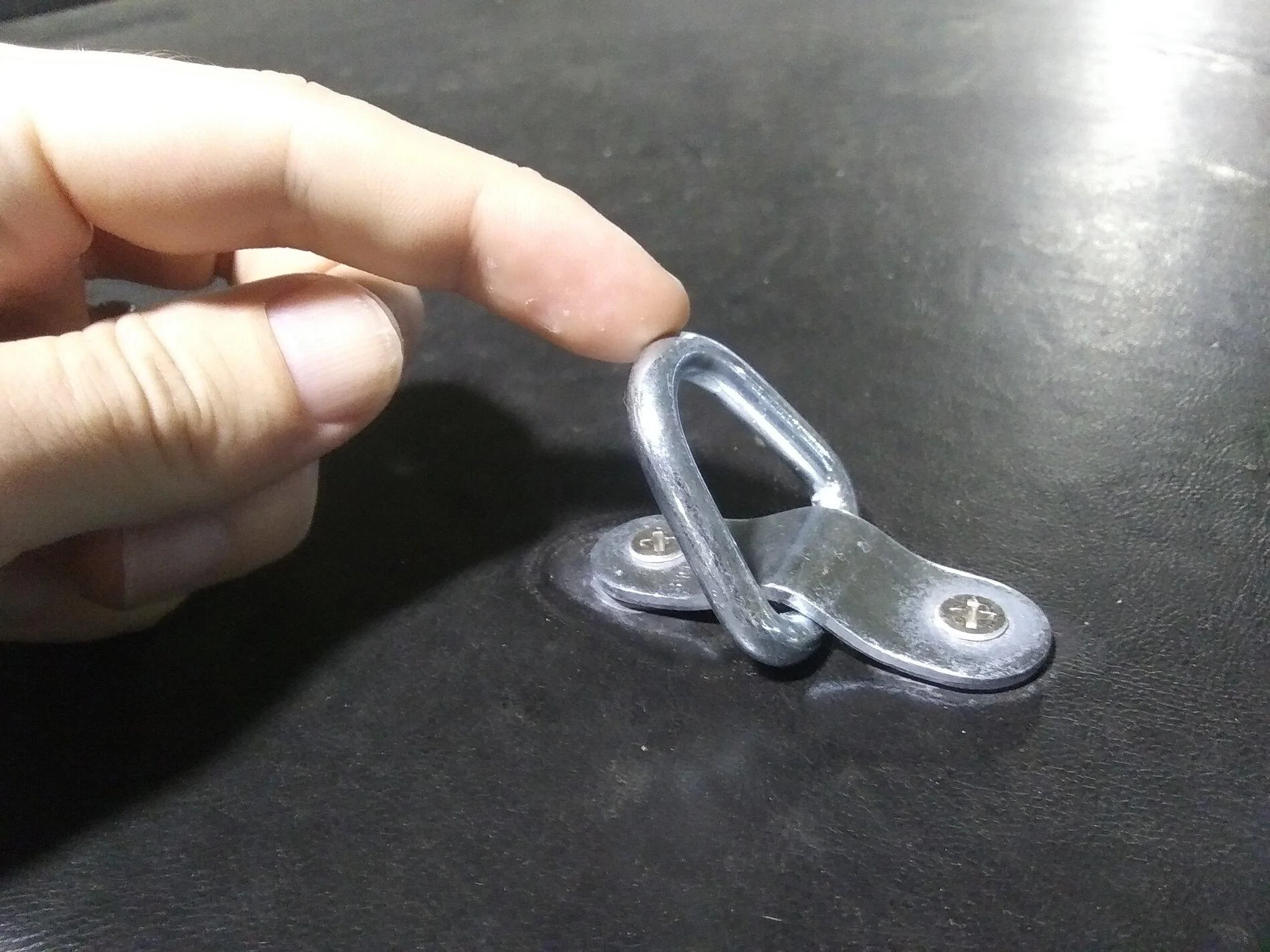

I added some swing-out loops to the top (see picture below). With them, if I have some extra stuff that doesn't need the protection of the cover, I can easily just tie it down on top of the cover. They're screwed in with the screws penetrating down into the cover's frame, so quite secure, and very useful.

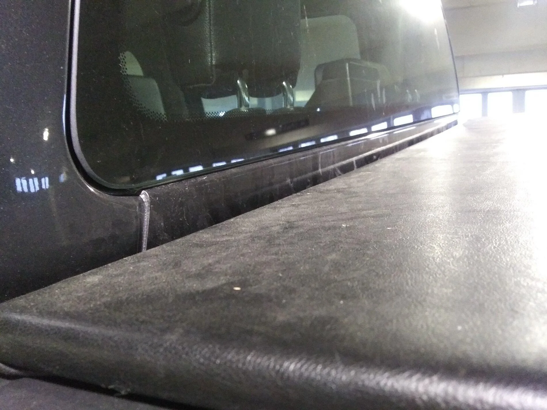

Only drawback so far is that there is a very, very slight sag across the width of the cover (picture below, though it's so slight the sag is hard to see. Yes truck is very dusty. I just got back from a trip.). If you're copying my design, you may want to either use a stiffer wood on the frame cross-pieces, or possibly a little thicker piece of wood.

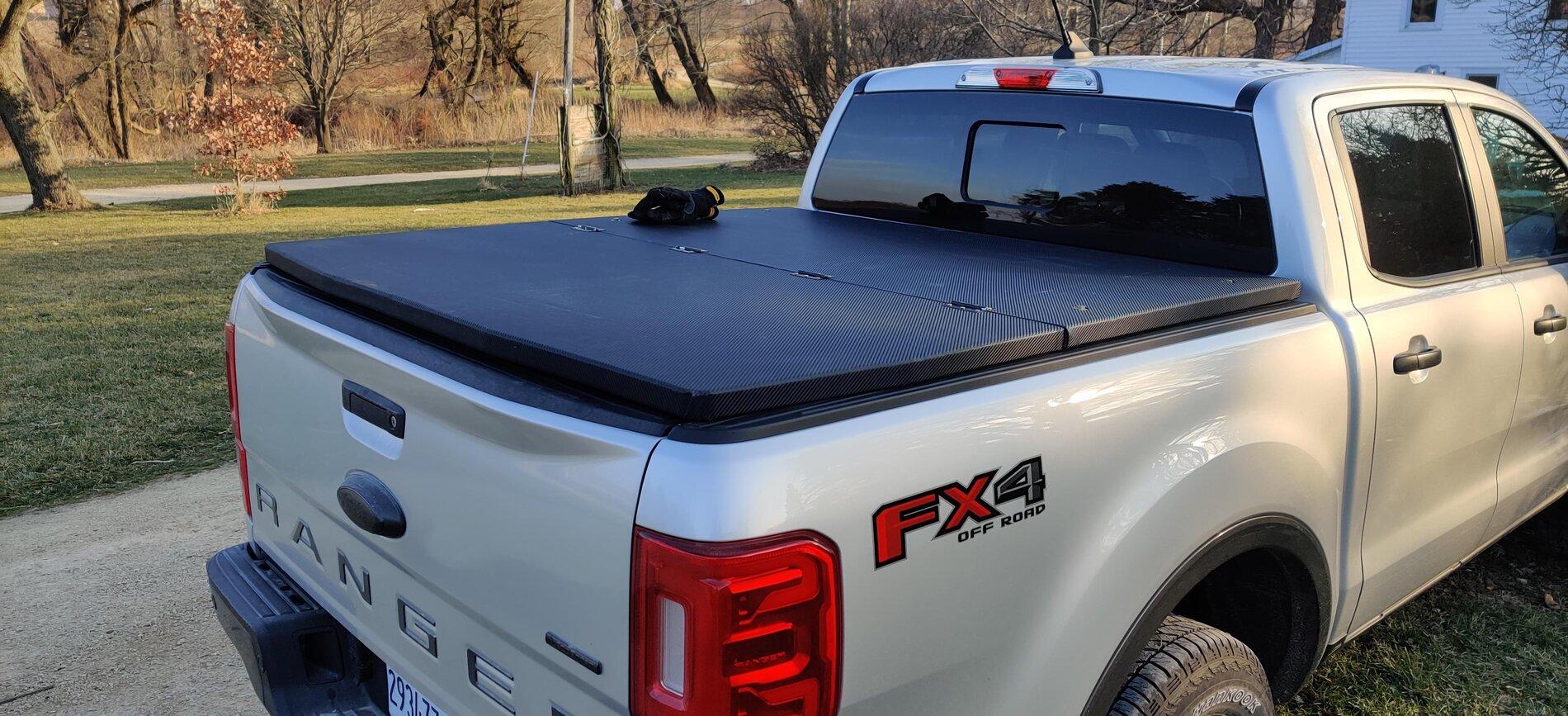

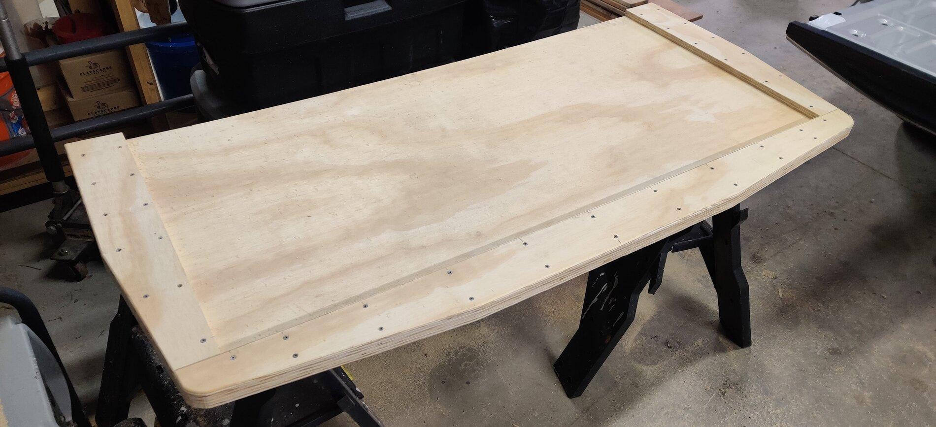

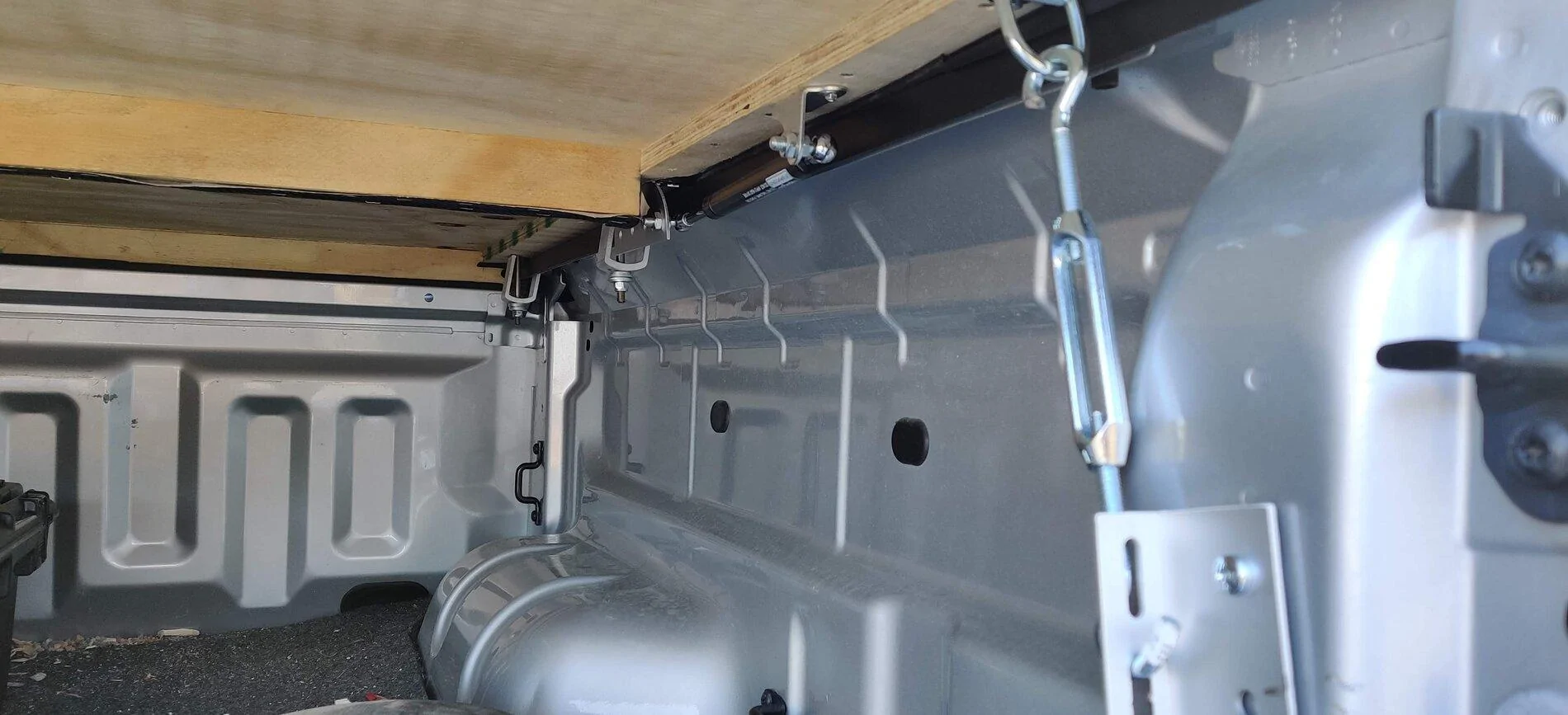

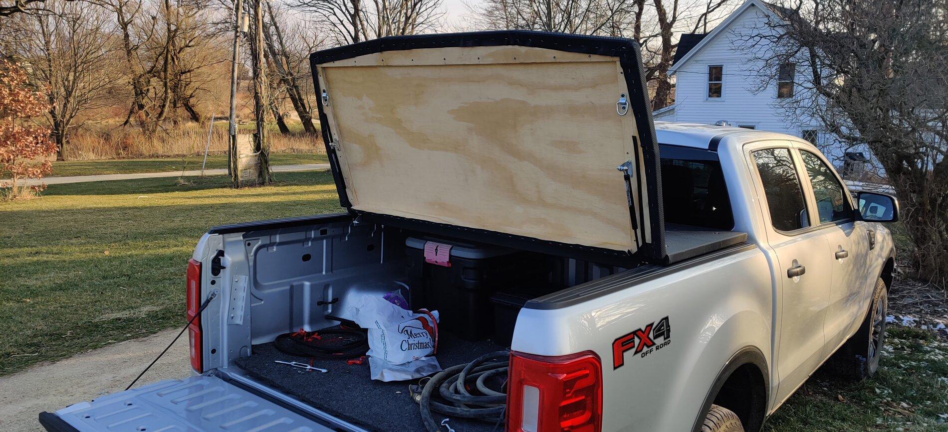

I had a chance to throw something together. I should have taken a few more pictures. I don't like using the turnbuckles to lock the lid but it's what I had and it pulls it tight. I'll figure a locking cam latch or something when it warms back up on the other side of winter.
Costs:
Plywood (already had it but) 2 sheets 3/4" BCX plywood: $82
toolbox clamps: $20
gas struts: $18 (I'd get the 67 lb version if was to do it over, the 45lb version doesn't pull the lid up but holds it)
marine vinyl: $80
3m 77 super adhesive: $10
I put it together about the same as Joe but doubled up the plywood on the edges that cover the bedrails.

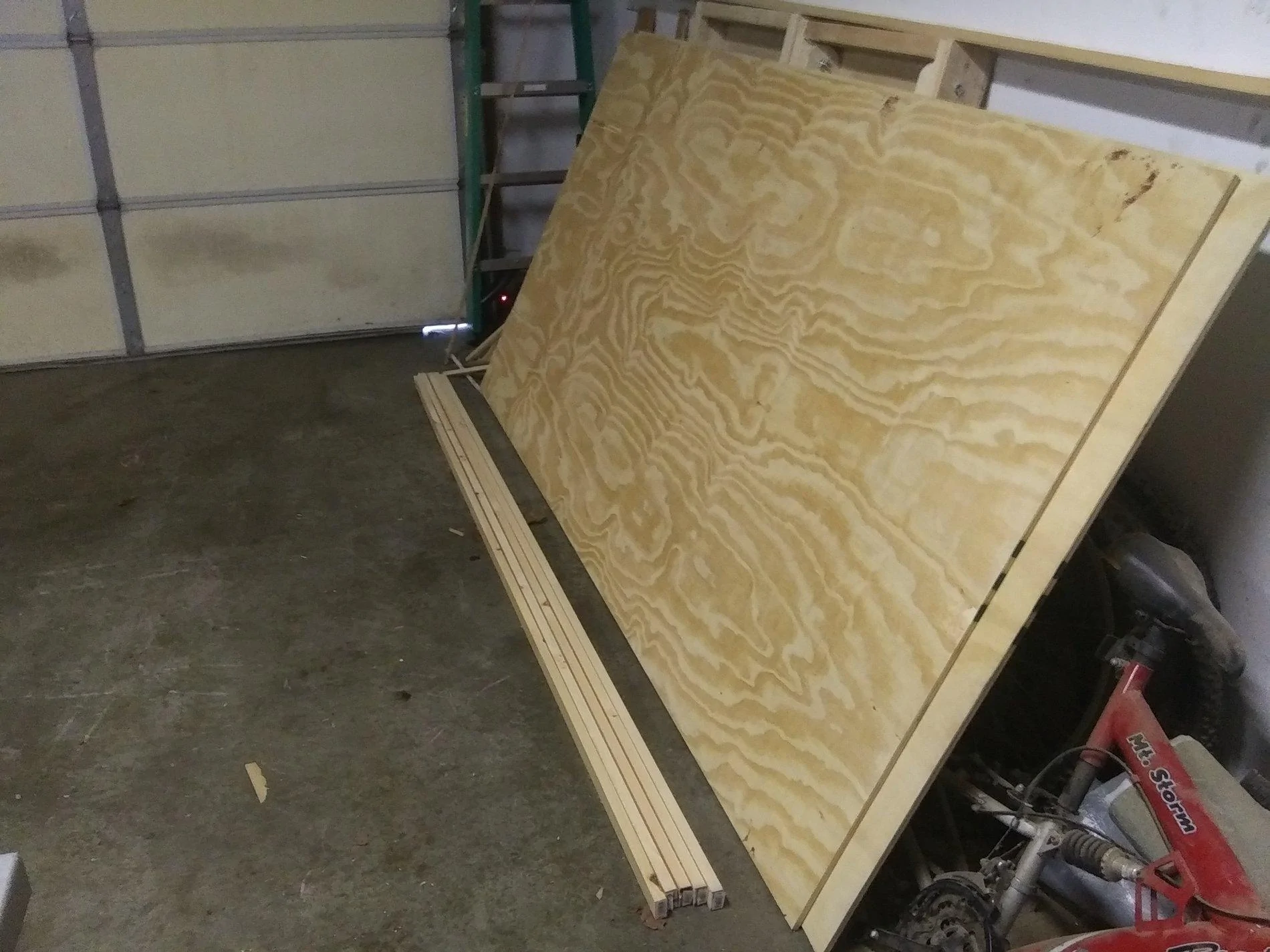

2) Cut plywood to size. Remember the old adage to measure twice and cut once, or else mistakes may happen (I bring this up for no reason in particular). Since I have the 5-ft bed, I did my cover in two sections, with the front section approximately 3 ft long, and the back section about 2 ft long. Note that the plywood will sit on top of bed rails, which narrow toward the back, so size accordingly. Also note that the top of the tailgate is not completely flat, so I cut that section to follow the contours (see picture below)

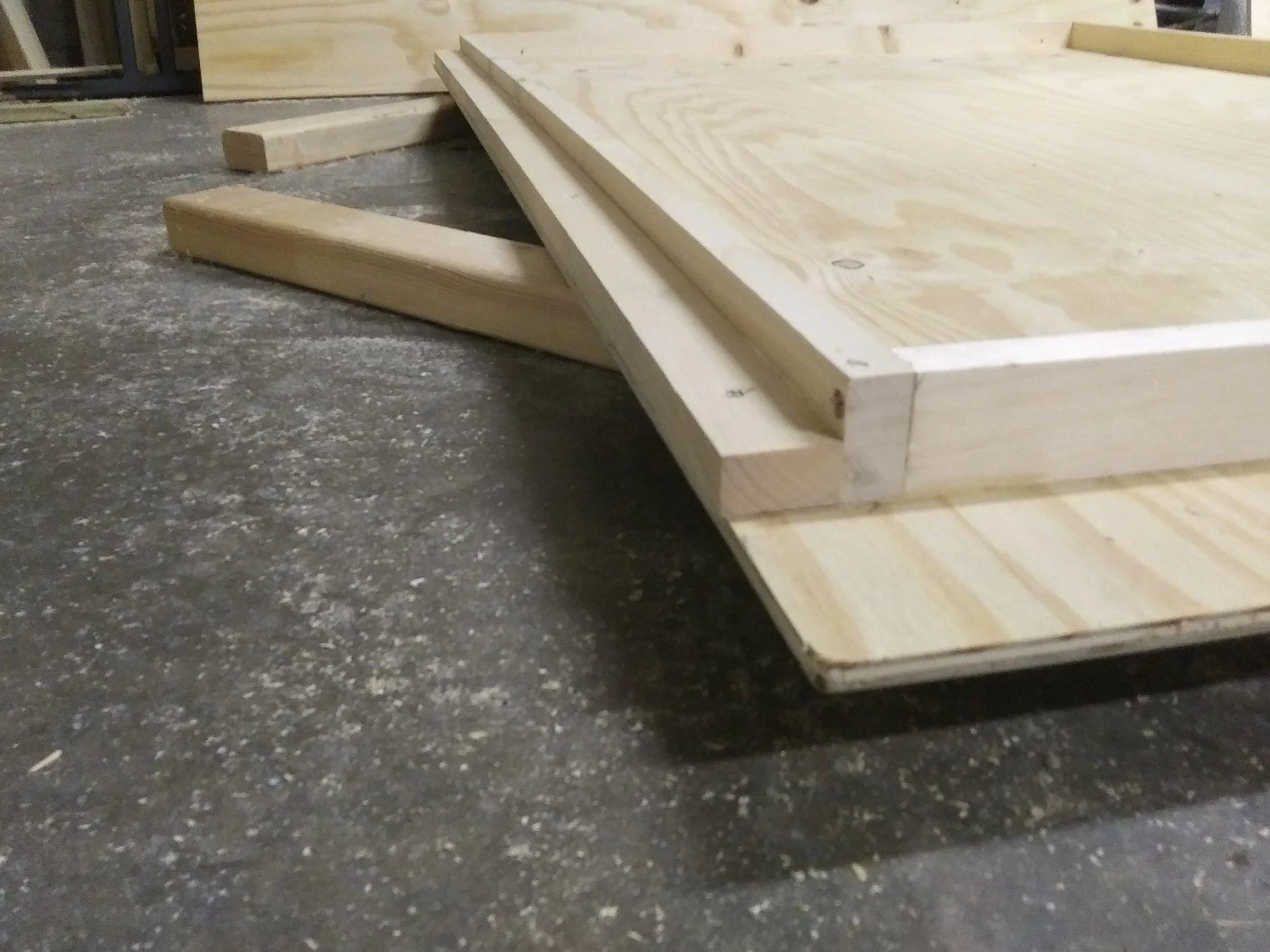

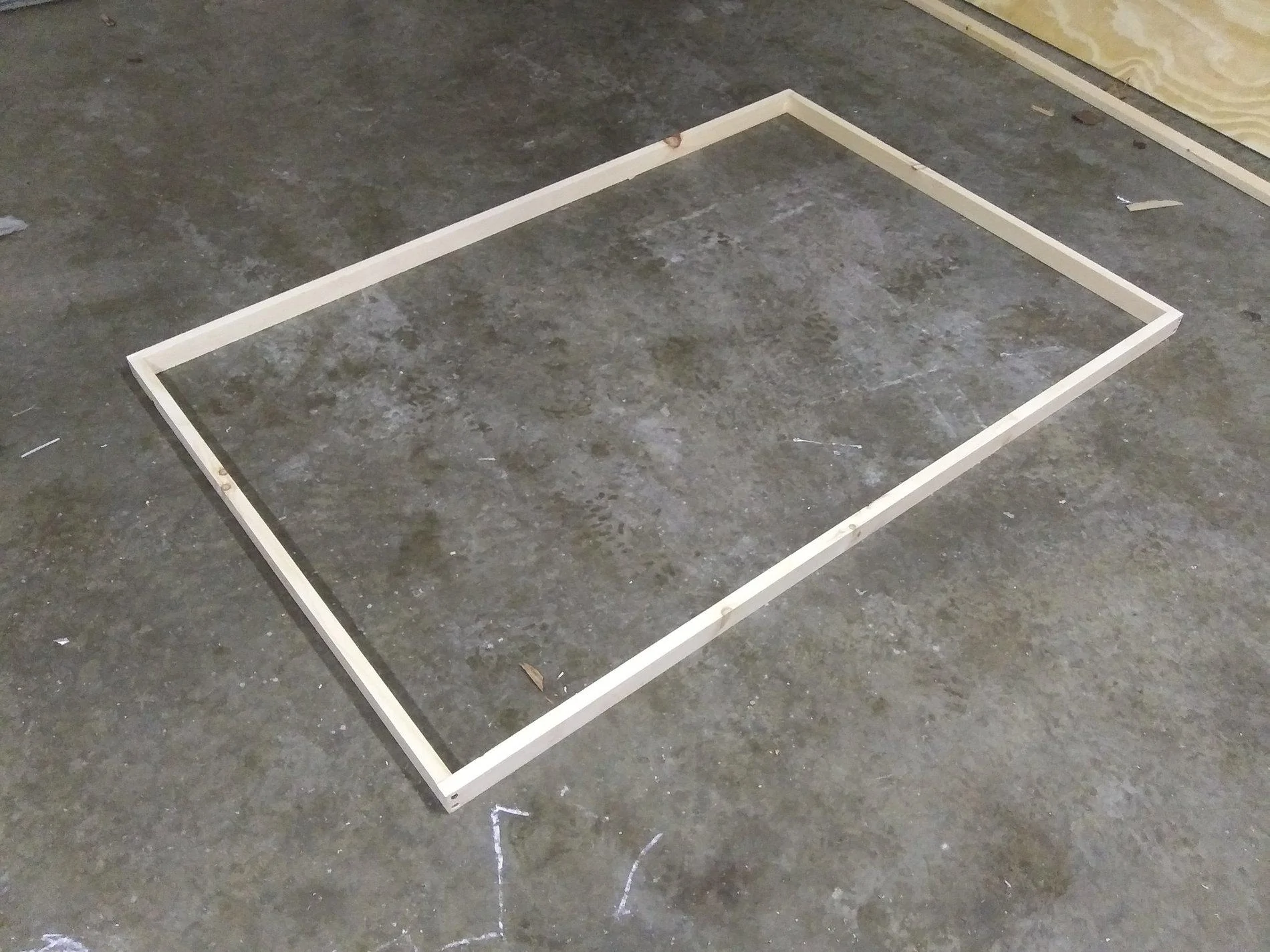

3) Cut 1x2’s to size for frames. The frame fits just inside the rails, with just a little space between the rails and the frame. Each bed cover section has its own perimeter frame.
4) Screw/nail together frames, using a little wood glue for extra security.

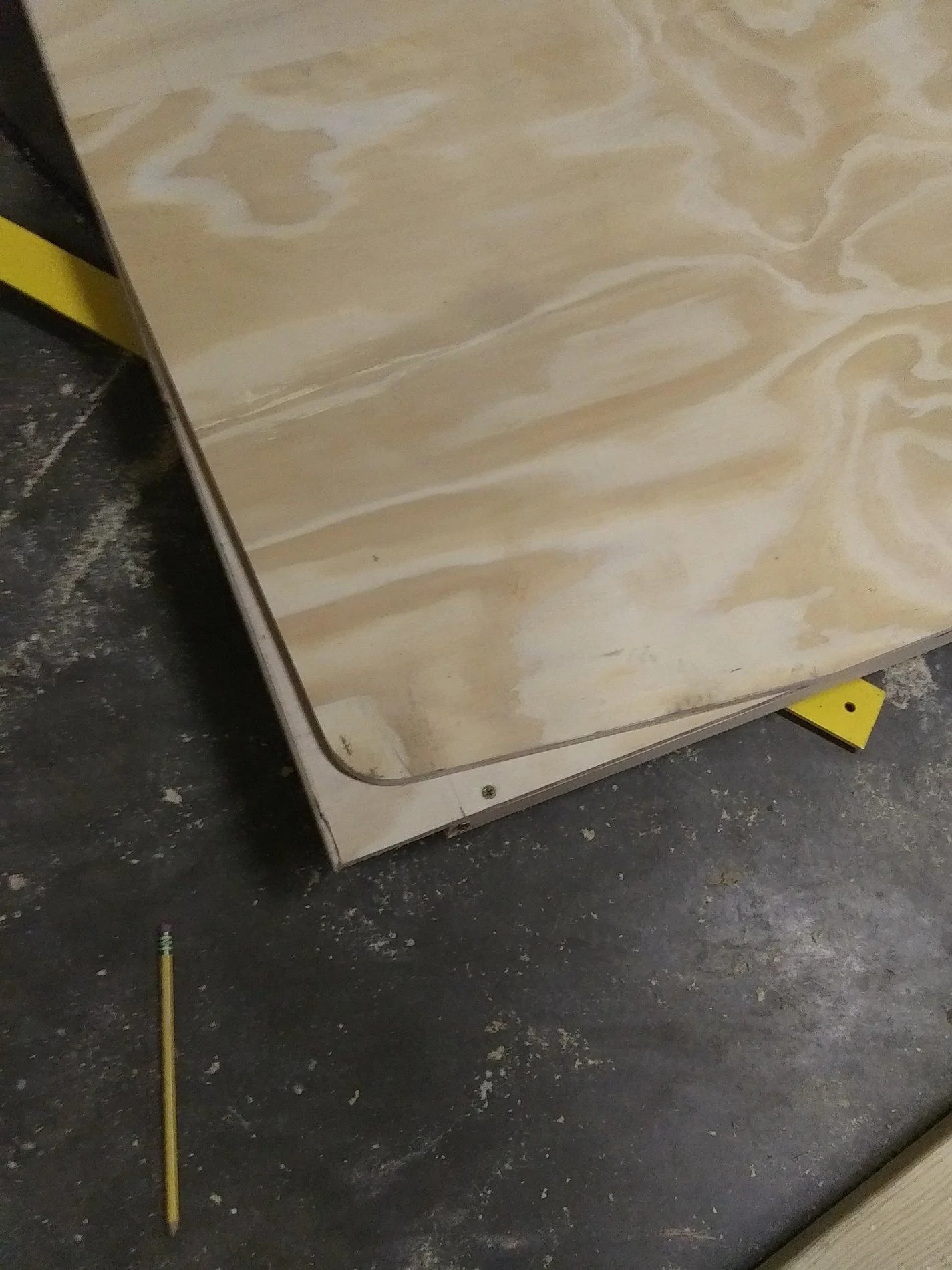

5) Attach frames to plywood using wood glue and screws/nails. Note that I placed the “C” side of the plywood facing toward the frame (see my hindsight note about this towards the bottom of this post). As you can see in the picture below, the frames on the two sections butt up against each other at the joint between the two sections, but that is the only place where the frames go all the way to the edges of the plywood.
6) Optional: I used a ÂĽ inch roundover bit to route the edges of the plywood.
7) Add a strip of 1 x 2 flat (ripped on the table saw to make it a little narrower) on the cab end of the bottom of the cover to help fill the gap between the bulkhead rail and the cover. You’ll see what I mean.

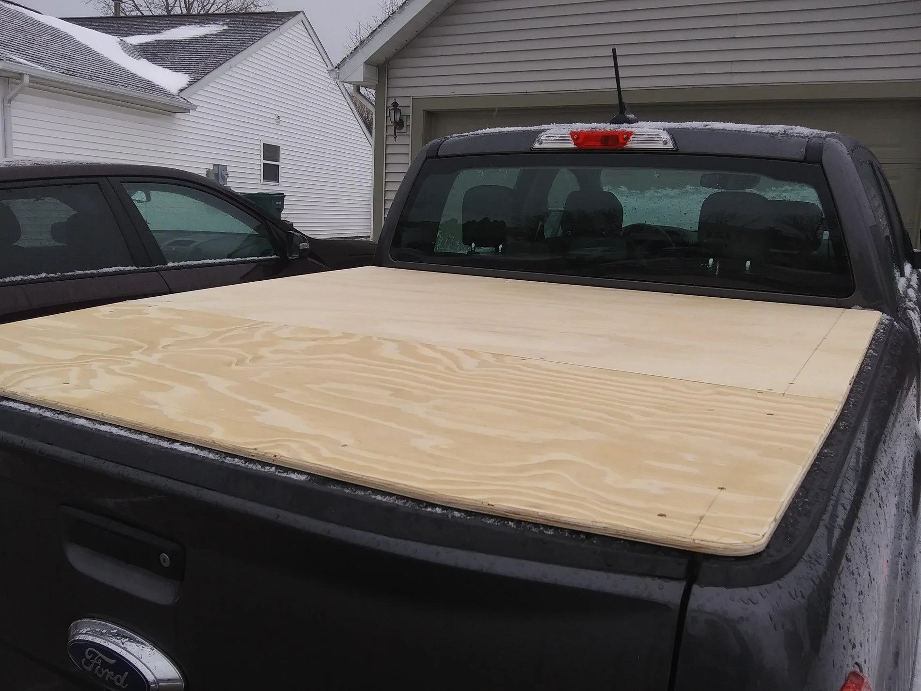

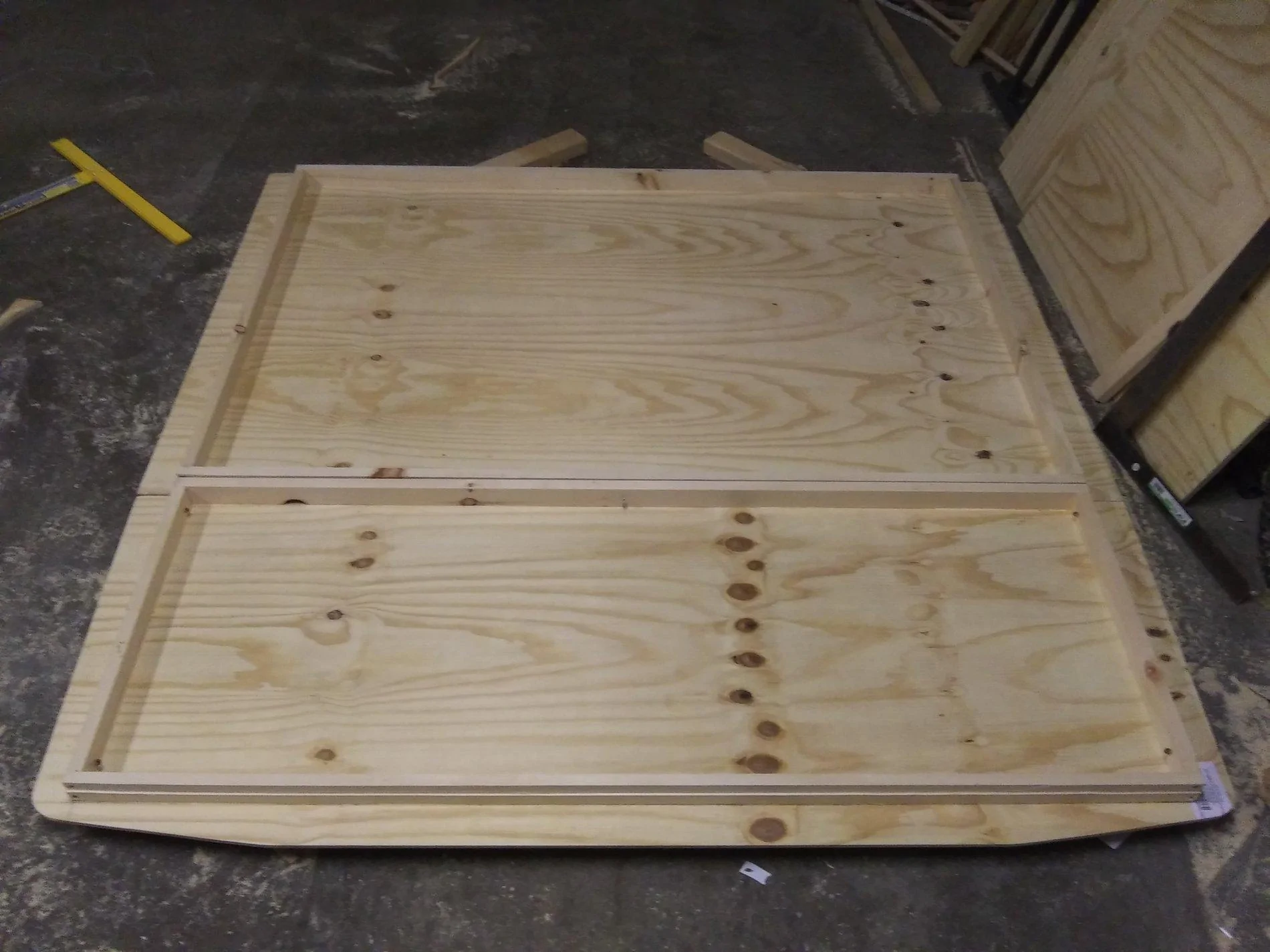

I was doing a lot of test fits on the truck as I went along. Here's a test fit of the two pieces of the cover while still bare wood:

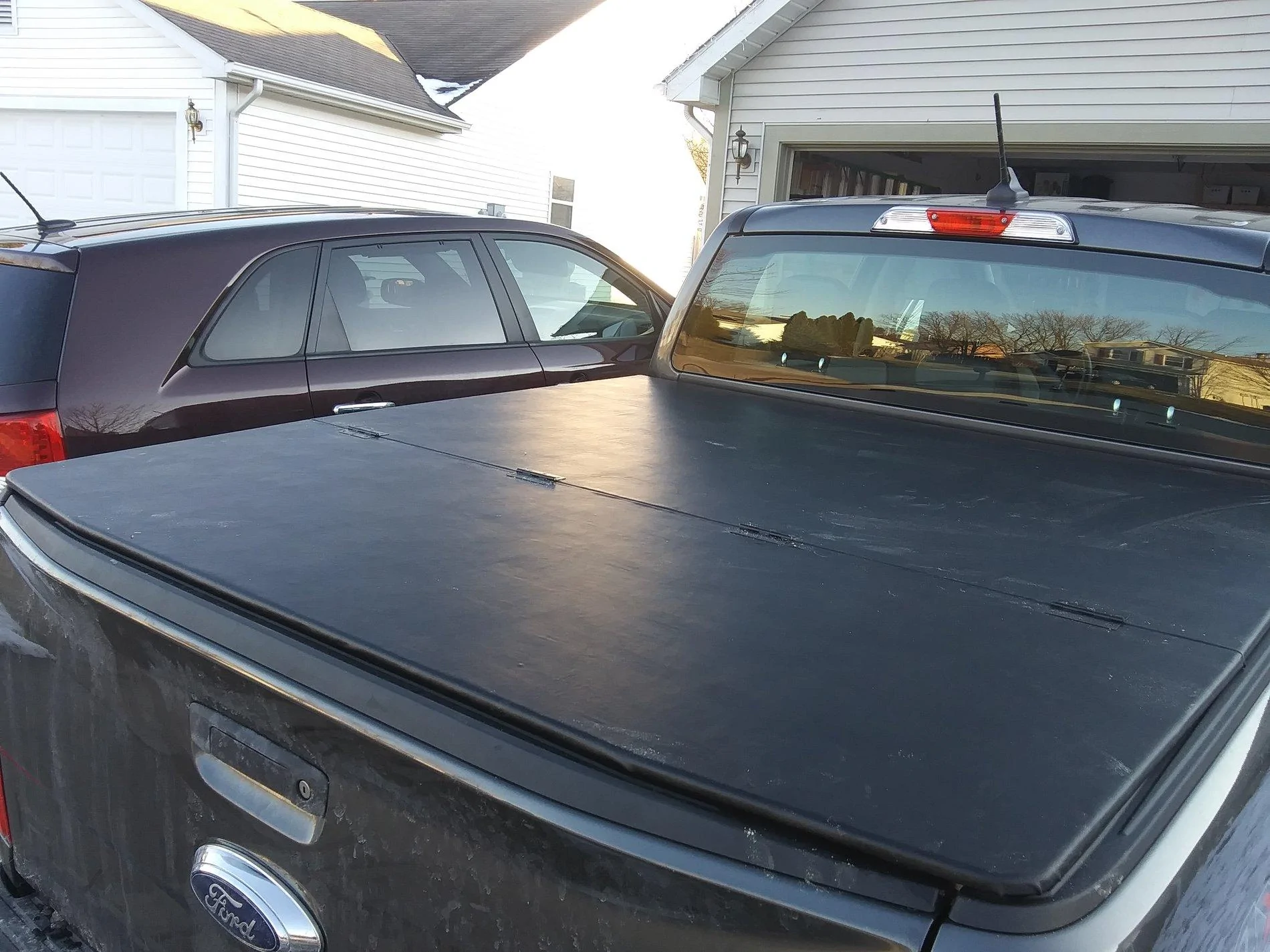

8) Cover the top with the vinyl fabric using LOTS of spray adhesive (do this in a very well ventilated area). Wrap the vinyl around the edges and staple to the bottom of the cover. Note that this is the first time I’ve tried doing something like this, so I didn’t quite stretch the vinyl over the cover perfectly. It still looks good IMO, but the perfectionist in me is a little disappointed.

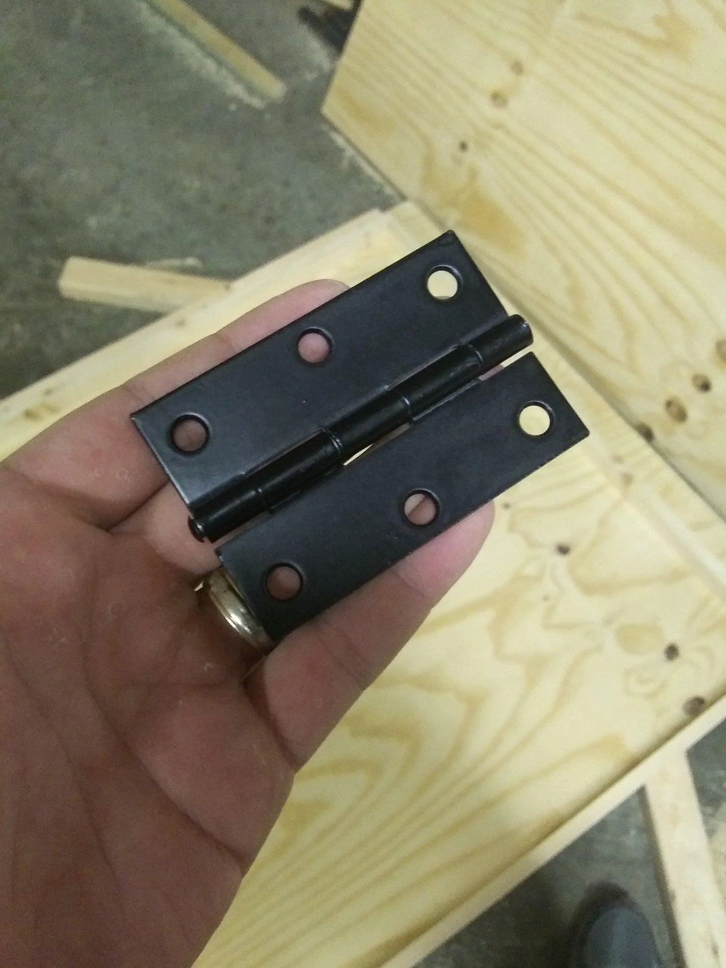

9) Paint hinges black to somewhat match the fabric.
10) Attach hinges using provided screws.

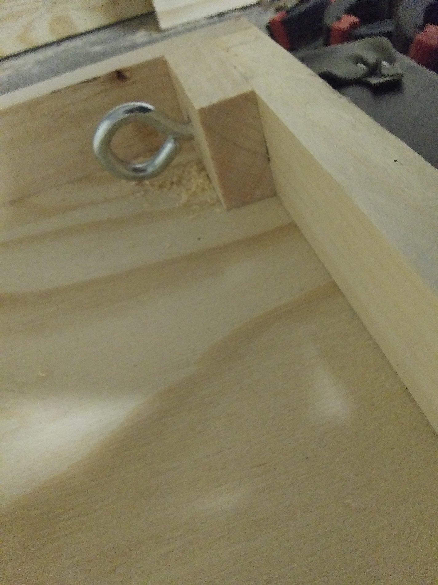

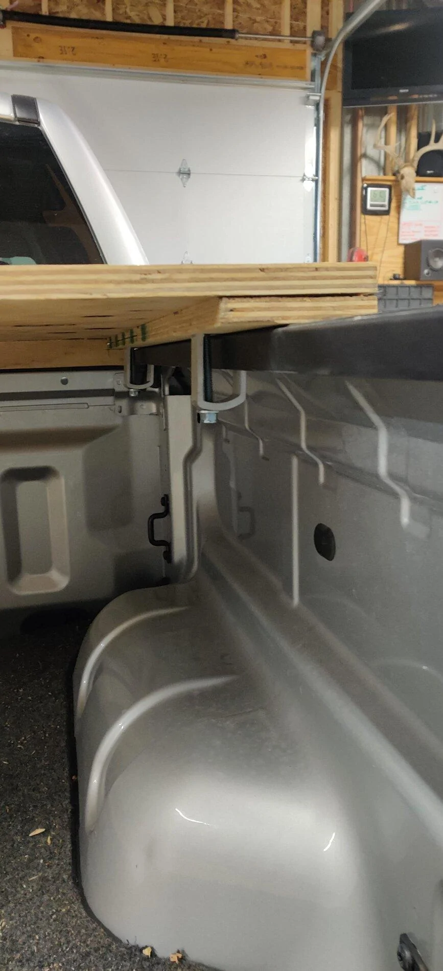

11) Install eye-screws where appropriate, so that they roughly line up with the tiedowns in the bed. I added a little blocking to help ensure strength at the attachment points.
12) Add seals as desired. (Haven’t done yet, but I’m going to at least add a seal down the gap between the two panels.)
13) Use a strap between the bed tie-downs and the eye-screws to fasten the whole thing to the truck (see my “hindsight” note about this below), and the cheap tie-downs to hold down the folding section. Was dark when I did this, but you can kinda sorta see what it looks like in these pictures. I'll need to add another anchor point towards the middle. Inside:
