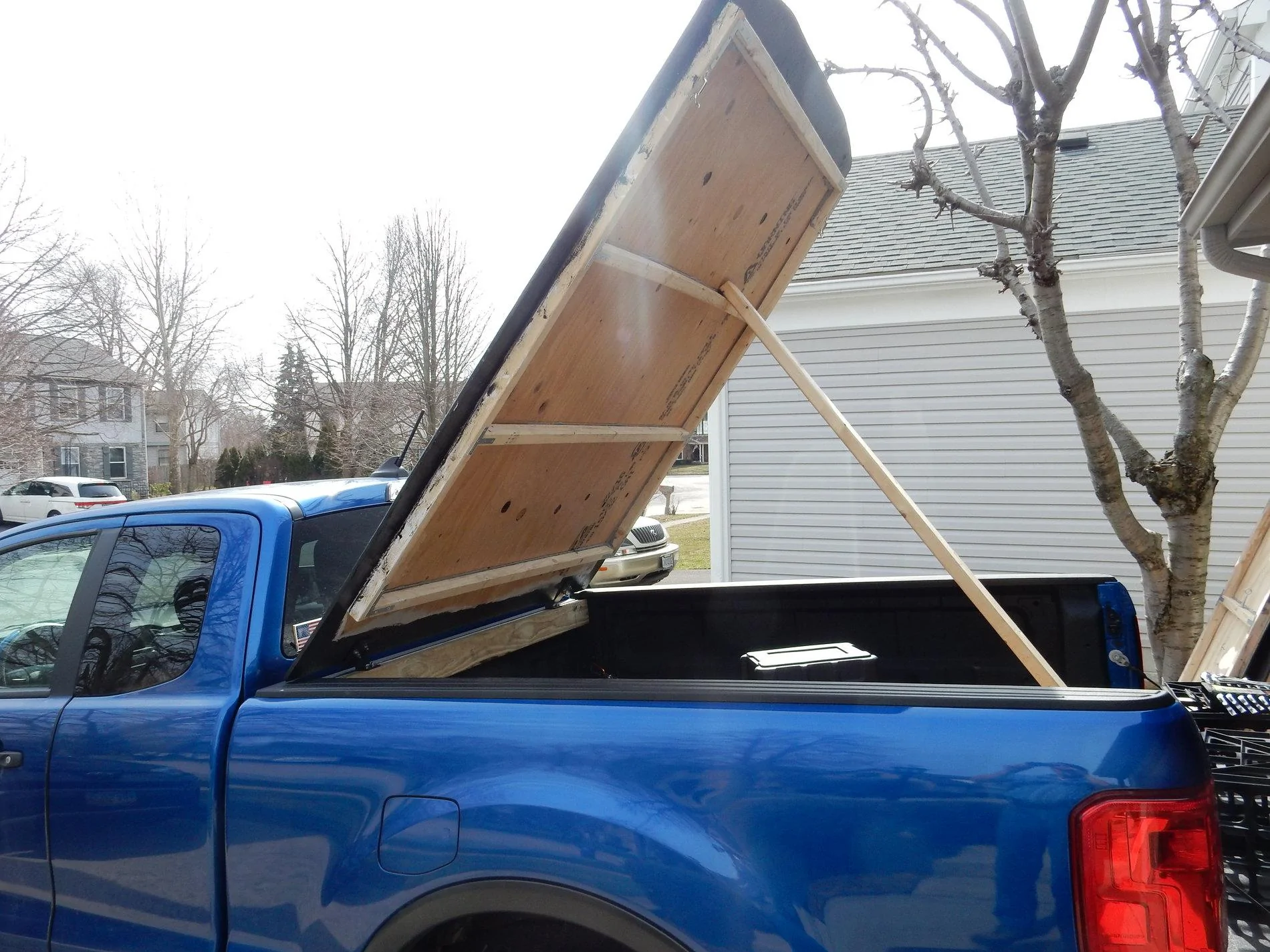

If you cannot afford to buy the gas lifters/struts then try this - the hillbilly 2 x 4 "wood" lifter. :rockon:

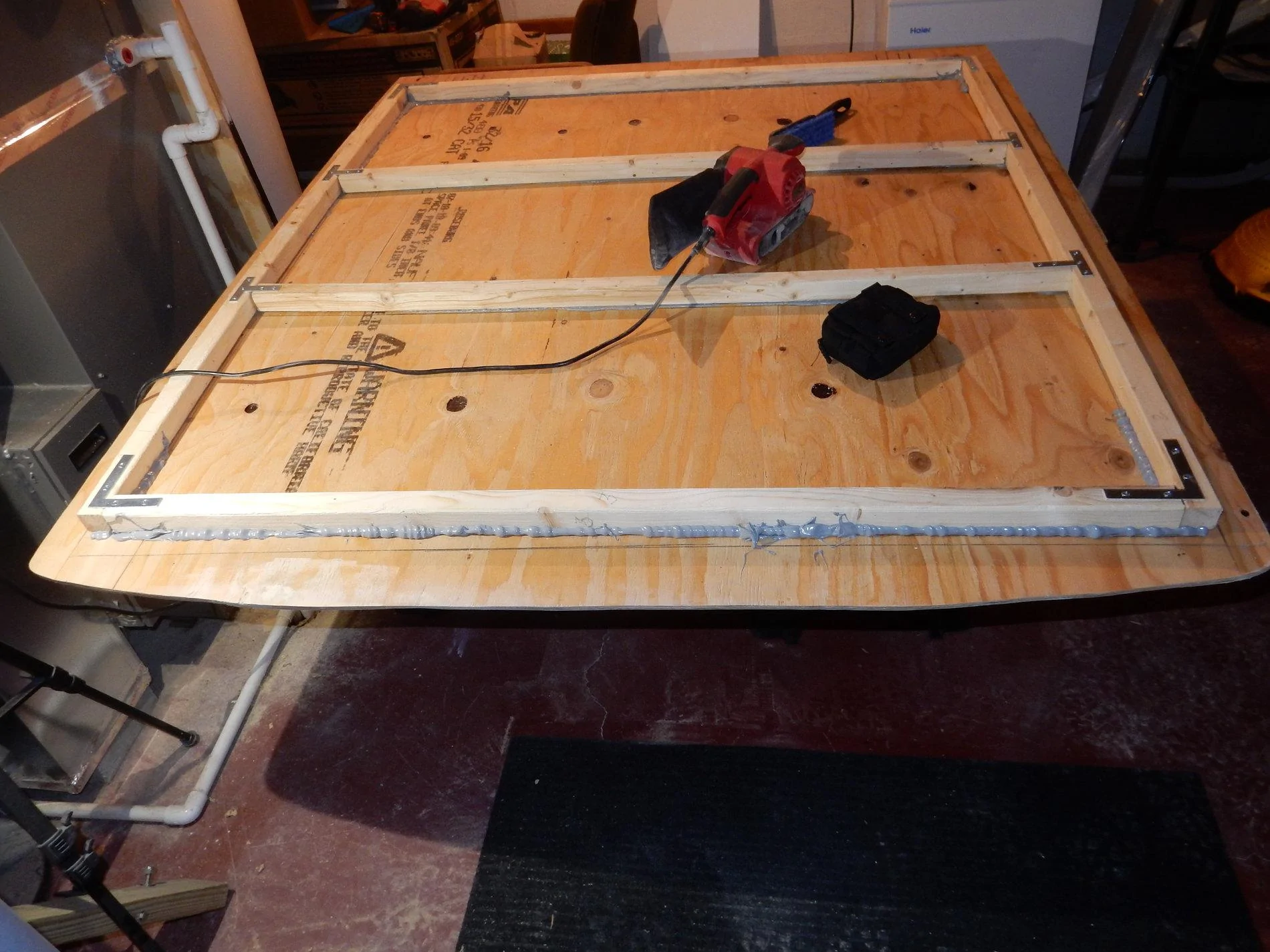

4. (Done) Upgrade from the no frills panel - (required due to plywood 5' width span) - add 2" x 2" ladder frame below the cover bottom using only Fuze-IT (no screws) industrial adhesive and pine furring strips for "possible" future warp control and superior panel strength.

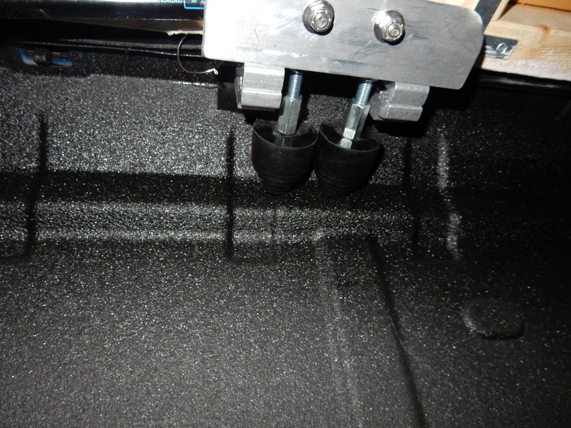

I have a policy that anything added to my new Ford Ranger there will be no drilling and machining on the Ranger. That being said, I added only one gas lifter (two is much better but I wanted to keep one as a spare) to the truck bed rails was a totally bone head, insane design decision plus there are no convenient mounting holes to use from Ford for the gas lifters. Twisting of the mounting hardware clamps for the gas lifter on the truck "flimsy" bed rails created a safety hazard. I set out again to redesigned the gas lifter mounting hardware. See pictures (below). If the new mounting hardware, for the gas lifters can last for over 100 cycles and not fall off then it's Miller time.:beer:

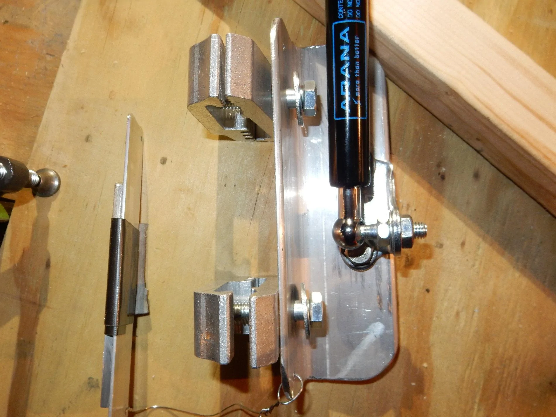

Gas lifter new mounting hardware design.

Added two Polyurethane suspension bump stops, to keep the gas lifter mounting hardware from twisting. Keep in mind, that one gas strut is being used to hold 53 pounds spanning 5 feet wide. Using two gas lifters would have been better. Updated - changed to using two gas lifters (not one) Back to the junkyard for more aluminum angle materials for the extra gas strut.
The pic below is the bottom of the gas lifter mounting hardware with the bump stops.

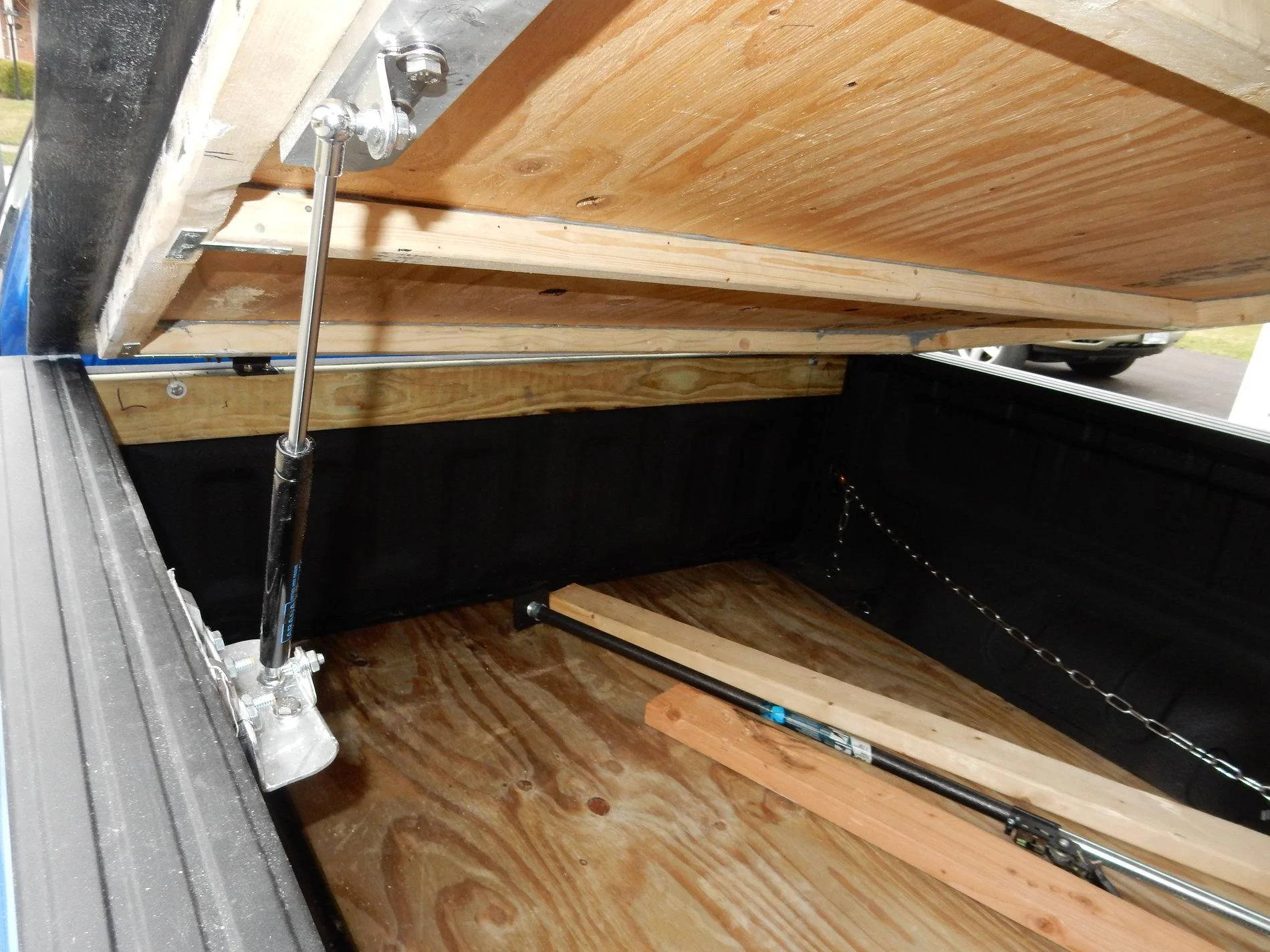

It's done.

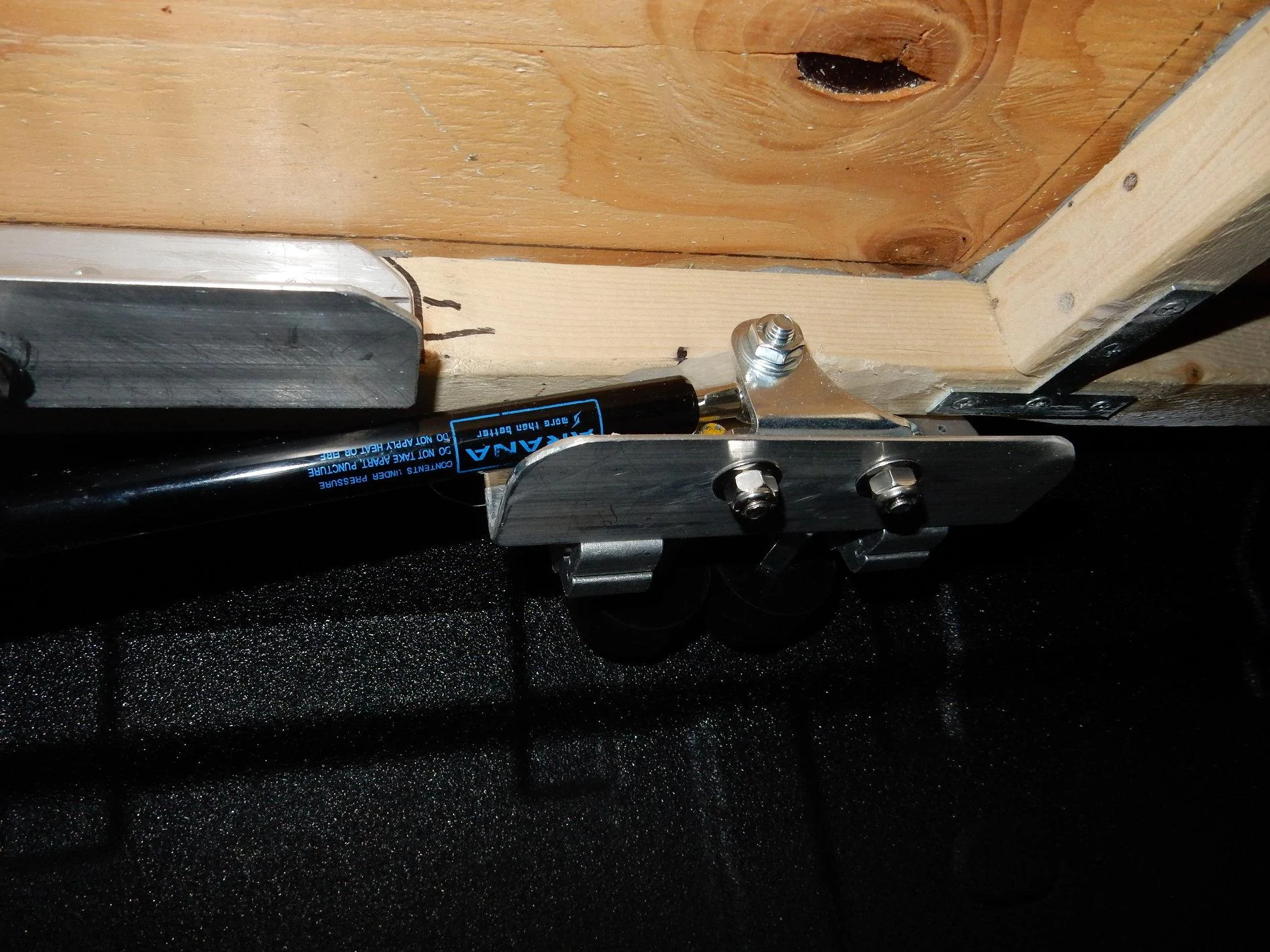

Top view of gas lifter mounting hardware.

Since having two common "universal" gas struts (I now have two gas struts instead of one for the incline truck bed cover) releasing both gas strut arms takes time with two wrenches. I was going to design and "weld up" a toolless design but I found a better "off the shelf" solution. The universal gas struts, I bought, have a fixed ball/socket arm strut ends (non removeable) that has mountings studs/nuts on each end for the support brackets. Unscrewing the ball/socket end from one end of the gas strut and adding a "spring loaded 10 mm ball socket" to each strut end will solve my problem. In addition, you have to add/install a separate 10 mm balls with mounting studs/nuts to the mounting brackets. In the end, I now have two easy, toolless, removeable gas strut arms. Having the ability to separate both gas strut arms makes it very convenient to add odd shaped and large cargo like mulch to the truck bed without having a fixed incline angle on the truck bed cover. Also, it aids in quick and easy complete truck bed cover removal. Please note - stating the obvious: Warning - to remove both gas strut arms you need to allow the cover to extend in the incline, "non-compressed" state. Only then, you can release both gas strut arms BUT you need to brace the cover (use a 2 x 4) or else the 50 pound cover will fall on you - have the EMS on your smartphone ready for medical help. :crying:

The required bottom ladder frame supports the top truck bed cover and adds strength to keep it from warping and bending. Keep the ladder frame away from both truck bed rail edges by at least 3/4" or you will have trouble installing the gas struts/lifters hardware to the truck cover. Since the distance between truck bed vinyl rail to rail ~ 55 3/4" then the ladder frame maximum width should be less than 54 1/4" and centered between both rails on the plywood panel bottom. If not, get out mister hammer and chisel and chop away for hours. :frown:
