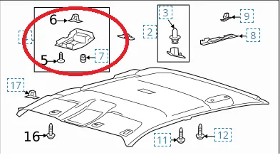

Well you're in luck because I have been researching the same thing for a while now and with help from Benny @LevittownFordParts.com I know what I need to do to make this happen (*I have a SCAB so if you have a SCREW not everything I have found will work in your application and you may have to do more research just FYI) and I'm just waiting to get the suspension on my R32 finished so I have a second vehicle to drive while this is done.
Headliner I plan to recover in Alcantara so no issue there. A pillars not sure yet, re-covering seems simple till you look at the contours of the P/S A pillar where the grab handle is. Looking at the material though, painting the A-pillars might be a better option. Now for the rest
2024 6G Ranger Raptor has a black headliner and stuff and almost everything will work (that I looked at for my application).
Sun visors - Same size as 5G and bonus, has home link. Clips are the same as well.
Rear map light - same as well.
A-Pillars not the same, but the P/S grab handle is and is available separate so no need for painting. You can just swap out.
Overhead console - this one is the issue (for me anyway) if you look at the 2024 RR and the 5G headliner in this area, the overhead console will work even though it's longer due to the aux switches, the shape of the headliner is the same, so some trimming of the headliner would be needed to get it to fit, but the issue is the "cubby" above the console, is only available with the RR headliner, unlike 5G it can be bought separate. More on this later.
Grab handles - same
I have some hooks in the rear, no grab handles so that will have to be painted.
The microphone above the driver (didn't know what that was till Benny said what it was lol) the RR one is round, where 5G is rectanglish, might work, might not, painting this is fine though. I plan to make a write up when I do this if anyone wants to attempt this as well.
Back to the overhead. I wanted to use this, as the RR has aux switches up there, but being that the cubby is not available separate, I'm not sure how attaching it will work without that cubby. So my plan is to just use it for parts. I plan to take mine apart as much as possible, paint it, and then use the black switch and the sunglass holder door from the RR one, one because trying to get the little light on the switch to look right, and being that I use the sunglasses holder a lot, I want it to look right and not show wear over time. OCD...probably, but that's just me lol. Now if you have a SCREW, which most seem to, using the RR headliner might work, I don't know, this is where your own research may need to happen, as well as the B pillar and rear trims. In the SCAB, B pillars and back are all ready black. Any other questions let me know, I hope I covered everything.
