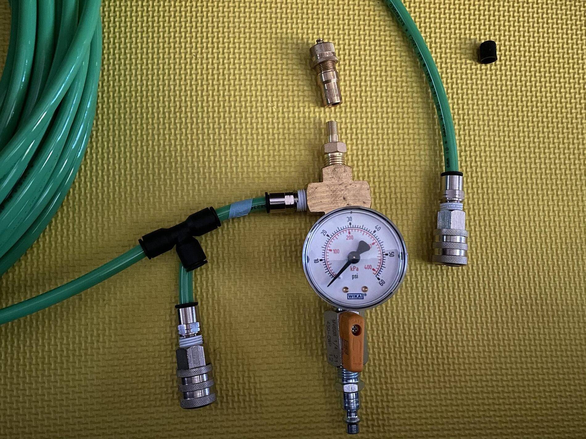

I finally got all the parts in for my 4-way air system. It is not exactly as the video though.
I am using a Viair 400P to feed the system, which uses a 1/4 inch nipple leaving the compressor. My manifold is a 1/4" nipple into 1/4 turn ball valve, into a T for the pressure gauge, then into a cross with 2 airlines and a Shrader Valve for a Staun Deflator.
The airline and hardware is where I altered mine. I used 6mm I.D. single wall, non-reinforced polyeurathane line rated to 97 psi. It uses quick connects made of plastic or metal. Cut it with any knife, slide into quick connect and done. To remove, push the black collar in, and the pipe comes right out. After multiple connections, trim back 1/4 inch of pipe if it gets damaged and good to go again.
Although not as durable as reinforced rubber hose, it should be more than adequate, provided it doesn't get walked on or otherwise abused. It is much smaller, lighter and just as flexible. It may not hold up, but that's where I am starting. For safety sake, I will also have the Viair hose and 5in1 inflator with me JIC this all blows up ;)
Retail is about $300 CDN for the manifold, connectors, 70' of air line and 4 tire quick connects.

How long does it take to air down four tires with a single Staun deflator ?
I am just putting it all together right now, so I'm not sure. It's also raining here, so I won't be testing it today.
To be honest the Staun were mostly bought for the inflation side. Put on the system as a blow-off valve in case I'm not paying attention and leave it running too long.
For deflating I can open the ball valve for the major of air flow, then close it and let a Staun regulate for the final setting.
The Staun are a bit of an experiment on this system, just like the poly hose. Play with it, see if or how well it works, then make adjustments for the next build.
It depends on tire tire pressure before you screw them on and how low you have the Stauns set.
On my Jeep, by the time I walk around and install each one on a tire, the first one is nearly done. I start at 37-38 psi and the Stauns are set for 15 psi. So, the answer is, it depends...
