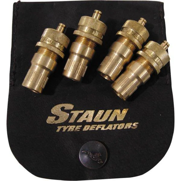

Another option that I have been using for the last 7 years. $20 for a set. You can run over them and they still work, they will last forever. I can put them on each tire and if I had to move my vehicle I could. I could even drive 10 miles an hour and let the tires deflate as I moved up the trail If I was in a real hurry to get somewhere.
These you can put them on and come back 10 minutes or an hour later and they stop deflating a tire at the set pressure. Somebody in your group doesn’t have any deflator, no problem it’s a simple screw on and remove when done. Nothing technical about it.
4 way air is super nice but that system has too many things I would have to carry around and keep control of. $70 vair air compressor and staun deflaters is the cheapie and mobile way to go (can use on any vehicle when out with your buddies).

I already have a Viair and was looking into getting the Staun deflators. With my Bronco I'm thinking of getting the ARB onboard compressor and this will come in handy. ....
ARB air is sweet! Your gonna like it and your gonna have friends (that park near you for fast fill ups).
I actually have the Boulder deflaters Now $37. But if I say Boulder deflaters nobody would know what I meant so easier to say Staun.
$37 Boulder set
you can even find less expensive ones that look 100% identical (most likely all made in the same place).
$20 set
Another advantage to the Staun is that you can adjust them to lower the tire psi to whatever you want. Mine are set to 15 psi.
These are on my list to get. I know there are some cheaper versions out there but everyone I know that has the Staun loves them! They've gone up some in price and it looks like Amazon is the only place you can really get them.
I know what you mean about the Staun lovers, but if like me you only go off-road a few times a months or less, these might be great too: Hromee Automatic Tire Deflators Kit
I got a lot for my money in that kit... Gosh, for that price you can even buy 2 or 3 kits and set them up at different pressures!
The caliper method worked great for me: set one up and adjust the other 3 at a similar length, then lock the rings tight.
