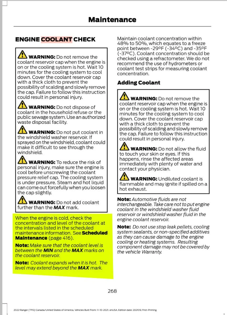

Our manual says when the engine is cold it should be between MIN and MAX and it's ok if it expands over MAX while in operation...
For some stupid reason this didnt occur to me. It's all symantecs at that point but I wish I had pulled the manual out...

In the first place, a flush at 39K is ridiculous. I hope this was your idea and not theirs. When the engine is cold (it doesn't matter what ambient temperature is) the level in the surge tank should be anywhere from MIN to MAX. Not below MIN.
