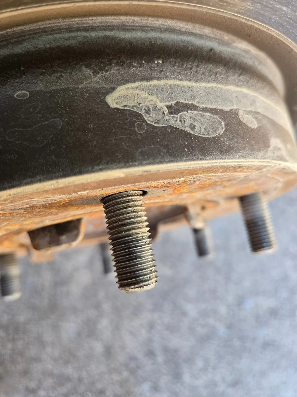

A few thousand miles ago I had the truck at the dealer for a warranty transmission rebuild. I noticed when I got it home my new one piece lug nuts were scratched up on just the front wheels.
I went to rotate my tires and clean up the truck a bit and I could barely get the fronts off. I had my 1/2 ratchet with a cheater bar and struggled to the point I almost gave up. I'm a bit paranoid about the studs, they look fine but I've read of them breaking when over Torqued. Should I be worried?
I got the tires back on and Torqued them down to 100 ft/lb like I always do. Took it on a short drive then re Torqued again. Everything seemed normal.
Hi joeD
Steel remembers when it is hurt. your studs should be okay if the yield point was not exceeded, but how would you know this? What I think is you have about 1000 miles or more and no torque loss, so I think you are okay. Not easy to check as visual shows okay but studs may have been hurt. They will not go all at once, but a torque check would show breakaway torque below other studs. Many times I have seen all studs sheared off as the wheel leaves the vehicle. It would indicate all studs failed, but that is almost never the case. One stud goes South which causes added stress on the remaining studs, of which another one gives up and heads south, which places the remaining studs in a position where they give up as well. Safe would be to replace all studs on the front wheels but pricey, so just check the break away torque...not the tightening torque of a click torque wrench...digital or old style needle and scale kind.

Well I think the issue with that is I've already removed them, so we will never know how tight they actually were. If I do that test now I'm just going to see that I've torqued them down correctly. That is unless I'm missing something.
