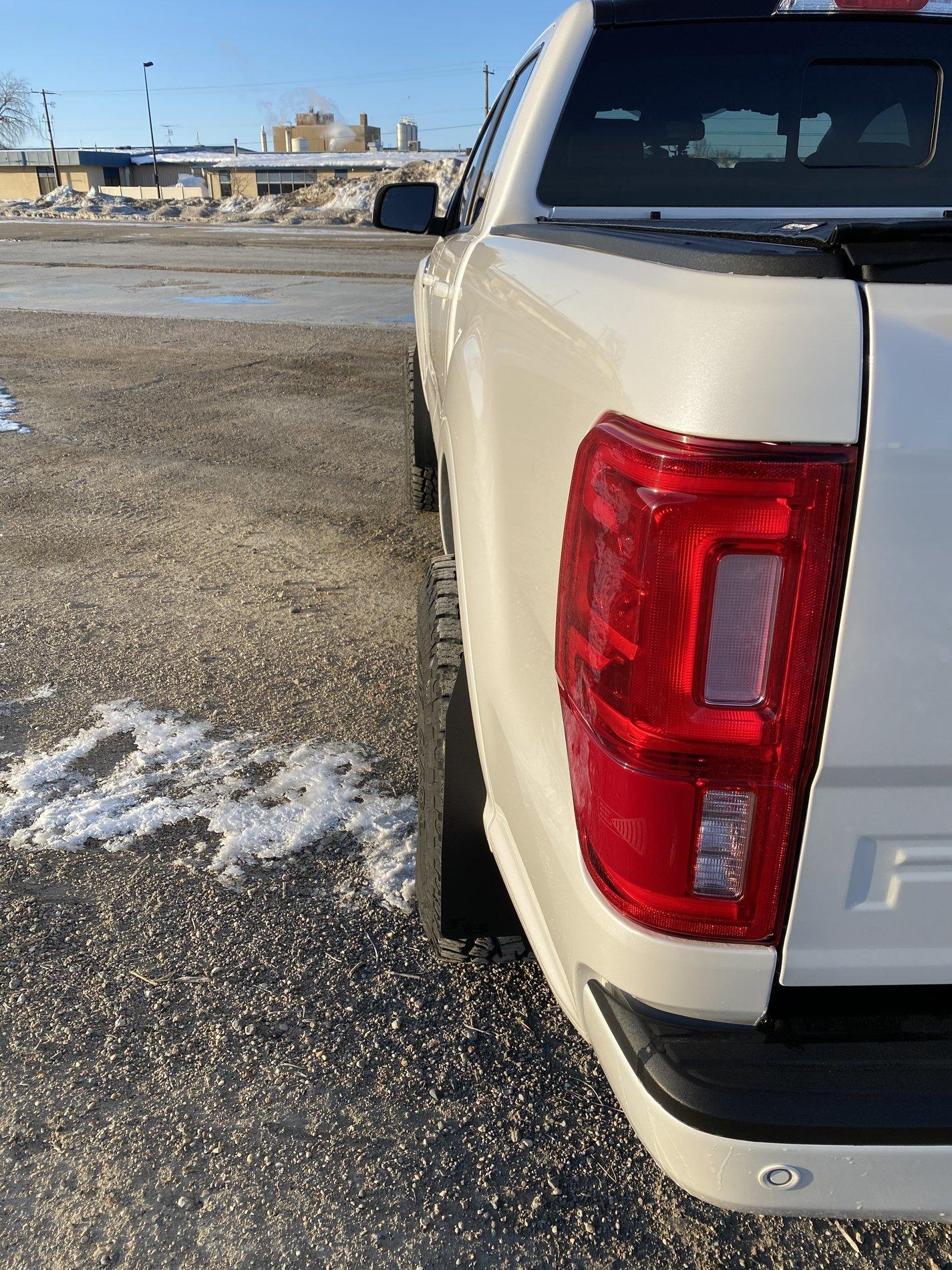

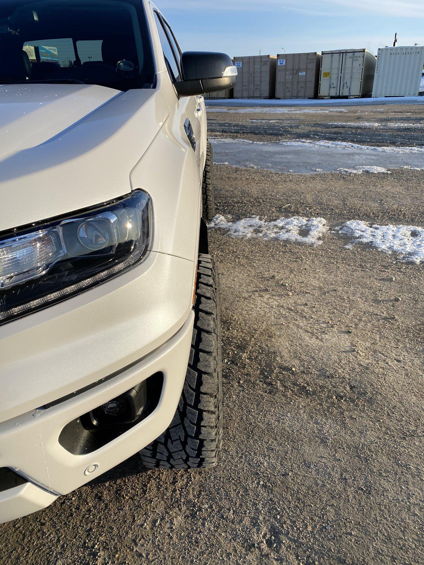

I like how the tires are out a little. How is it with full lock turn? Any rubbing issue?
Actually my tires do rub at full lock, but its just on the mud flaps. If I took the mud flaps off there would be no rubbing, or at most just a tiny tiny bit.
