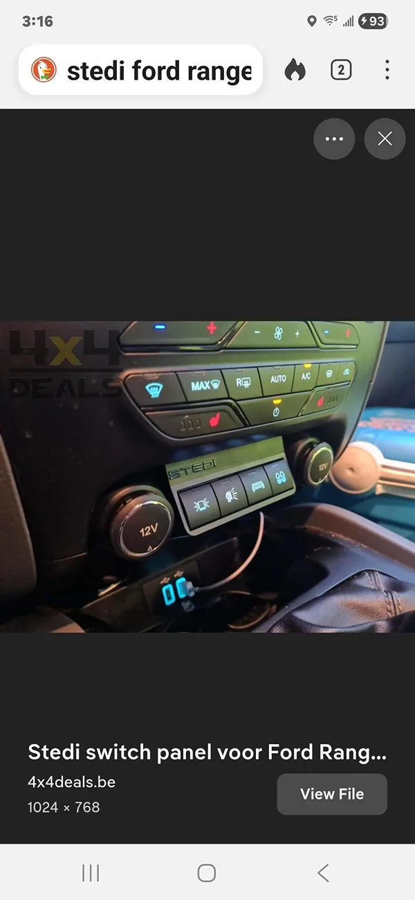

Does anyone know a good place to tie into dash lights for stedi switches? I have the rest all figured out just need a tap for the dash lights.
Any help would be appreciated.

Having trouble getting that info. Diagram just says interior lighting. Others on here that used these didn't tie in they just used power full time. Id rather not. These are the toyota square switches by stedi. It would be really nice to have a fuse I could tap for interior lighting. That would be easiest. I have several fuse taps.

These are oem illumination compatible led lit switches. They are toyota 22mm square switches. I Just need a place to pick up illumination signal that won't freak out the bcm.

This is what I'm putting in. It snaps in under the power ports.
