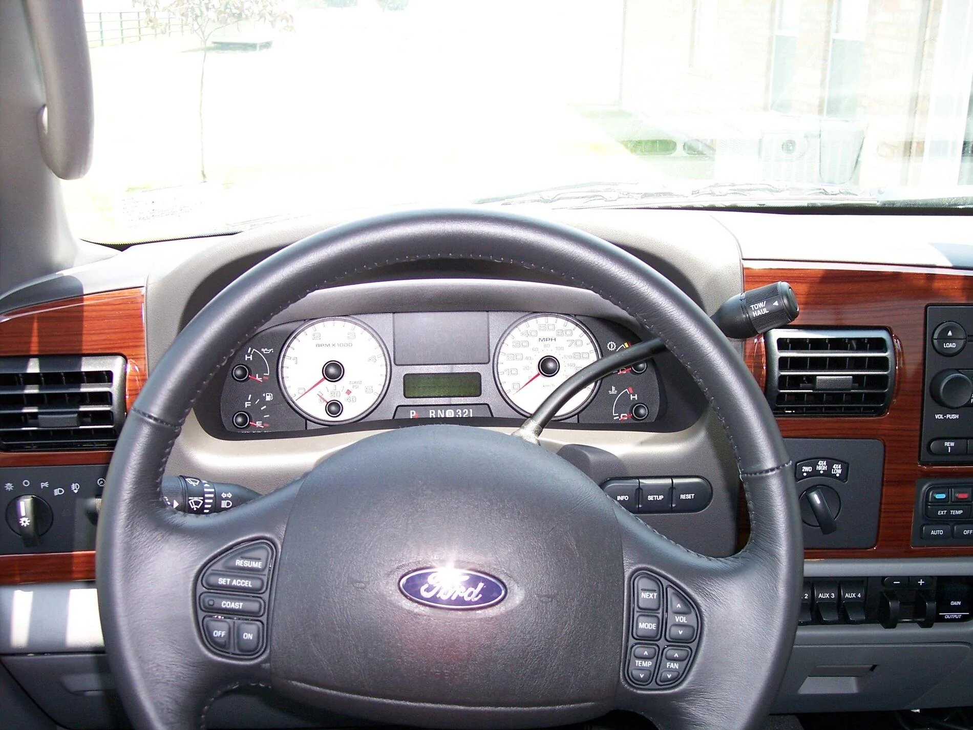

At one time the Lariat trim came with the woodgrain appliqué. Here is my 2006 F-350 Lariat. The appliqué is also on the door handles and center console. FYI the optional integrated brake controller is in the lower right. It was an additional option to the optional tow package. Trust me on that I have a pic of the window sticker.

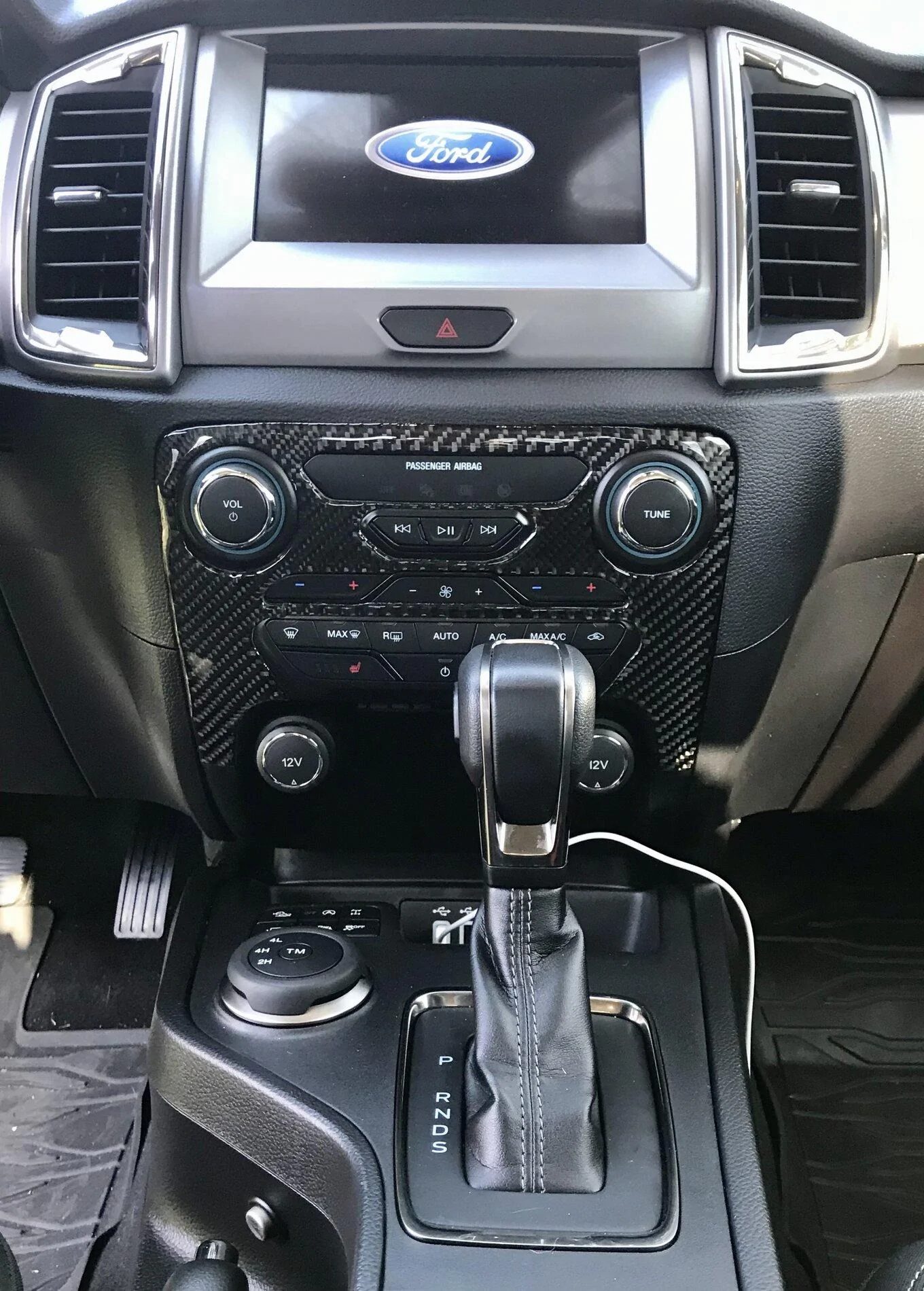

An update. I received my real carbon fiber kit. I installed the door window switches and also the center radio/hvac piece. I did not install the lower (shifter area) piece as of yet as I have an issue with the chrome trim bubbling - the part has been on order from the Dealer for 3 weeks now.
I had a problem with the radio/hvac piece. After lightly applying it, my temperature rocker switches would not return to the neutral position when pressed - the appliqué was ‘in the way’. It almost seems like cutout area around the rockers is a bit too small. I attempted to lift the appliqué to try to reposition it a bit thinking that might solve the problem. Well...that sucker was already really stuck (even without pressing down) and when I tried to peel it off - the thin narrow strip that runs right under the temperature rockers tore in half. I panicked and tried to realign it but it’s still a bit off.....but....my rocker issue was resolved - lol.
A 2nd problem also happened - on that same left side there is a slight waviness to the appliqué just to the left of the volume control. The appliqué appears to be stuck down well and is not lifting anywhere - weird. Apparently another member - Cape Cruiser - also had this issue (both the rocker and waviness issue) and was sent another appliqué from Wooddash.
I contacted Mel at Wooddash, sent him a pic and he is having B&I send me a new replacement appliqué. Mel has been great to work with. He also said I was the 3rd person he knows of with this problem.
Overall though - I really like the look! It adds character to the interior and enhances the overall look.
Here is a picture of what it looks like.
