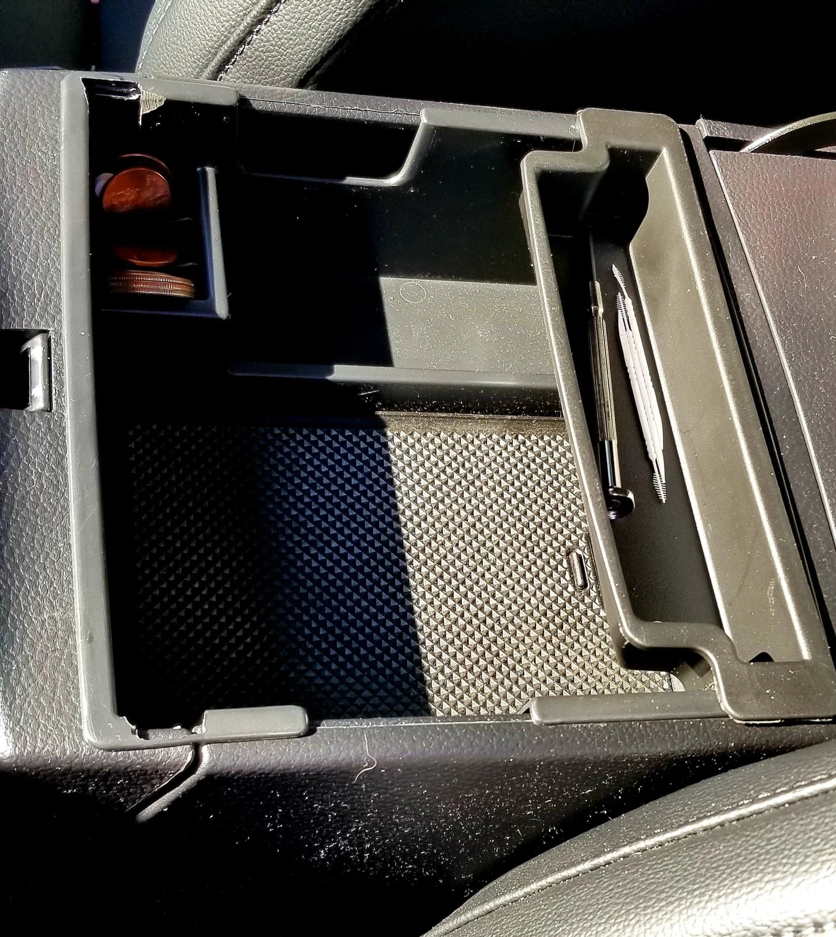

The little removable change shelf popped out of the center console and when I put it back in the lid won’t latch. I put it in every way imaginable and the lid won’t latch. Ya think I’d be smarter than a small piece of plastic, but apparently, I ain’t.

When you put it in, make sure there is a space about 1/2 x 1/2 in on the front left and right sides so the prongs on the lid can slide in place when it closes.

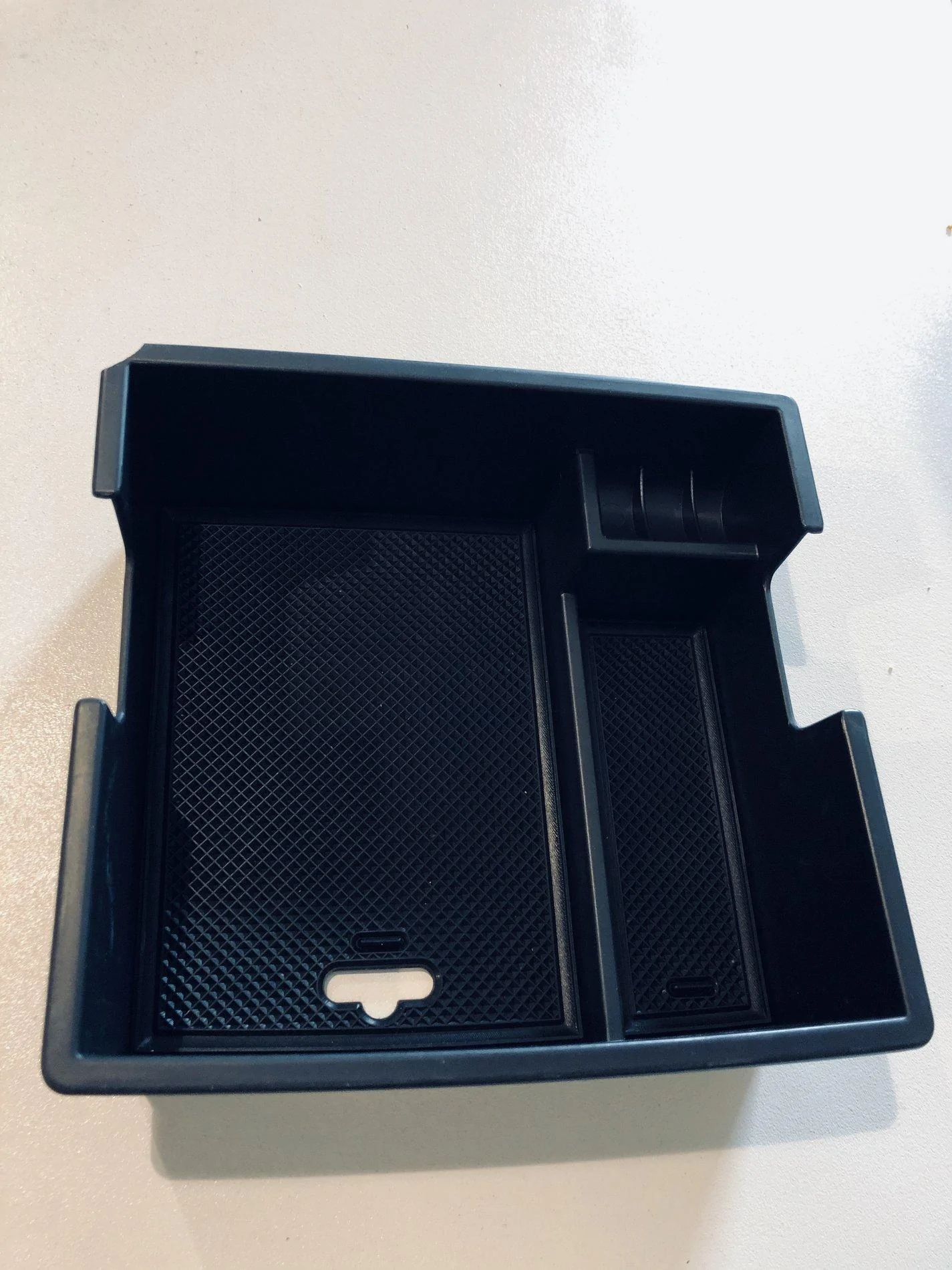

Or as others have said, get the tray and modify the right and left front edges so the prongs fit when closed.
Then after your new Ebay tray is in, insert the little removable change shelf. I had to file down the nipples a bit and a dab of silicone to stay put , but it works great.

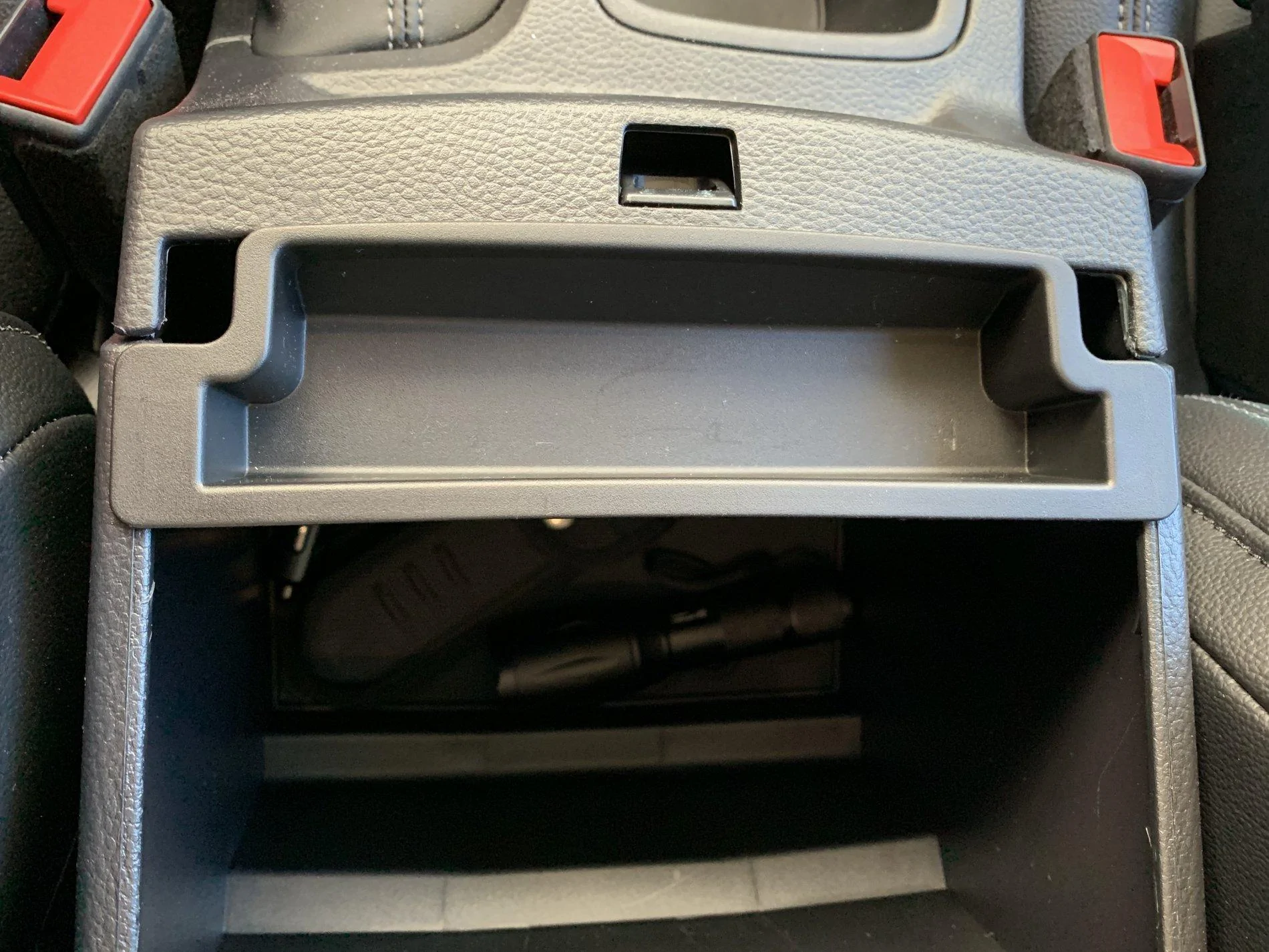

There's a slot. It doesn't just sit on top.

Ray I have a spare tray that I purchased awhile back. If you want it PM me your address and I’ll send it your way.

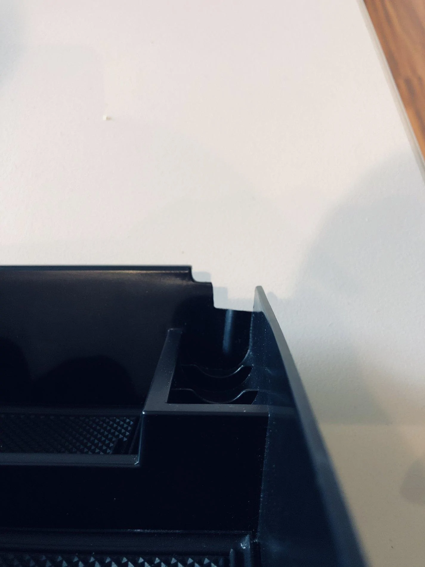

Note you will have to trim out the corners like so. I also used a file, sandpaper and a permanent marker to clean up the cut marks and scratches after I made the cuts.

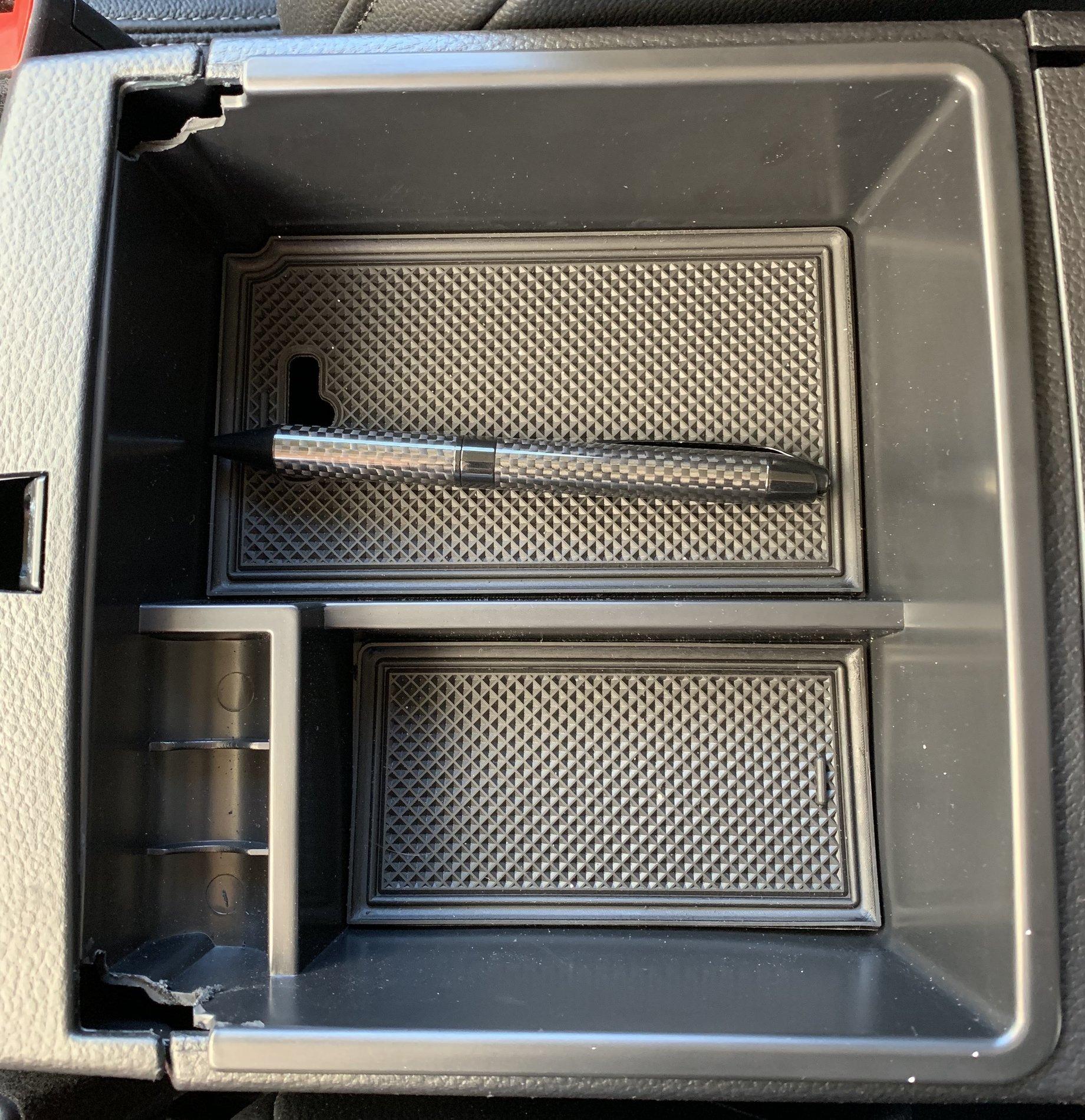

Move it to the rear and it will snap into place and the lid will latch. Trial and error on my part as well
