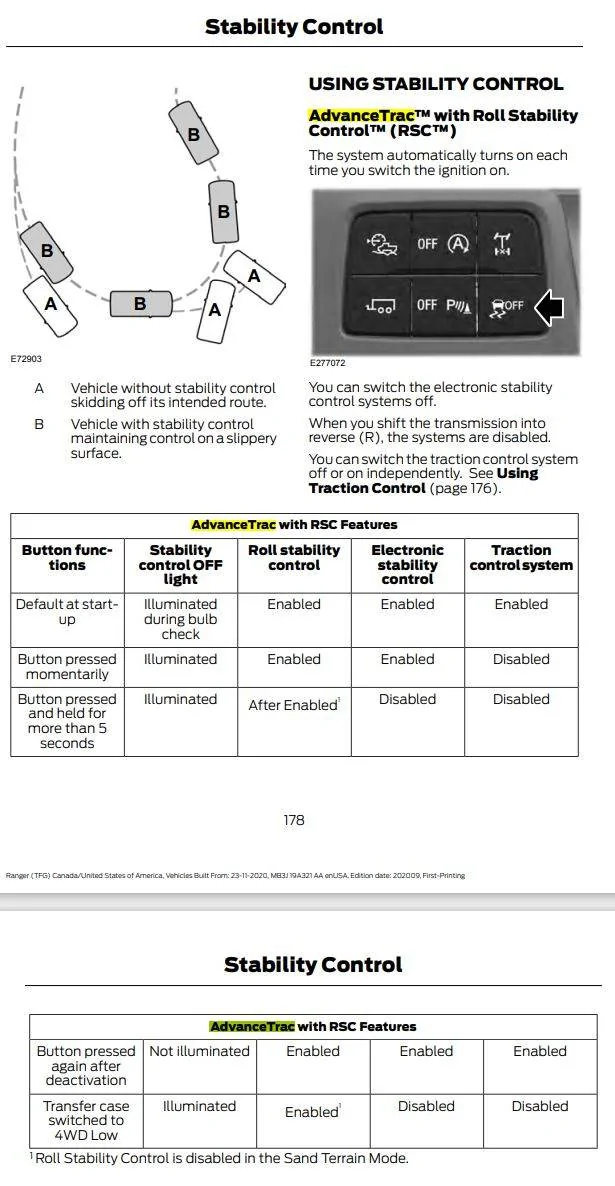

I have no sway bar and long travel with stiff coilovers so I get minimal body roll yet each side doesn't transfer the load to each other I love it except I hate when I go fast into corners and the front brakes attack me like no I wanted a little fishtail not my front brakes to engage lol I think I just hold down the traction control button I'll try it again
RSC will still step in before you have too much fun.
Only way to turn it off is Sand Mode according to Ford.
