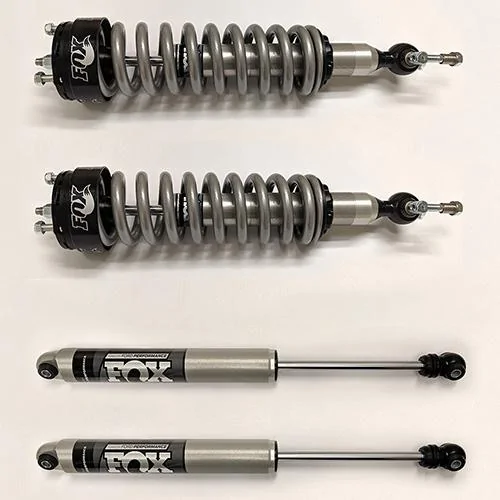

We would be remiss not to include the new Ford-branded Fox kit. I just plunked down $1,495.00 for this at my Delaware dealer's Parts window yesterday. The sales staff said it will take about two weeks to arrive. Installation is extra, naturally, and will be paid at the time of service. It gives you a two-inch level to the front, meaning there will still be a slight, one-inch forward rake to the vehicle, which is the look I like. I plan to keep the stock 18-inch B.A.P. wheels and the stock Hankook Dynapro ATM tires, at least for the time being. I am hoping the kit will smooth out some of the roughness in the ride and tone down the "Ranger Bounce." I don't go off road much, but the (slightly) improved approach and break over angles will be welcome for rough roads, winter storms, and odd road obstacles. I also decided to go with the Ford kit because it will be installed by Ford, under warranty by Ford, and it will not jeopardize any of the Ford warranties that I signed for at purchase (and pay for every month)! In a word, "Ford"!

Nice , I'm looking forward to seeing your truck in 2 weeks as I'm considering this lift as well.
