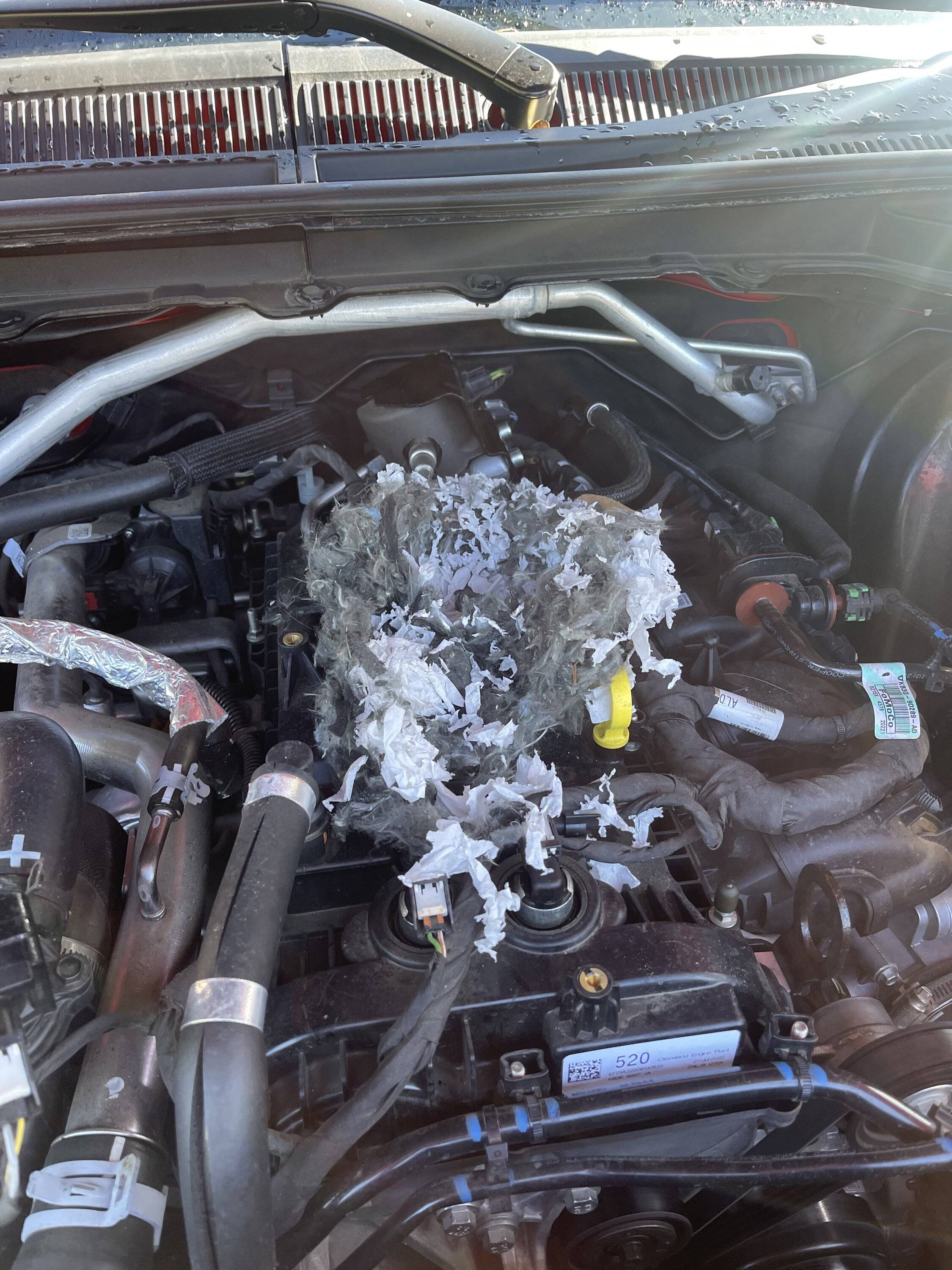

I have tried and used coyote urine on my Ranger. I found that they had chewed my engine cover. There's another post about that, but the engine heat drys it way too quick and it's not meant for rodents.

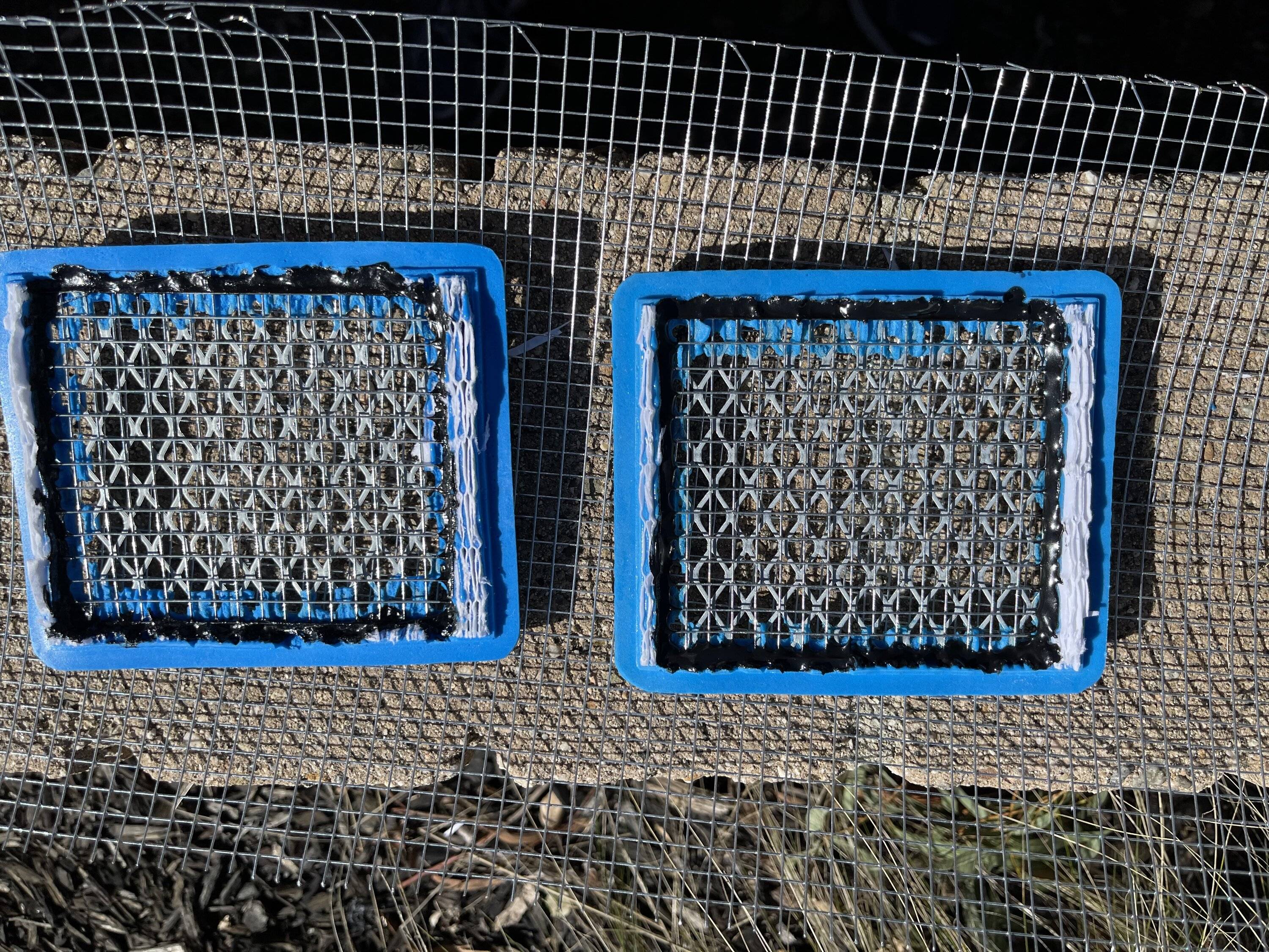

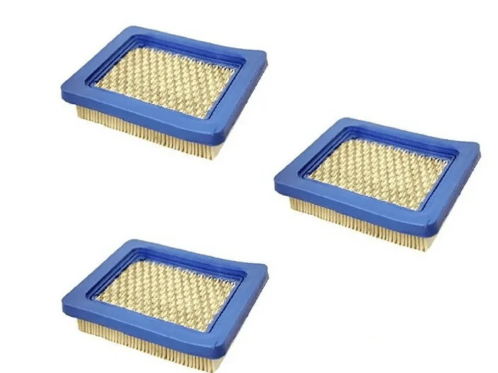

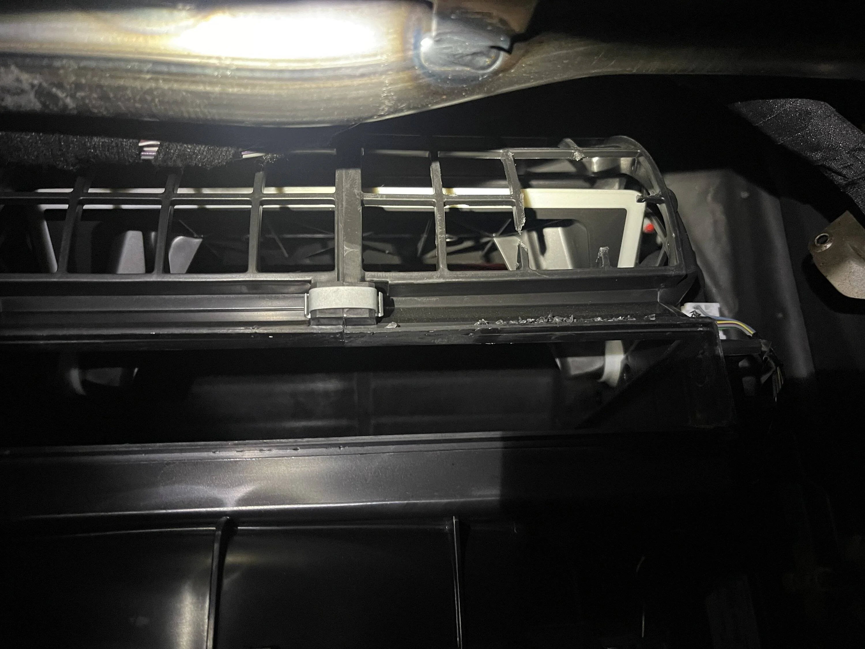

Although the Oreily's filters give it a better appearance (looks wise) as I debated doing the same.
... as it is a GREAT idea and find for filters that fit in those access holes.
O'reily's here in NC wanted $10 each for the filters.
I purchased a 3 pack of these filters from online Walmart for $14 with free shipping. Nice reasonable price. Carefully removed the filter material with razor knife, then glued the 1/4" 23 gauge steel wire mesh on the back side. Installing them today. Been meaning to correct this for a while and I like the solution. Thanks for the pointer.
UPDATE
The screens are installed. They do not fit snug but they cover the openings. I was hoping the openings were flat so that a good seal would be easier to make, but the ridged opening faced out. So to simplify the installation I used Scotch 3M Exterior double sided gray tape. When placing the screens I had to insert them through the outer left hole going up (facing the truck). Then move the screen to the interior hole and press it in place. Did not take long to do and I am confident the rodents will not get past the screen.
I wish I were taller. I need a step stand just to reach the firewall!

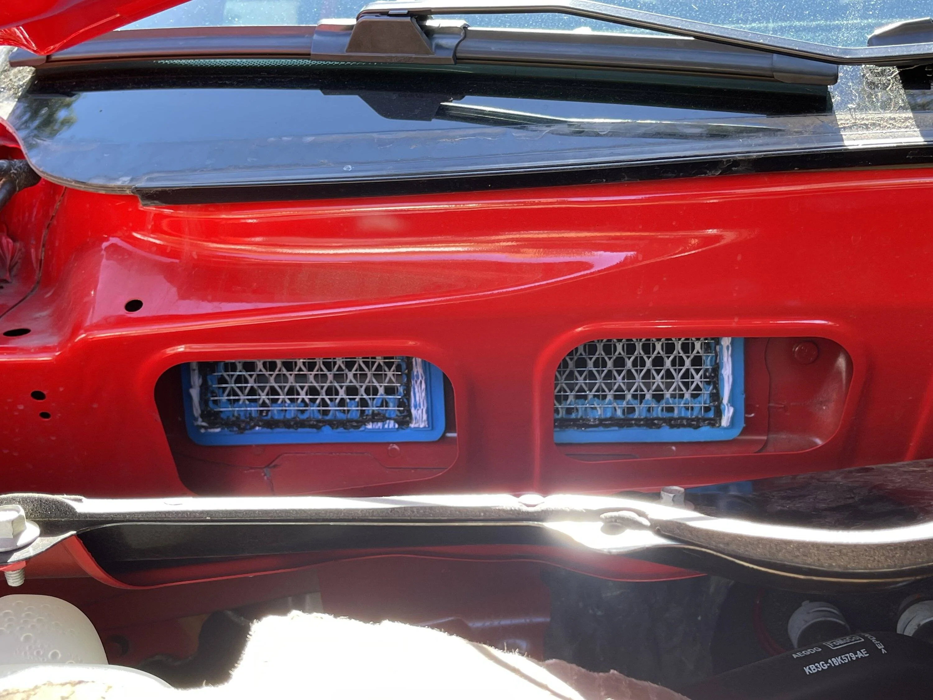

I just did this modification 3 days ago.
I agree working space is very limited.
You may also want to do the rear vents behind the back seat. I've had rodents enter there on a camping trip in northern Vancouver Island. I haven't done that myself, but I will be doing it soon.
Here's my after pic for the cabin air intake vents. I used standard aluminum screen from Home Depot and butyl tape, which I had on hand for RV repairs.

Was wondering how the rv tape held up overtime with the engine heat
EJH
Ed
Oct 7, 2020
932
1,832
Subarus, 2021 Ranger
Great.
Remember this opening is pretty far recessed, and behind the plastic cowl. It isn't seeing much engine heat. Example is run your HVAC on outside air with no heat or cool (eg 'low' temp setting and that it the temp of the air coming into this intake. I like butyl tape because it can stand up to moisture. If I did this again, I would use some Dynamat sound insulating tape instead. It is basically butyl tape with a metal coating. I think that would be more rodent proof.
I went a similar route. Used this mesh from Amazon:
6 Pack 12×8 Inch Wire Mesh Screen, 20 Mesh Stainless Steel Mesh, Sturdy No Rust Metal Mesh Screen for DIY Projects, Cage, Vent, Garden, Window Screen, Filter Mesh https://a.co/d/6vf45LL
Cut a sheet into a trapezoid shape and hand bent as best I could to form it to the shape needed. Then used flex tape on the left and right edges. Left the edges with burrs all around so that it might discourage a mouse from trying (thinking maybe anti-mouse barb wire?). The burrs did a good job of giving me multiple diabetes blood stick checks....
The other filter suggestions just seemed too cumbersome. Until a plug n play kit becomes available I think it's a 95% solution. Thank you for the suggestion, @EJH. :thumbsup:
Now to remember to a) spray the engine compartment with Grandpa's pee and b) check the filter once per month to see what's up. Or, hopefully, what's not up.
