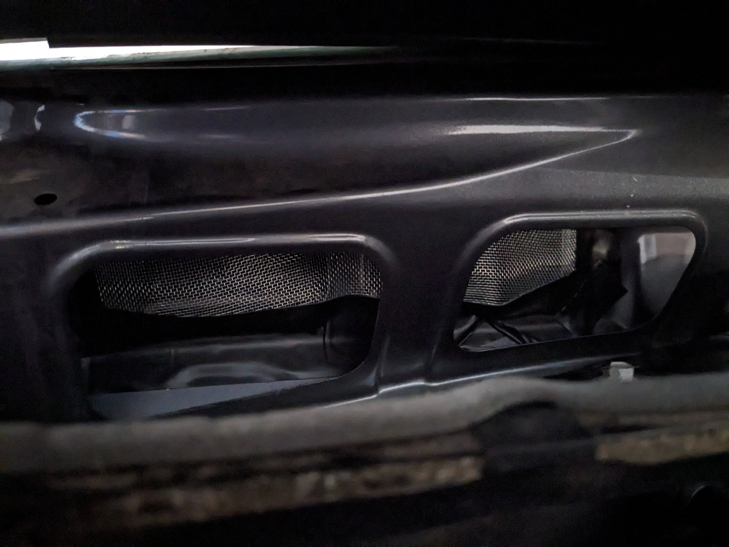

I just did this modification 3 days ago.
I agree working space is very limited.
You may also want to do the rear vents behind the back seat. I've had rodents enter there on a camping trip in northern Vancouver Island. I haven't done that myself, but I will be doing it soon.
Here's my after pic for the cabin air intake vents. I used standard aluminum screen from Home Depot and butyl tape, which I had on hand for RV repairs.

Hey Nate, do the two flat vents behind the back seat also. That is where I have gotten mice in the cab camping. Thankfully the camping mice seem to dine and dash, without taking up residency. They do leave quite the mess though.
I haven't found a good write up on accessing these rear vents for a crew cab, only for the super cab. I can reach up under the liner and feel the vents. The crew cabs have a lot of cloth liner and plastic trim behind the back seats. The super cabs have the vent directly exposed when the rear seat backs are removed. When I get around to screening the rear vents, I'll post my learnings.
Unfortunately, the tape is a weak link. Mice will eat right through it.
How would you attached metal screen material? Others have used HVAC ducting tape, which I am not sure will stand up to moisture like butyl tape.
Short of using metal rivets or screws, I am not sure how one can attach metal screen without some kind of tape. The butyl tape I use is pretty solid stuff. It is used to seal the roofs of RVs.
I‘m well familiar with butyl tape. I used many rolls of it to attach vapor barrier to the concrete walls of my crawl space when I enclosed it. Great stuff, but no contest for a mouse.
Maybe something like this butyl tape with metal mesh built into it. I don’t know how hard it may be to work with.

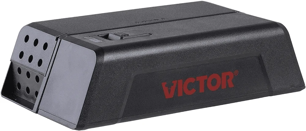

My anti rodent kit....With my stray dog deterance in the background. lol!
Yep, mine took care of the whole neighborhood for years. But I didn't take her camping or anywhere else that might be infested, how about smell or other deterrents? Maybe rat-rap music?
