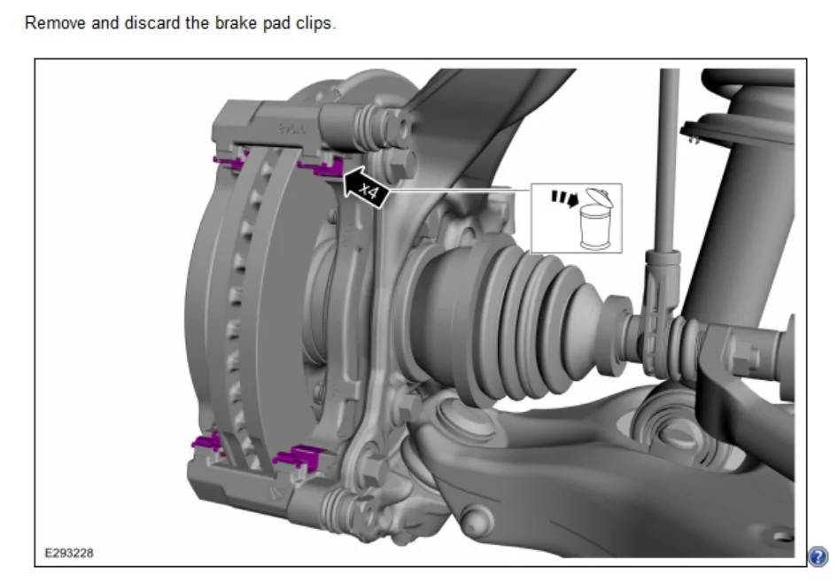

Leave it?
Have you removed the brake pads to make sure that they were installed correctly? Are the 4 anti-rattle brake pad clips installed correctly?

Leave it?
I have personally not, I had my mechanic take it apart a second time. I guess I should to check it out. Maybe order a spare set and swap them out to see what happens.
9,605
45,992
He may have simply dissembled them to make sure nothing was sticking and put things back together….incorrectly….again. There are two ways to find out - take it to a different shop and explain what AT thought might be the initial problem, or do it yourself.
