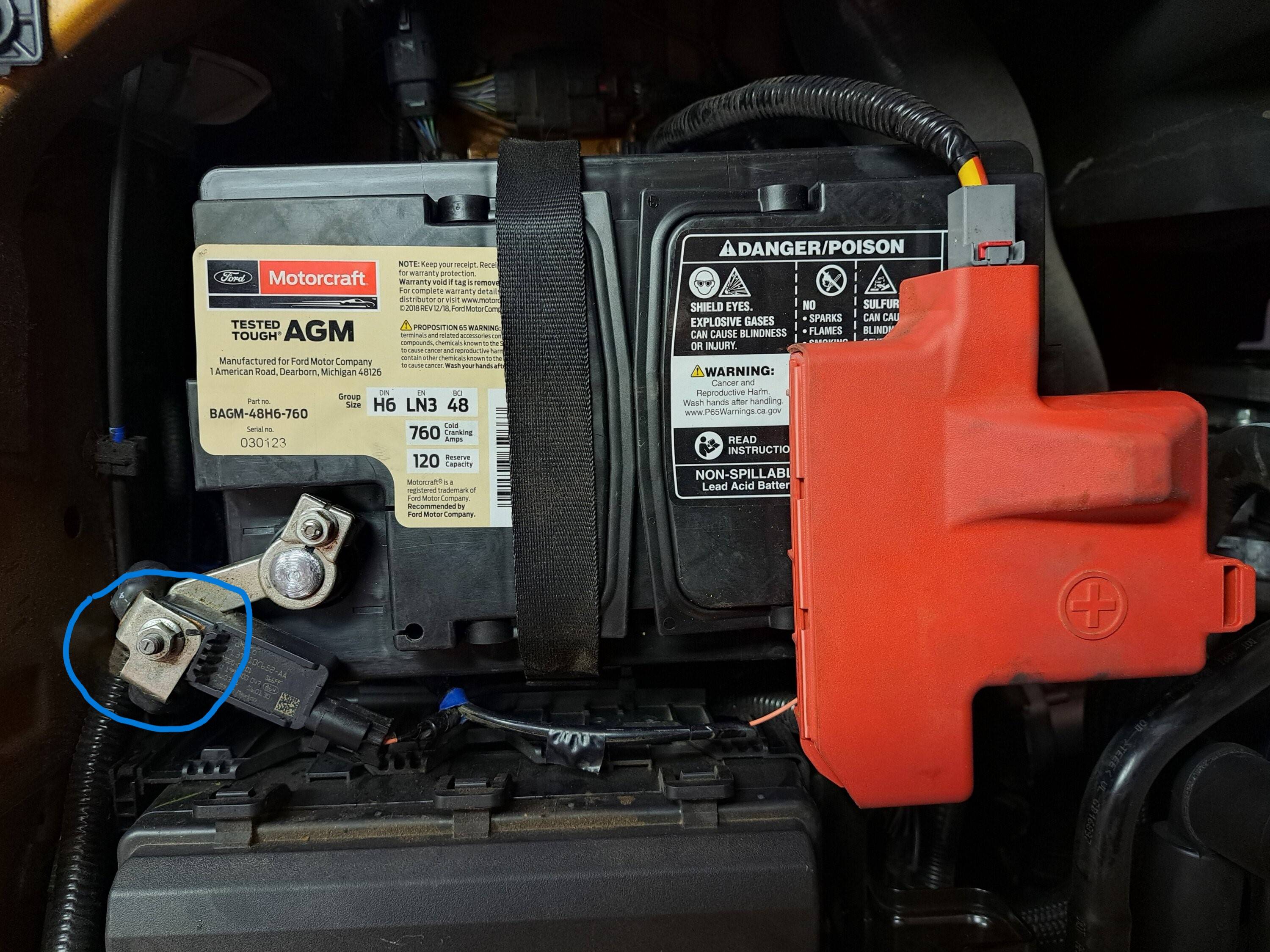

Depending on where you hooked up the bed lights.
Did you connect the negative at the battery terminal or the opposite side of the BMS sensor?
Now this will only actually factor if the bed lights are set to operate with the factory bed light at the 3rd Brake Light. (Auto (On/Off) with the perimeter exit / entry lighting.
And how often you actually used the bed lights (with truck off)
The reason is the BMS sensor has to see a current draw from the battery to see the battery voltage has dropped.
If you connect at the battery terminal (itself) (-) side, the BMS sensor will not see it.
Any tie in to the battery itself for power. The (-) wire must be connected here or at the Body Ground
or the BMS (Sensor) will not see the current draw from the battery.

They were just under the nut and no they were controlled by a controller in side they'd stay on unless you shut them off but right now I might be looking to trade the ranger in when I pick it up tomorrow ☹ maybe look at a maverick or I found a Tacoma too. Guess I learned my lesson to not tune again.
