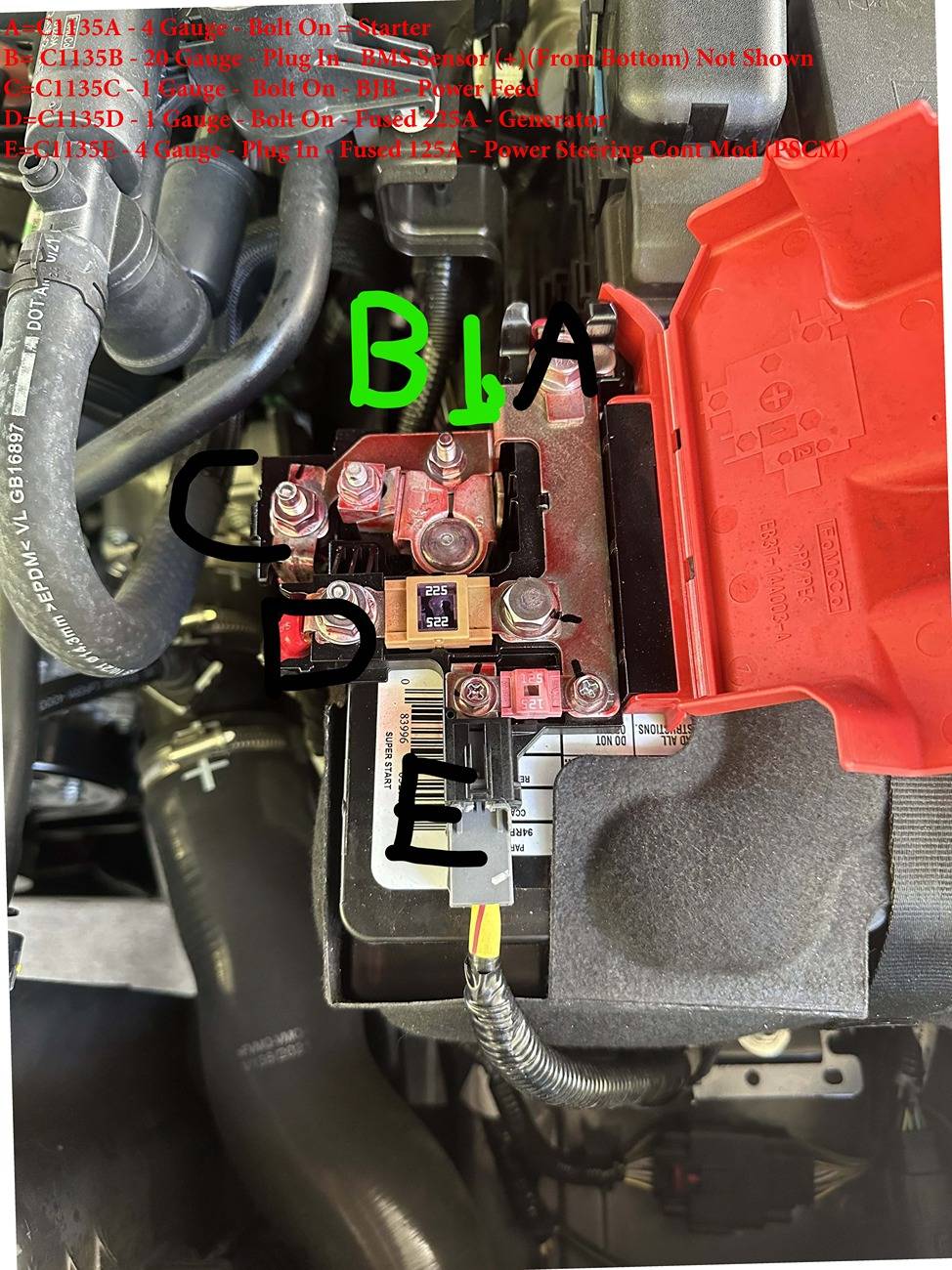

It's been mentioned before to check (wire check) for power, but no one has stated they found an issue with it yet.
The wire in question is (Item B) Not pictured (Mounted just below the B) on the side of the battery. It is a single wire connector that taps the BMFL for (+) input to the BMS sensor.
It's just a short run over to the BMS sensor, this is one of the items on the list that can produce that message.
So, with the alternator proven to be producing the correct voltage, the BMS sensor lost an input thus it is now transmitting a data loss on the LIN circuit to the BCM.
Actually, the manuals state if there if a fault with the BMS sensor or the LIN circuit the PCM will trigger the alternator into a (Failsafe) mode and only produce a 13.7-volt output (approx) Max.
That is why - I always ask the question (what the alternator is producing (Output)
I know the question is coming - and I think the reason why the same message does not show when you disconnect the sensor is that you are fully disconnected (disabled) and thus no transmission of data on the LIN bus to the BCM.
So basically, by disconnecting the connector you are stopping the (LIN) data transmission and using Forscan to disable is basically turning off the BCM (LIN) Bus circuit
Easy to check that wire - just disconnect the BMS sensor connector and Probe the pin for power.

The wire in question is (Item B) Not pictured (Mounted just below the B) on the side of the battery. It is a single wire connector that taps the BMFL for (+) input to the BMS sensor. "

The title of the post - Check Charging Sys (Message)
The cheesy connector (you found) - GOOD FIND - BTW
Feeds as an input to the BMS sensor on the negative terminal - it is the input ref for (+) voltage.
The BMS sensor itself is sending information to the BCM (Via a LIN circuit bus) various members have had that message come up and one of the (Test) procedures for that message is to check the BMS sensor connector for (+) power (The other end of the wire you are referencing) if the connector is not secure (which you found) then the BMS sensor is not seeing a (+) voltage input.
This (bad connection) just one of the possibilities that can cause the (Check Charging Sys) message.
So, for previous owners, it has been mentioned to - Check the BMS connector for a voltage input, none until NOW have found an issue or have reported an issue.
So, GOOD FIND and now there is another - CHECK THIS Connector to add to the list of highly probable causes for the message.
Note: A high number of reports for this message come just after a battery replacement, so this makes sense as you are disturbing that connector in this process and with it being somewhat hidden (not on top) and easily seen it can be very easy to pull up the BMFL and put stress on the connector (thus damaging its ability) to securely lock in place.
My side note for the BMS sensor is that some owners disconnect that connector to disable the ASS and or the BMS systems. They are disconnecting without any - Check Charging Sys messages.
