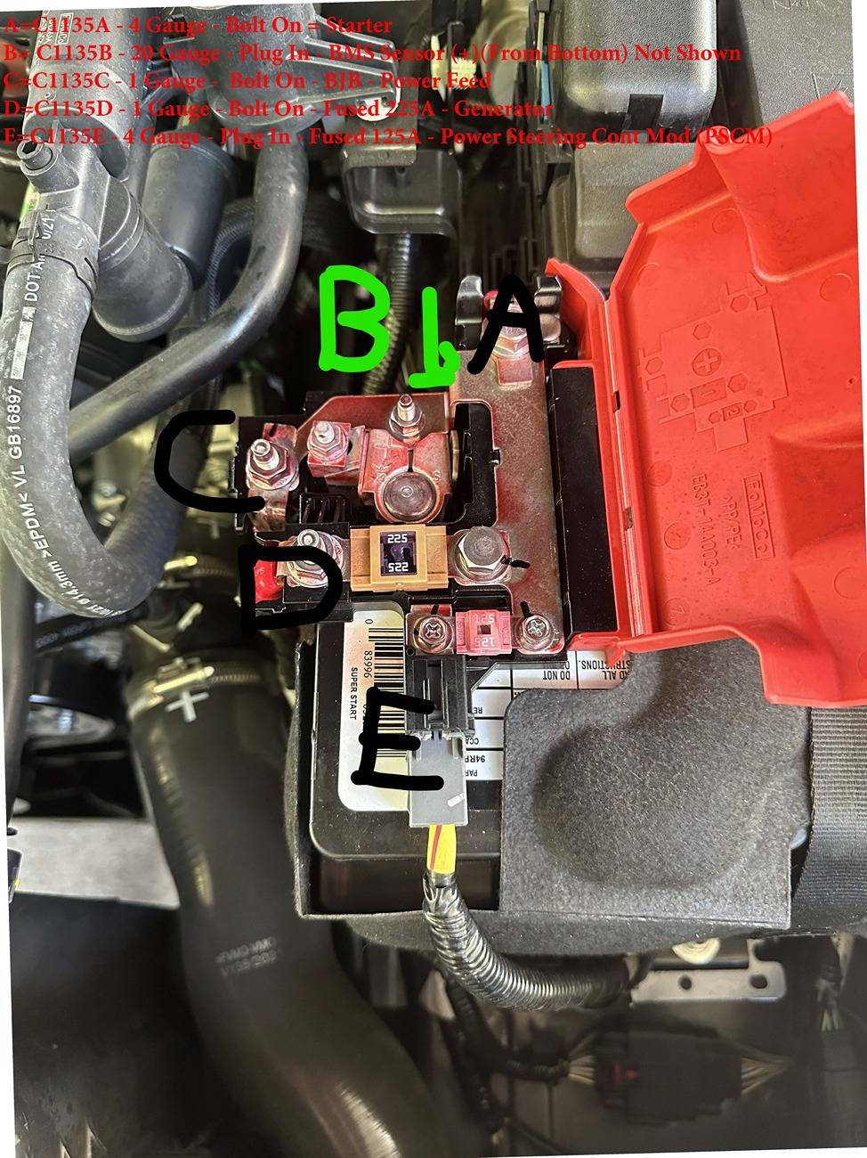

To be clear (took the terminal off) - you disconnected the neg term for 15 minutes or disconnected the CONNECTOR for the BMS sensor for 15 minutes with the engine running.
If you disconnect the CONNECTOR, you are bypassing the sensor and taking it out of the system, if the sensor was bad, the message should go away, however I am thinking you may be using a generic code reader, you need one to read (B) codes - Body and have a code you are not able to view with the code reader you have.
Now it is still possible as another mentioned, you simply have a lose connection at the battery terminals.
I will highlight looking at the (+) terminal (next to the terminal, does the little block (wedge) match the picture below?
Plus, I would get a meter and check for voltage on - BOTH - sides of the 225 Amp fuse, does the voltage match?
It is possible you have a partially damaged fuse and not allowing full voltage through it.
If all this is good, then a deep dive into the Live Data PIDs with a Bi-Directional control to force the alternator into MAX charge output, if this cannot be done then the alternator itself is bad or a control circuit issue (LIN)
There are various voltage checks that can be done, but the above are a basic start.
