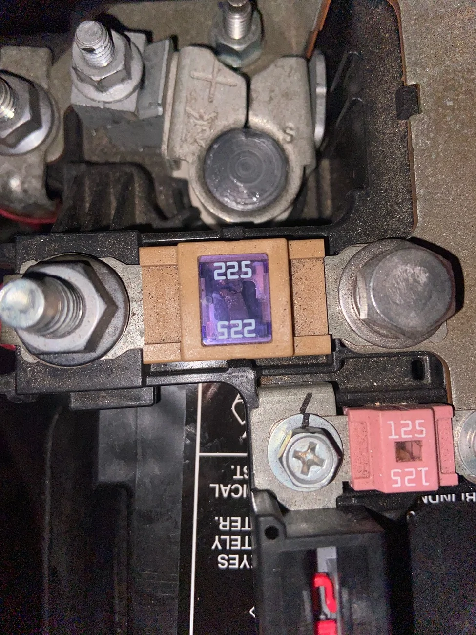

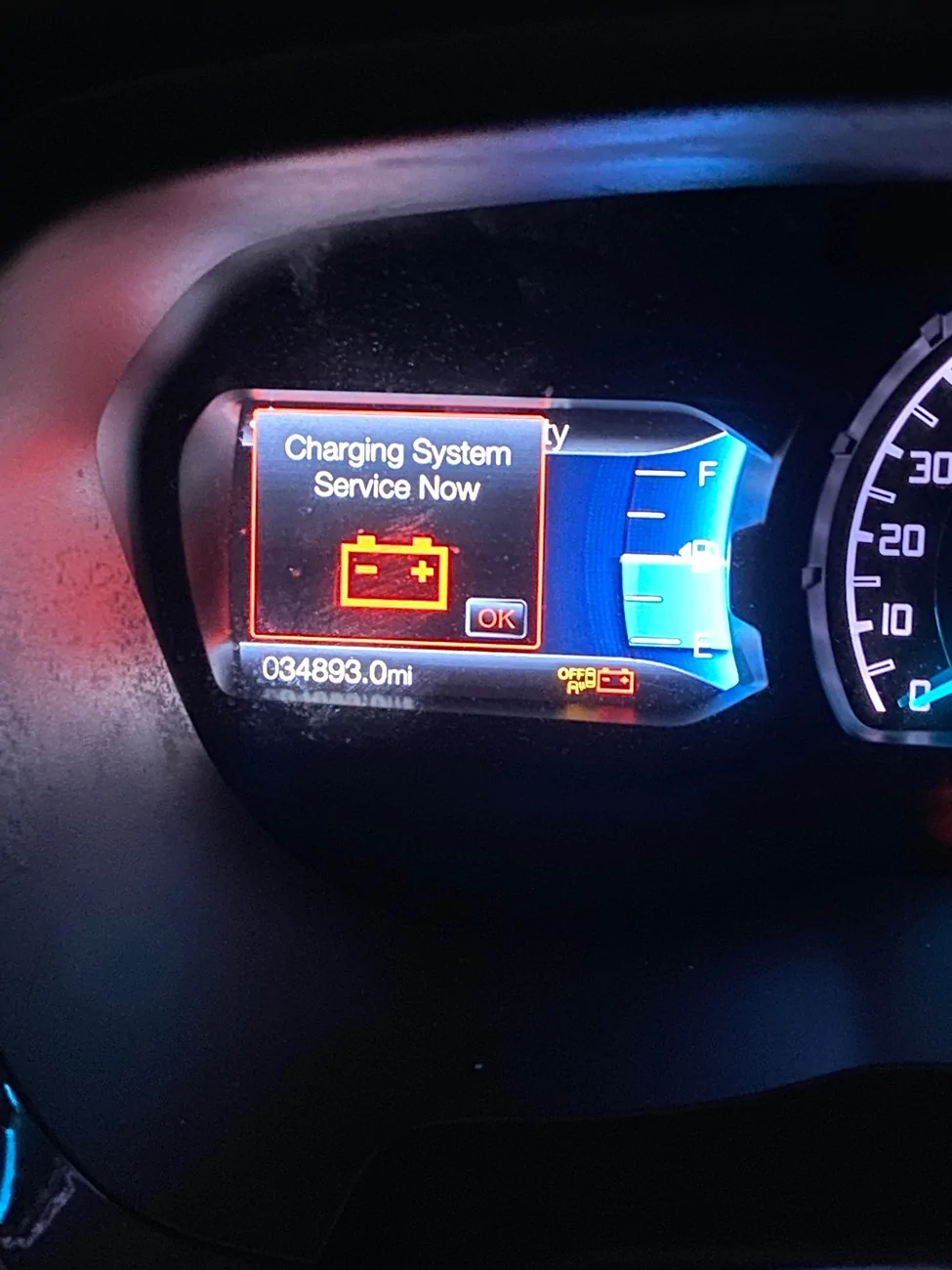

Hey guys first time poster long time reader here. I have a 2019 ranger lariat with a little over 30,000 miles (don't drive much) and I recent was jumping my coworkers car and he mad the mistake of having the positive and negative swapped! And I could smell something burning immediately, ultimately when I drove away I saw the Charging system Service Now message on my dash and I thought time to get new battery the one is got is 6+ years old. Get a new battery and still got message so I check the fuse to the alternator and it is clearly blown. I'll post some pics below. Guys I'm an idiot first of all and feel silly for asking but could I just simply replace this bolt on fuse with a part from Napa or do I need the full ford assembly

Here is a link to purchase that fuse. I've heard it is expensive to buy at a Ford dealer.

It appears Ford sells that assembly ($$$$) but @RangerBill has the good hookup for the fuse only, above.
Hoping @LevittownFordParts.com knows more. Hey Benny, does Ford sell the 225 amp fuse from the battery circuit breaker on its own or does the entire circuit breaker assembly (GB3Z-14526-A) need to be purchased?

Do you have a NAPA store near you?
They have the 225 Amp fuses in stock. PN: 782-1141
It may or may not visually look the same as the (OE) but it serves the same function.

It looks to be part of these assemblies
Non Tremors use
https://parts.levittownfordparts.co...ker-gb3z14526a?c=bD0xJm49U2VhcmNoIFJlc3VsdHM=
Tremors use
https://parts.levittownfordparts.com/oem-parts/ford-fuse-gb3z14526b?c=bD0xJm49U2VhcmNoIFJlc3VsdHM=

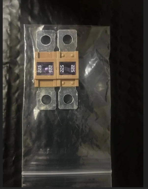

Just a FYI the link above for the 225 Amp Fuse is the actual OEM Fuse. ordered 2 to have on hand - I have another from napa but it's all black and no window.
