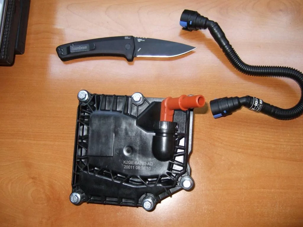

I really believe FORD put those ports in a terrible place with regards to service. If the PCV valve goes south (as they do), it is going to be hell to replace it.
It was a $40 part when I purchased it, with the PCV valve integrated into the plate, so the entire assembly must be removed. To do so, it appears that the intake manifold must be removed! I do not see a way to easily get to the those upper plate bolts that are tucked under the intake manifold.
Anyway, this is the oil separator plate and the original hose.
