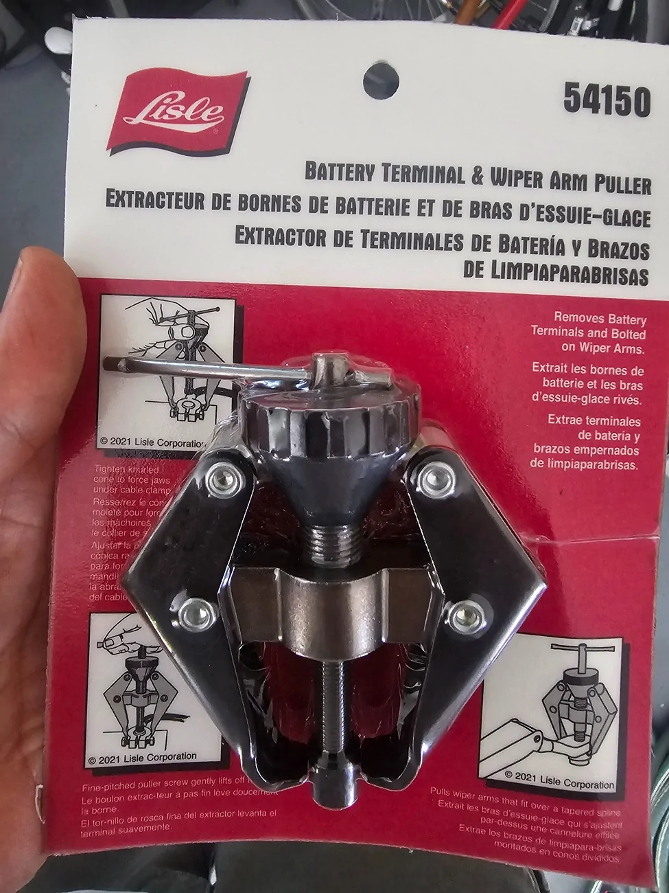

I need to get my wipers off to get the cowl cover off to rodent proof the holes in the firewall. Wipers will not budge & I do not have a puller. Have tried prying under the base with 2 screwdrivers & a 21mm open end wrench. No go. Any ideas??

Already tried that. Hence the frustration & post. Now I have to buy a Lisle Tools 54150 wiper arm puller that I will almost certainly never use again in my life to address one Ford screw up to address the bigger Ford screw up of the rodent access holes stamped in the firewall. Which so far have cost me $543 in passenger side airbag wiring harness repairs.

Mission accomplished. Would not have budged without this. There are very fine splines on the shaft & inside the wiper arm hole. Stuck super tight.
