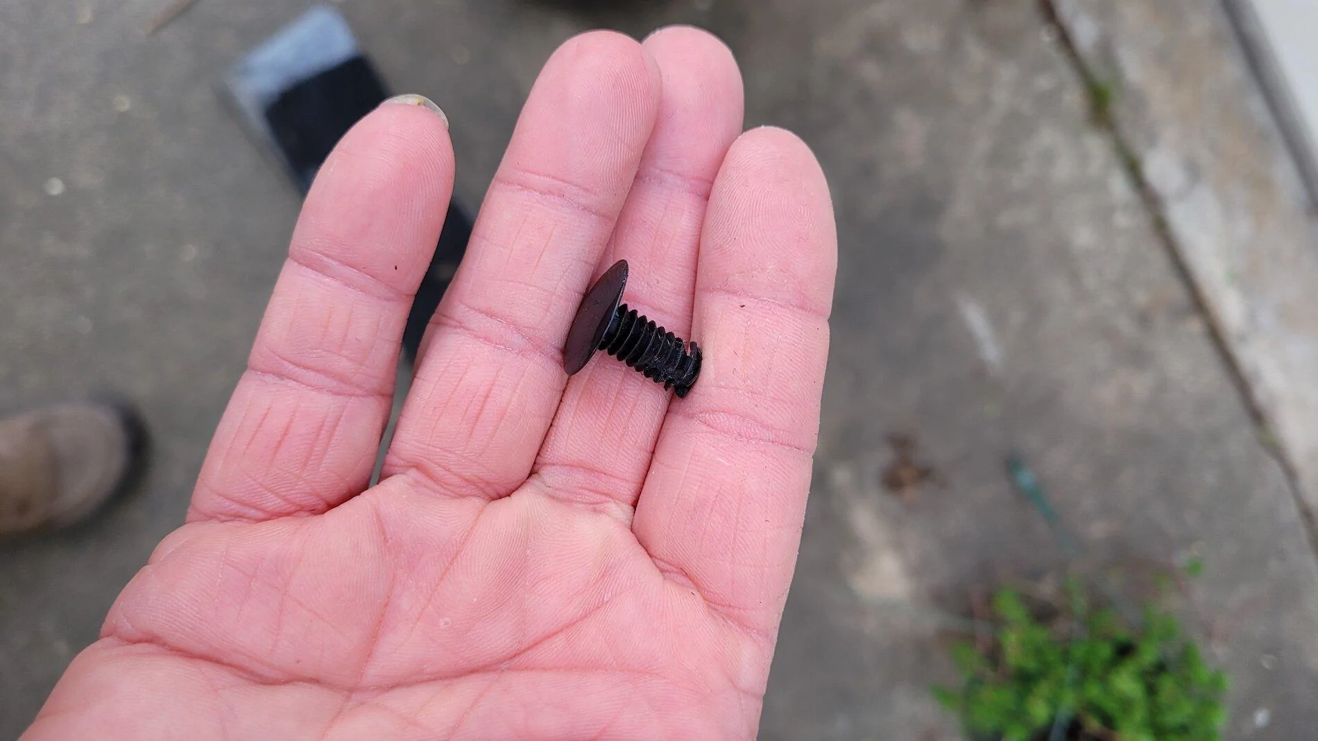

Talk about a complete and total pain in the ass to remove... So it's actually two separate pieces and secured with 3 plastic push pins on each section, but also some rather strong adhesive of some sort. Five of the six pins are easy to get to and clip with side cutters. Then there is one that is over the gas tank close to the frame. The only way to reach it is to lay on your left side between the muffler and drive shaft, then reach up and over the drive shaft and across the tank with a very small pair of cutters and feel for it.
After the clips have been cut then take a very long flat bladed screw driver and push up from the bottom of the carpet material on the outer edge of the bed to break the adhesive loose. It's not bad idea to try to work as much of the carpet loose as possible while your under there. Once a good section of carpet is loose get into the bed and pop out the large oval plugs at the front of the bed. Take a long pair of needle nose pliers and work the carpet to the hole and pull out enough to expose the hole that the outer most plastic pin was inserted into. I used a paracord tie down with a carabiner clip on it and fed it down between the cab and bed then fished it out the hole to secure it to the carpet via the pushpin hole and pushed the carpet back through the hole so the cord and clip are hooked to it to pull the carpet out. Let me say that the glue they used is some stout stuff and did not want to let go even with part of it already separated so you have to pull extremely hard.
This one of the plastic clips

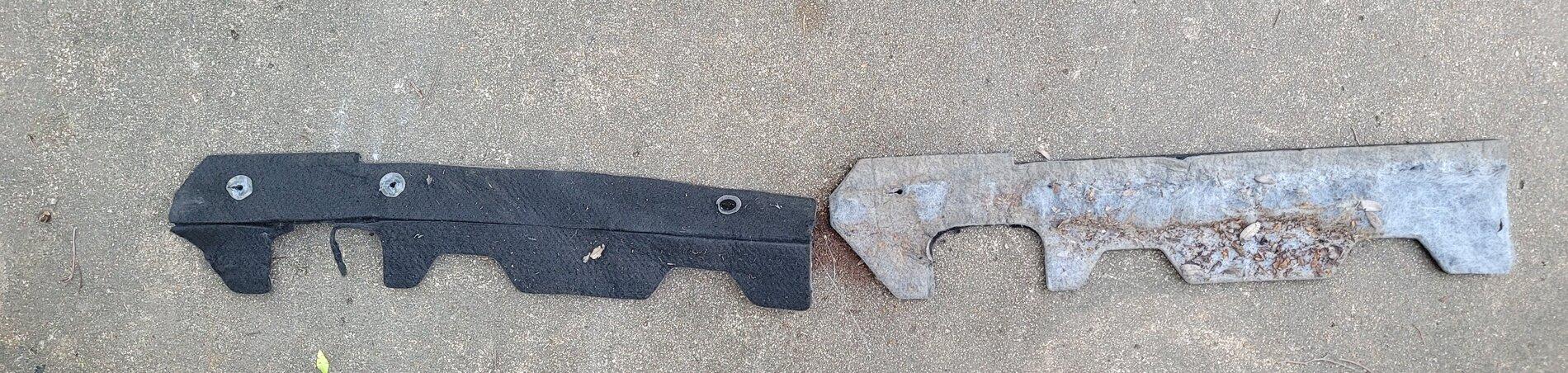

The carpet pieces. The one on the left is from the driver's side of the truck and the other is flipped over to show the back. Both of them while dry had a very strong musty/mildew scent to them. You can also see where the carpet was preventing debris from passing as well. I don't know if this was the cause of the intermittent musty mildew smell in the cab after a rain storm or not.
Initial road tests are inconclusive as I was not able to detect any difference in noise in the cab. So I have no idea why these were installed in the first place.

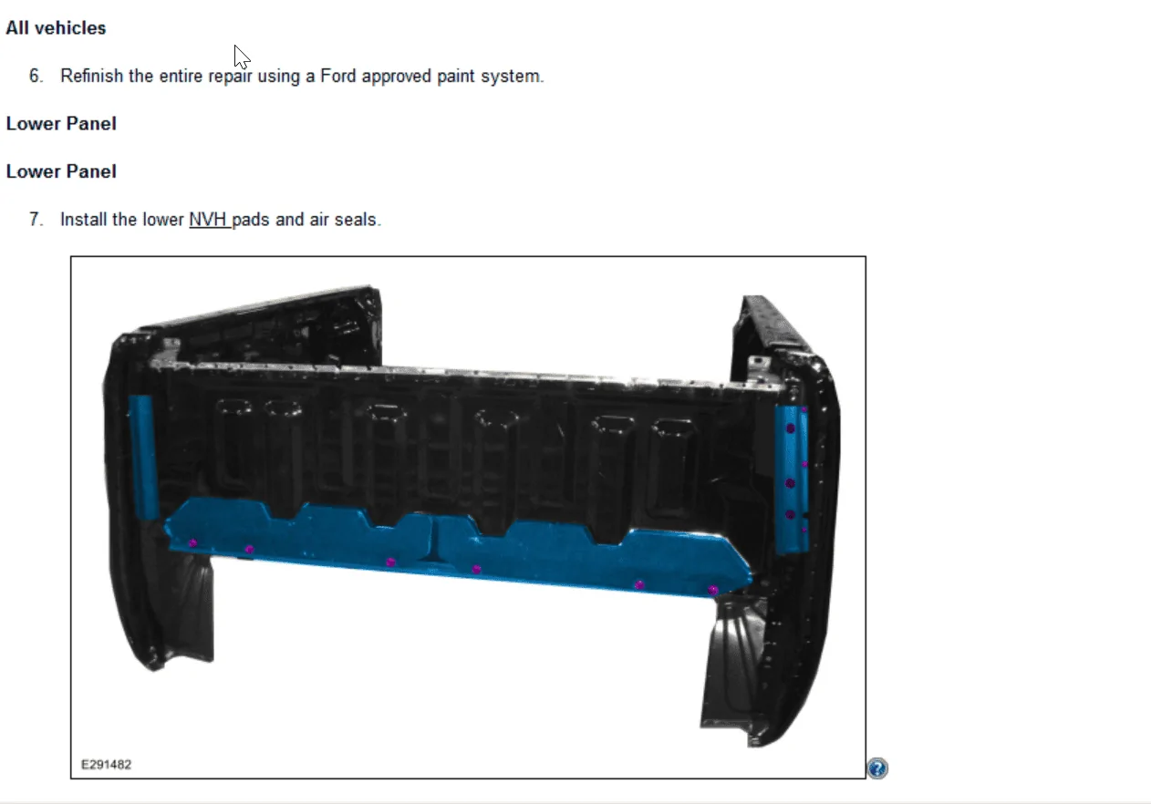

Here's the answer - 2019 Shop Manual, In the Body and Paint, section 501-30, Rear End Sheet Metal Repairs
NVH stands for noise, vibration and harshness

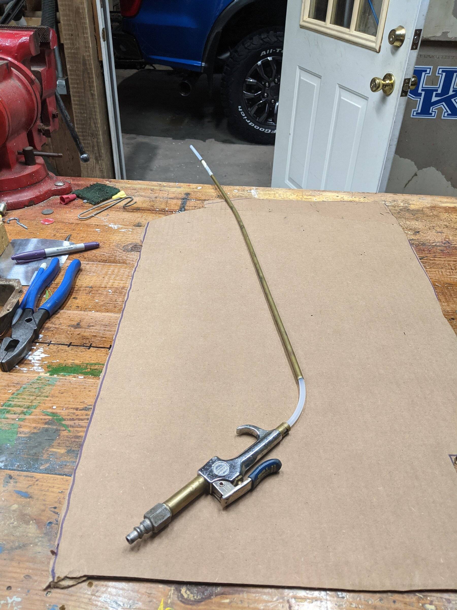

First of all Thanks for posting this. After 3 years owning my Ranger It never occurred to me to look there. Sure enough mine also had some debris, I think I got most all of it out, and now that will be part of my wash routine.
This modified blow gun helped clean that area out.
