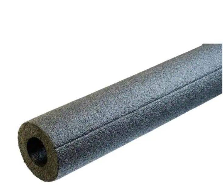

I should have posted my $2 solution back when these threads were active but didn't. This one and the one regarding the "fabric" at the bottom of the bed catching leaves.......
6' long 3/4" foam pipe insulation in Magnetic Grey did the trick for me

Ok I'll bite, what do you do with the 6' piece of pipe insulation, stuff it between the top of the bed and the cab?

I used the pipe insulation shown above and stuffed it across the top edge of the bed and the cab, turning the ends down about 4 inches on each side. Problem solved.....
sorry, yes as 2020xlt said, stuff it between the cab and bed to keep out snow, debris etc.
water will find its way through, but it has served me well through two winters and a fall.
