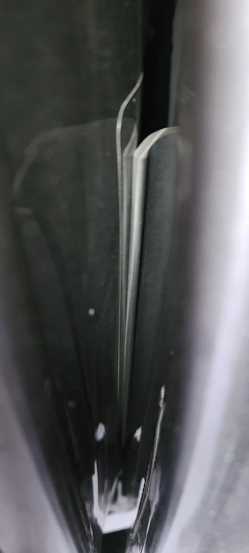

Update: there are rubber flaps that span the gap between the bed & cab. They’re definitely the source. But, it looks like they’re aligned and installed properly. They just make a ton of noise. Seriously!?

I had an issue with a Tacoma. It was the rubber flap that spans the gap between the bed and cab. The dealer used a silicone lube on the rubber flap and the noise was totally gone. In my case, it was just one side that needed the lube.

Any updates on this problem and a definite fix? I have the same squeak coming from between bed and cab. I lubed all the rubber between the cab and bed and it didn't work.

I had this early in the winter. Sprayed some Fluid Film on the river between the cab and bed and the noise never returned.

Mine just started this in the cold snap here in Oklahoma. It's 100% these rubber seals.
