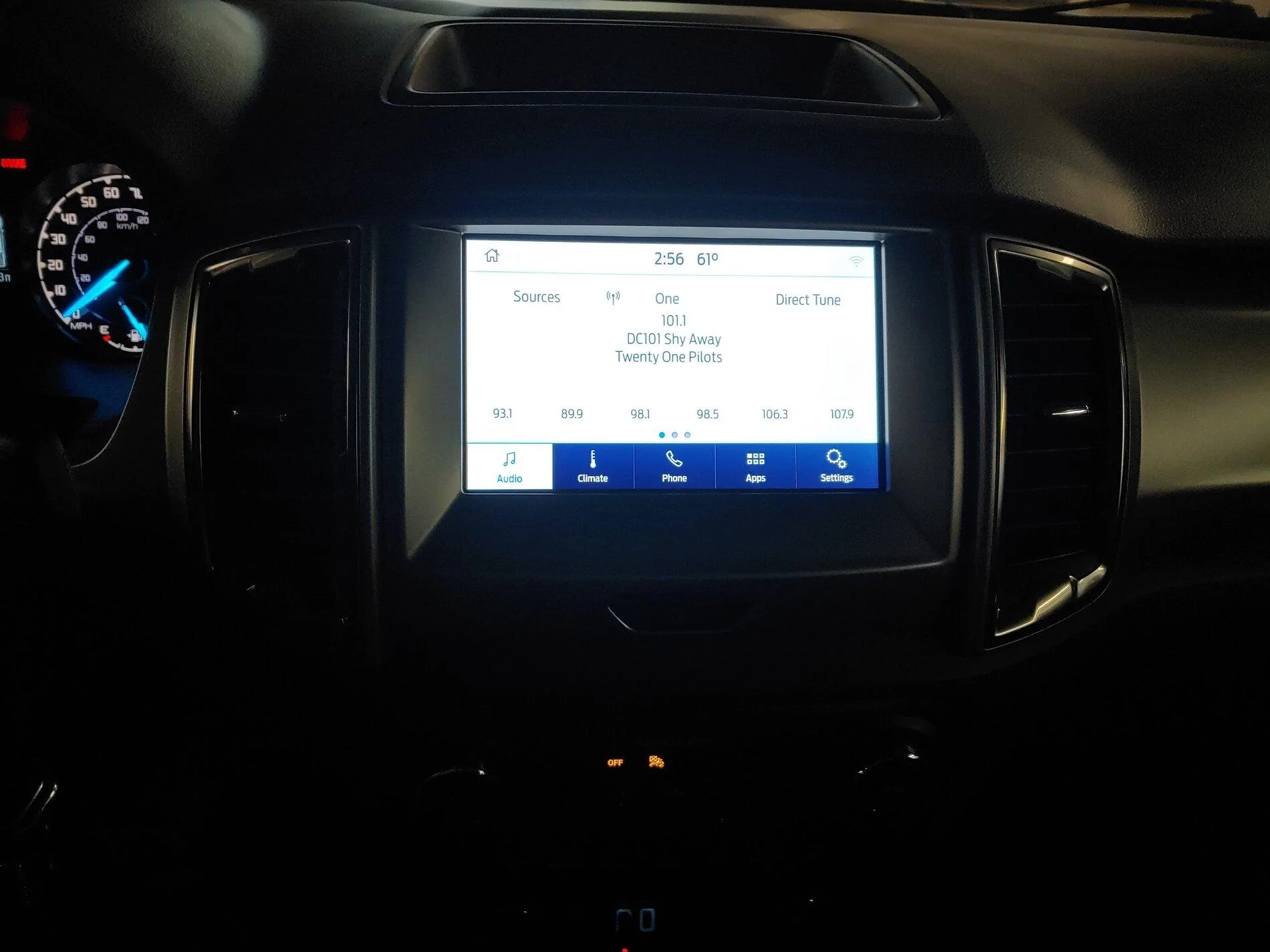

Can't seem to change the back screen. There is no "edit wallpaper". Even if I choose the color from 1 of the 4 color options - it stays the same.
I must not have the Sync radio that is shown on Youtube. My screen looks like this:

I figured out the SYNC screen setting.
I set for "night mode - all the time - and then picked one of the 4 blue choices. So much better now.

"....How did you set it to night mode all the time?..."
NIGHT MODE
What I did was tap Settings then swipe screen options left so
I could pick Display
Tap Display
In Display in Mode hit arrow and pic Night mode
Factory setting on my truck was Auto
In Background in the display settings I had 4 different blue choices
After I picked Night mode I chose one of the blue choices in Background and now it is set for night mode all the time with my choice of the Blue backscreens.
NIGHT MODE
Tap Display
You can always put it back
Good choice. Night mode is the first thing I selected after the last Sync update set it back to Auto and I was blinded by the daytime colors.
