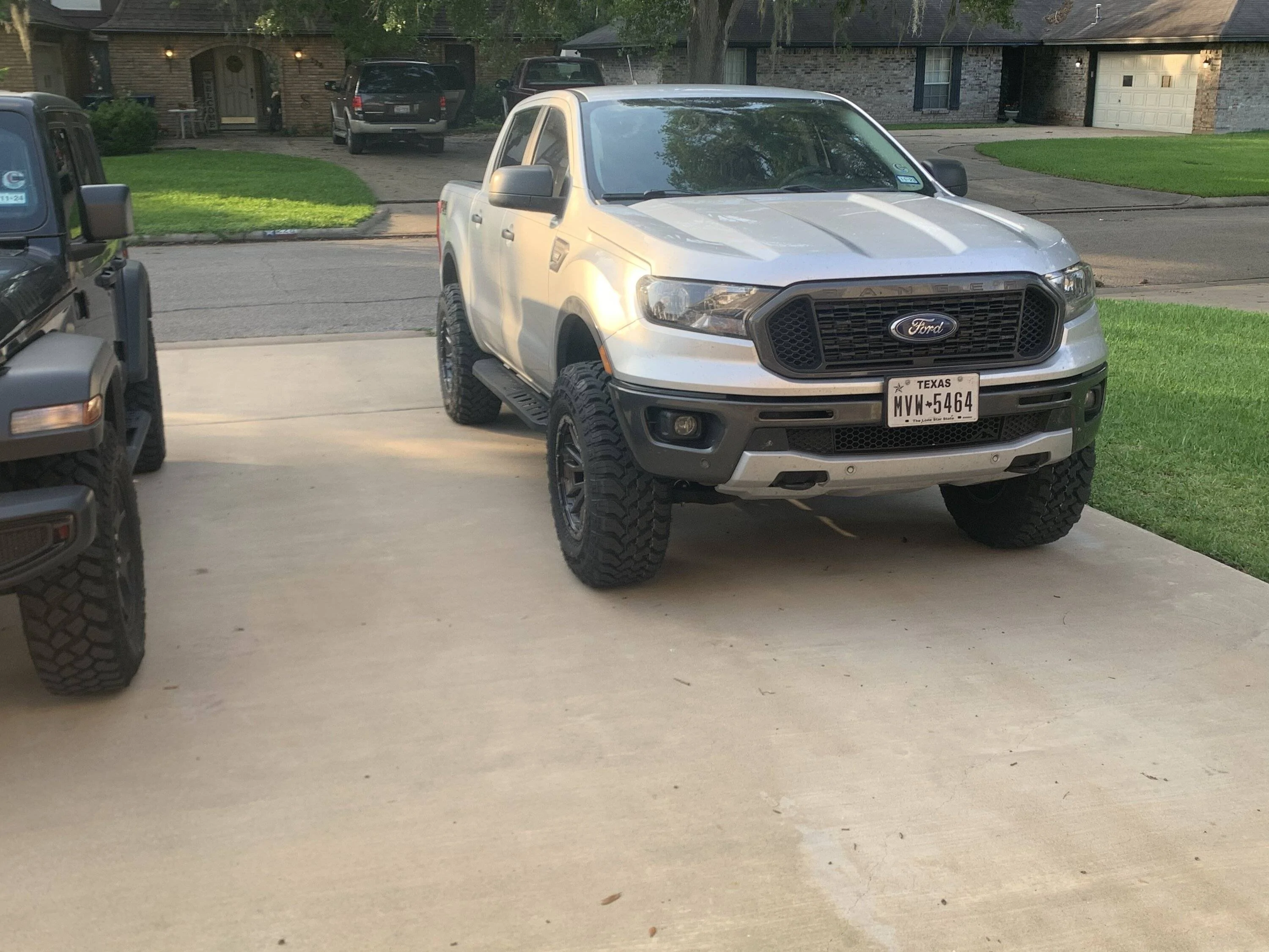

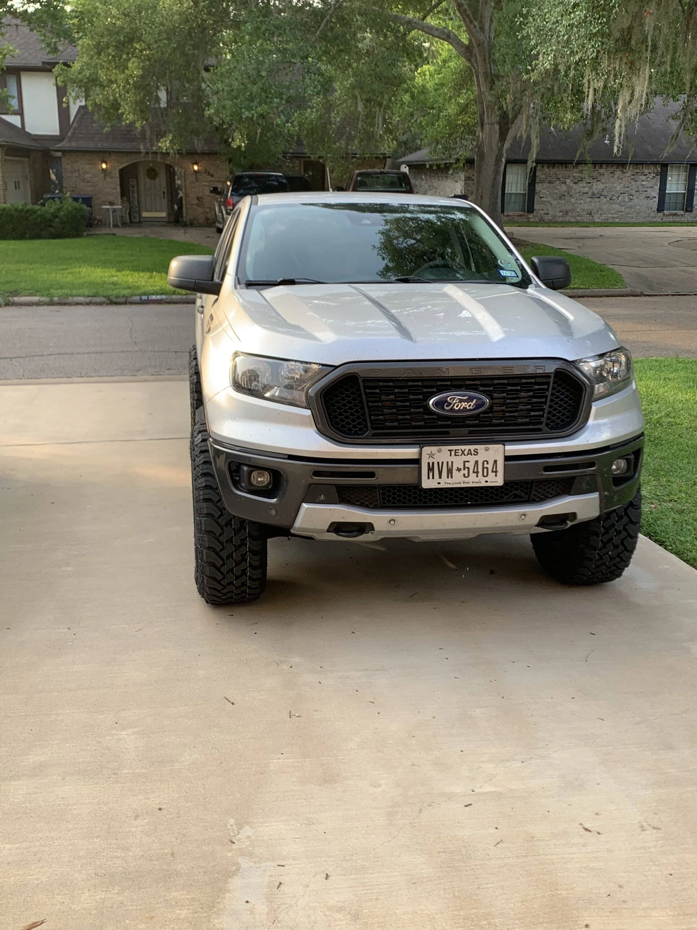

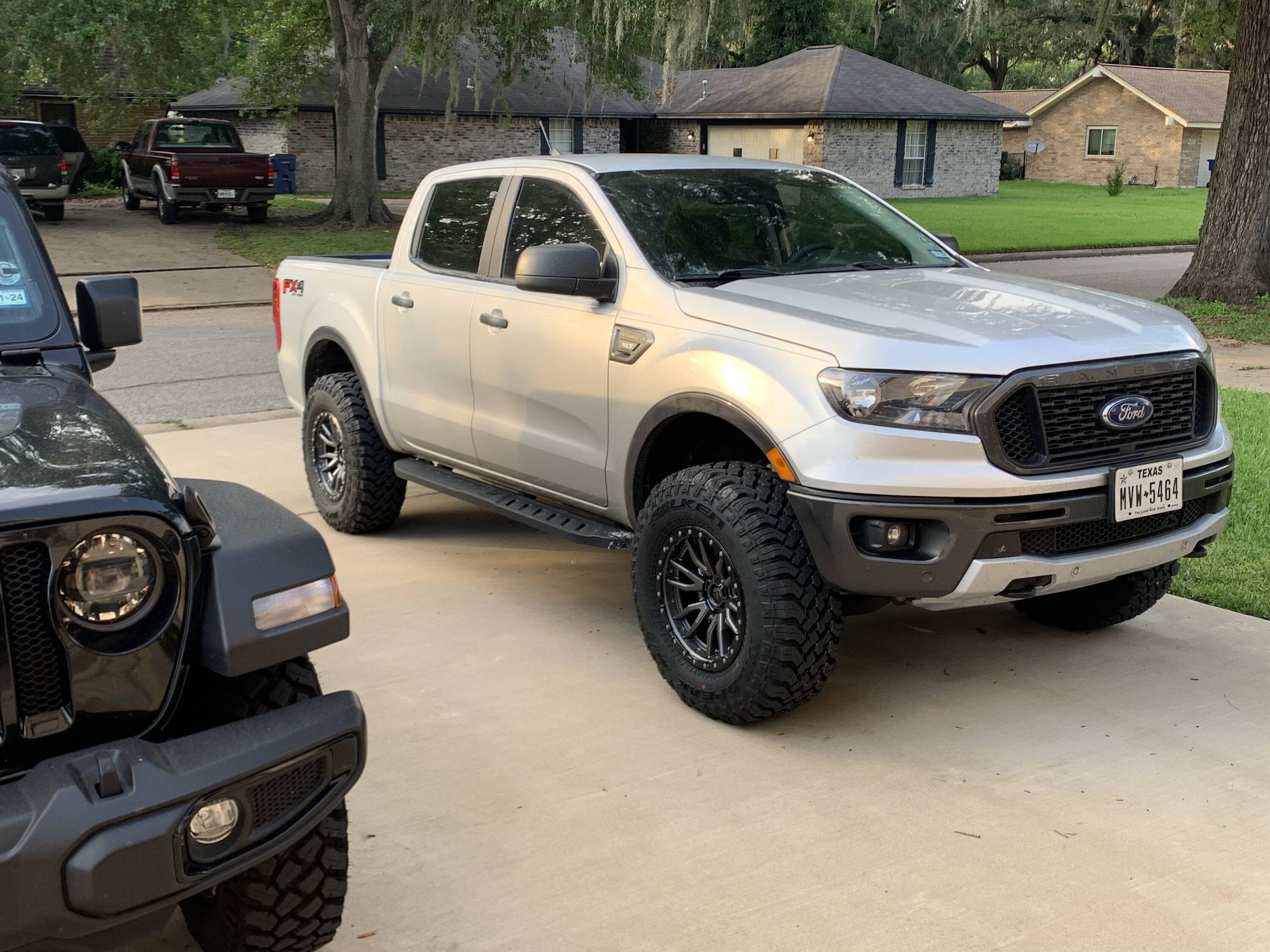

Here is mine with the Bilstein 2.5” leveling struts, Falken Wildpeak MT LT285/70/17 and Fuel Rebel 17”x9” with +1 offset. Crash bars will need to be removed or aftermarket bars installed. Mine has a slight rub at full lock but Falkens tend to run bigger in size. Toyos run on the smaller size so it should be good.
