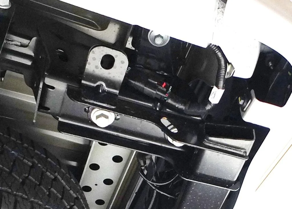

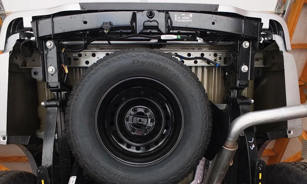

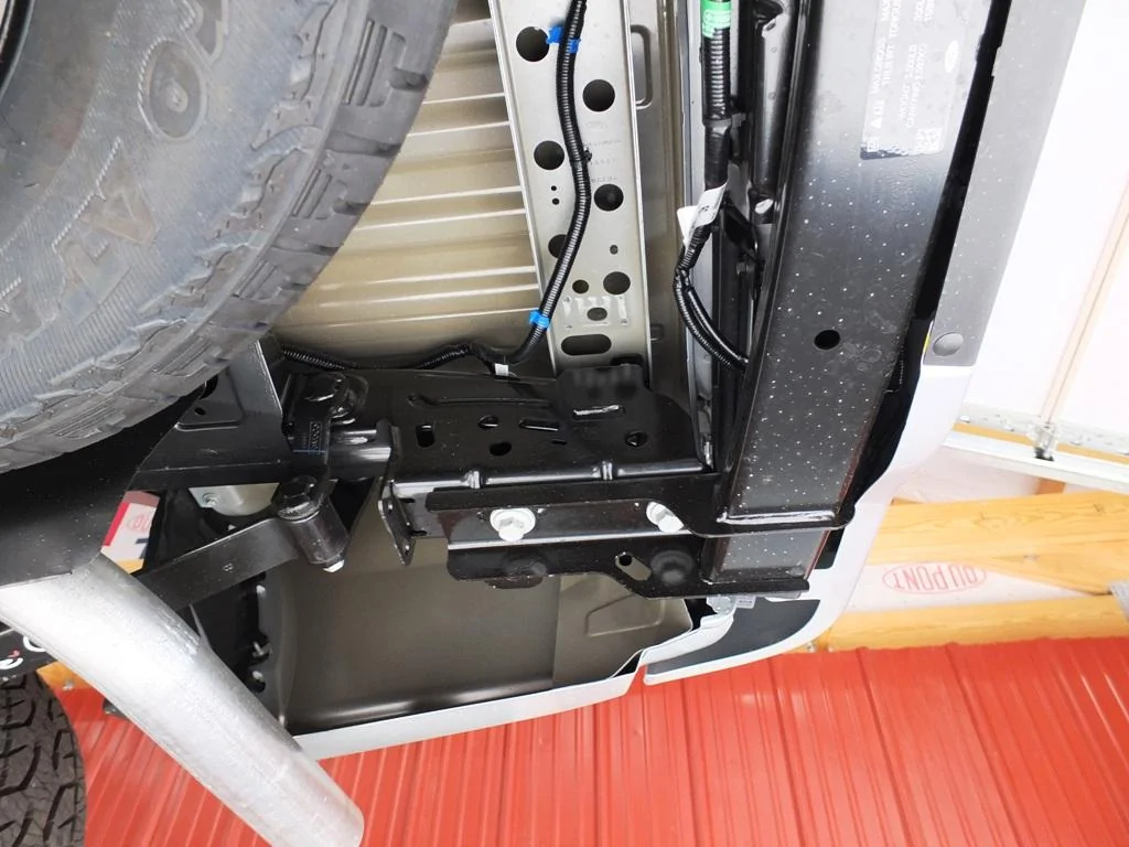

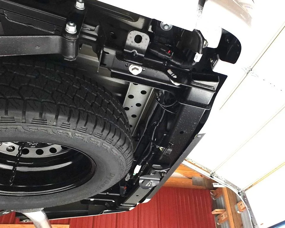

While I agree... have you seen the extensive bracing Ford has done on the rear bumper? I was impressed, I bet you will be too. It's basically a light duty structural hitch that the bumper ball attaches too.
Here are some photo's:

Impressive, but I still wouldn't use it for recovery of any kind. Just start doing the math and you'll see why. Without googling the exact number, what does the Ranger weigh? Betcha it's more than the 3500lbs the bumper is rated for. Then factor the extra strain if your stuck. There's a damn good reason tow truck drivers hook onto the frame. Unless there is a dedicated recovery point, of course.

The bumper mount on the ranger is attached to the frame.

Just because its attached to the frame, doesn't mean a damn thing. Its rated for 3500lbs, period. Your truck weights more than that, period. The bumper mount and a ball is an unsafe recovery point. Clearly you are not understanding this. Do what you will, but please make sure the camera is rolling when it happens.

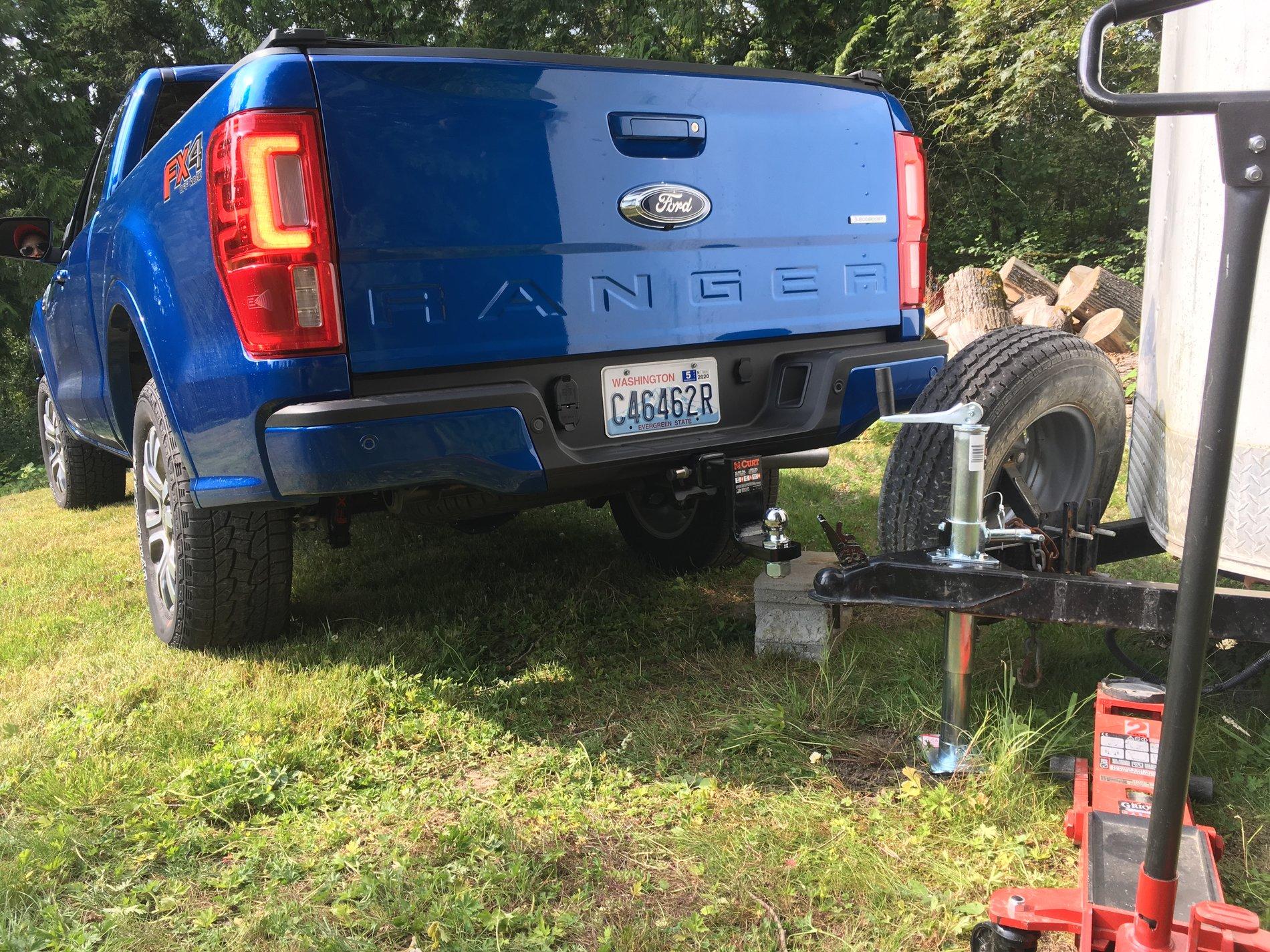

LightingBlue
Sep 17, 2019
173
331
Seattle
Fx4 off-road Larit Supercab (2019)

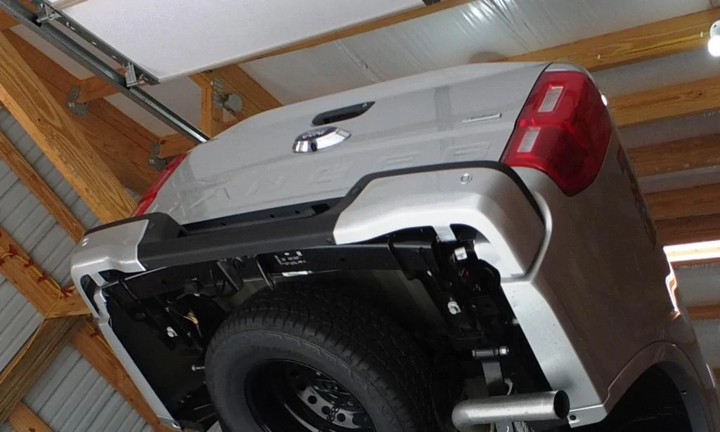

I'd like to point out one other factor that hasn't been brought up, a ball on top of the bumper is about 9' off the ground (not really, but it's ridiculously high for the size of truck the Ranger is), you're going to be exerting a ton of downward force in addition to the lateral force to tow with that.
Unless your trailer hitch is also 9' off the ground (an exaggeration, but it should be equal to the ball height), trying to tow anything from a bumper mounted hitch is pointless.
We're using a 6" drop-hitch for our 5,000 lb trailer and there is still a bit of rake to the trailer. Obviously this is a small little single axle trailer, but unless you're using some stout car haulers with a massive hitch height (which the trailer alone will be darn near the 3,500 lb load rating for a bumper-mounted ball) then, again, what is the point of a bumper mounted ball?
