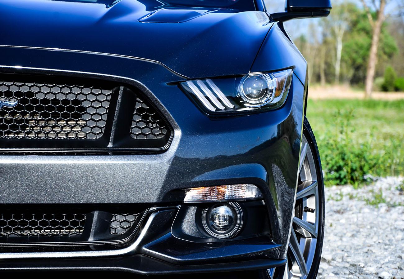

below is my Mustang after it had a ceramic coat applied to it in Oct 2016. It’s relation to our trucks is the paint. It is the Ford Magnetic Grey. I told the sales guy to not let the dealership prep the car for me at all. I would take care of it. I did the paint correction, but then handed it off to a professional detailer that was certified to install Modesta ceramic finishes. IMHO, Modesta is the best ceramic out there, you and I can not buy it, it has to be installed buy a certified detailer on their product. That detailer has become my friend now and has given me great advice over the last 4 years. Each time it gets washed, it gets another spray coating of carpro reload to freshen up the ceramic coating. My Mustang still looks like this and the coating is still working after 4 years. It has a 10 year life span according to the manufacturer,

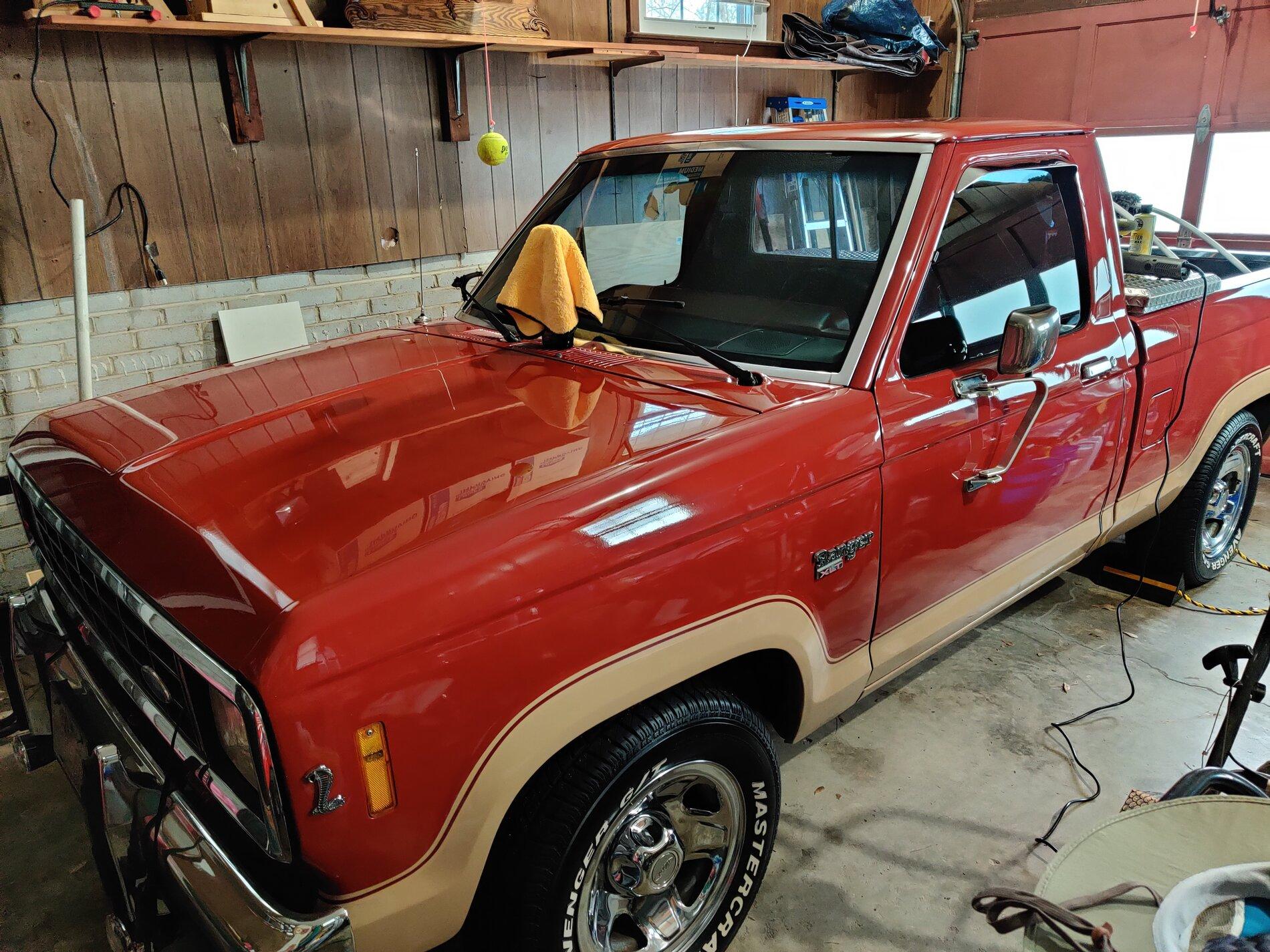

I cant detail anymore like I used to when I was in my 20s lol the pain for a week afterwards is killer now. I did both cars by hand last week., still hurting. ? I need to compound and polish the ' 11 Jetta but I'm breaking out the PC 7424XP for that

I hate to attempt CPR on an old thread, yet I'm not a fan of creating duplicates either. I have bone spurs in both shoulders so I'd like to protect my shiny new black finish but not suffer for a week afterwards. I've never owned or used a polisher and the options are dizzying. I get it rarely is worth it to buy cheap stuff but unless you are making money with tools, it rarely makes sense to buy premium stuff either.
What is the difference between the round polisher with side handles and the ones that look like an angle grinder? Is it just that one is easier to control or provides more comfort? Am I correct in assuming you just use them to apply polishes and/or wax ... but hand buff each off? The ceramics all seem to have their own applicators so I'm guessing that is all by hand.
The round polisher with side handles is more than likely a rotary polisher. A huge learning curve and very unforgiving if you mess up.
An angle grinder style is usually going to be the dual action polisher you hear about. Easy to control and a much shorter learning curve.
I use a chemical guys TorqX as my weapon. Cheap and works fine with their and lake country pads. I did the 87 over 3 days with it, and I feel fine. But I'm in my 30s with no health issues. You'd probably want to have a nicer unit to keep the vibration injuries to a minimum. Cost goes up with comfort.
