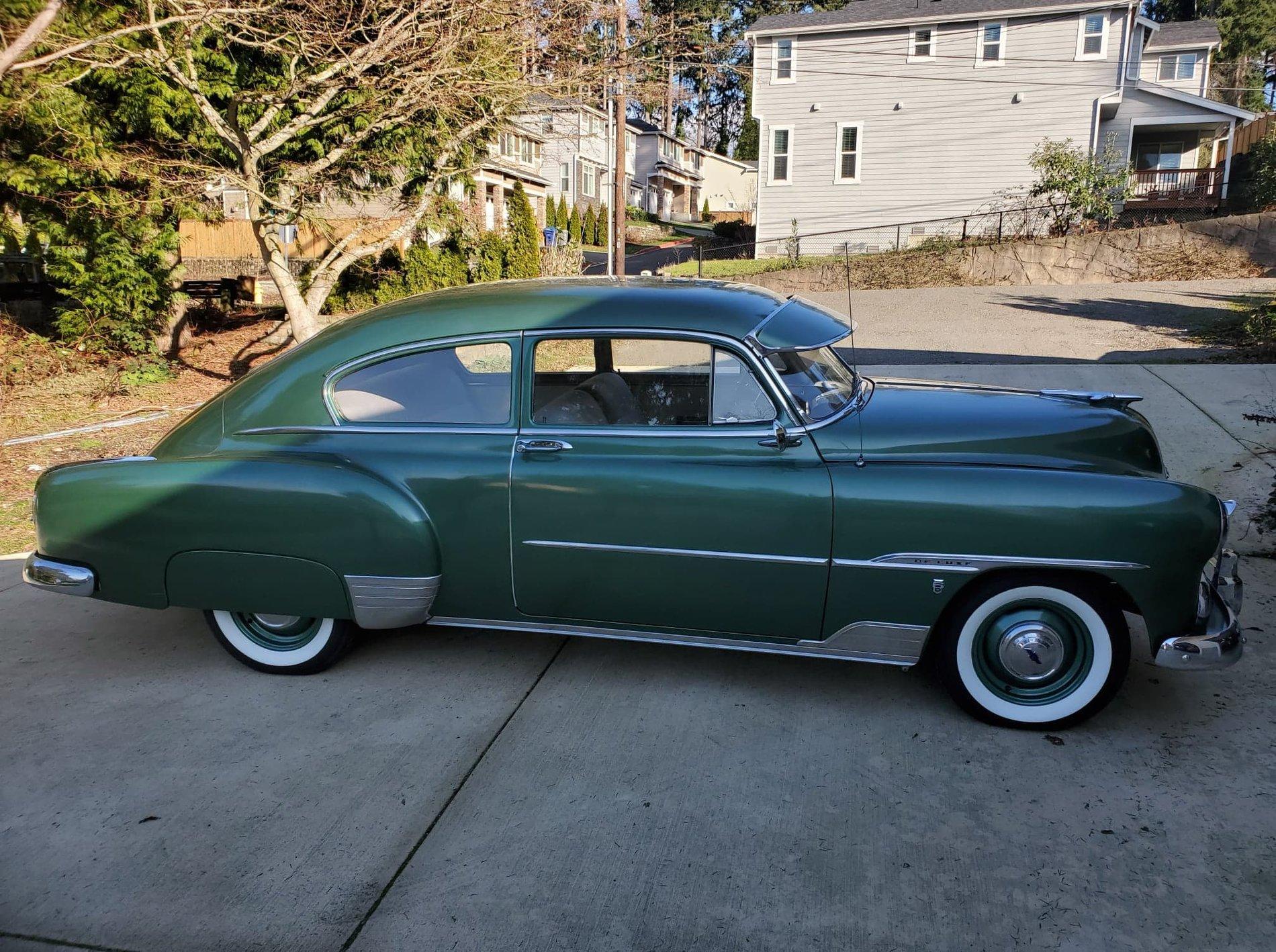

For those who think that their orbital is only for painted surfaces, there are oh-so-many-other reasons to have a good orbital handy. And personally why I do NOT want to have a large-throw orbital pattern (which is another topic entirely)
Last weekend I decided to blow up my spine and do the chrome and stainless steel polishing with the handy Porter Cable 7472 orbital. Concrete floors and I no longer get along, but as i'm dropping this car 4" very soon, I didn't want to deal with this when she is slammed.
Car to be worked on, my personal 1951 Chevrolet Fleetline;

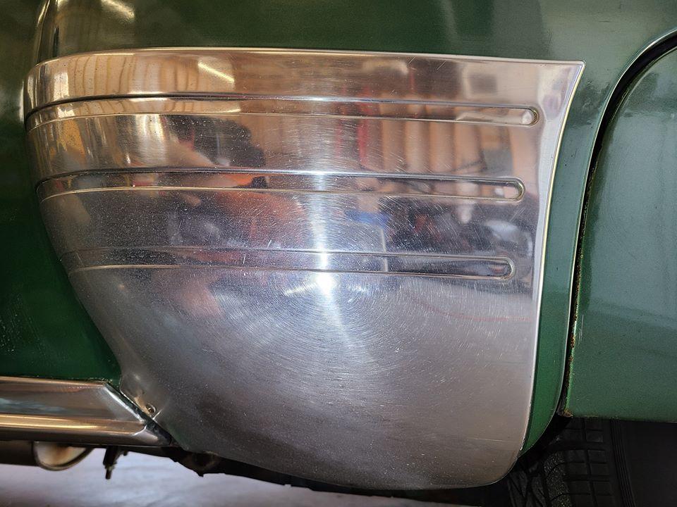

Gravel guard with just steel wool and acid wash to clear surface contaminates (Stainless steel)

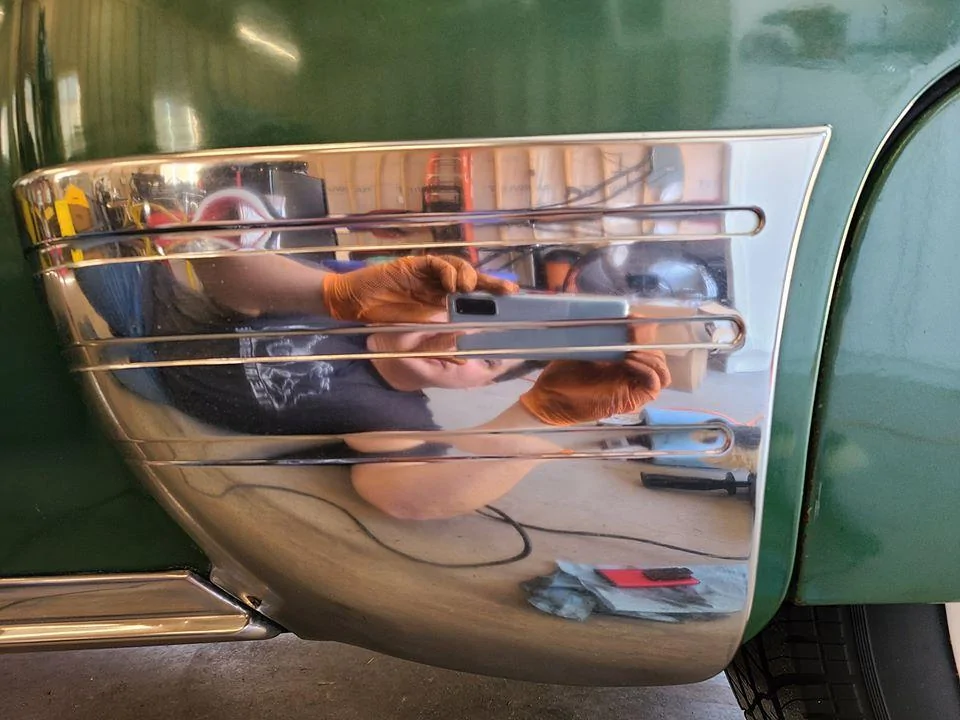

After 2 stage polish with 2 stages of wool pads

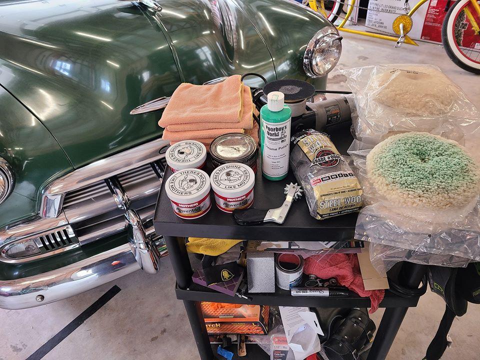

The chrome & stainless steel polishing kit. Could use a few more chrome polish compounds, but it works well enough on the '51 Fleetline

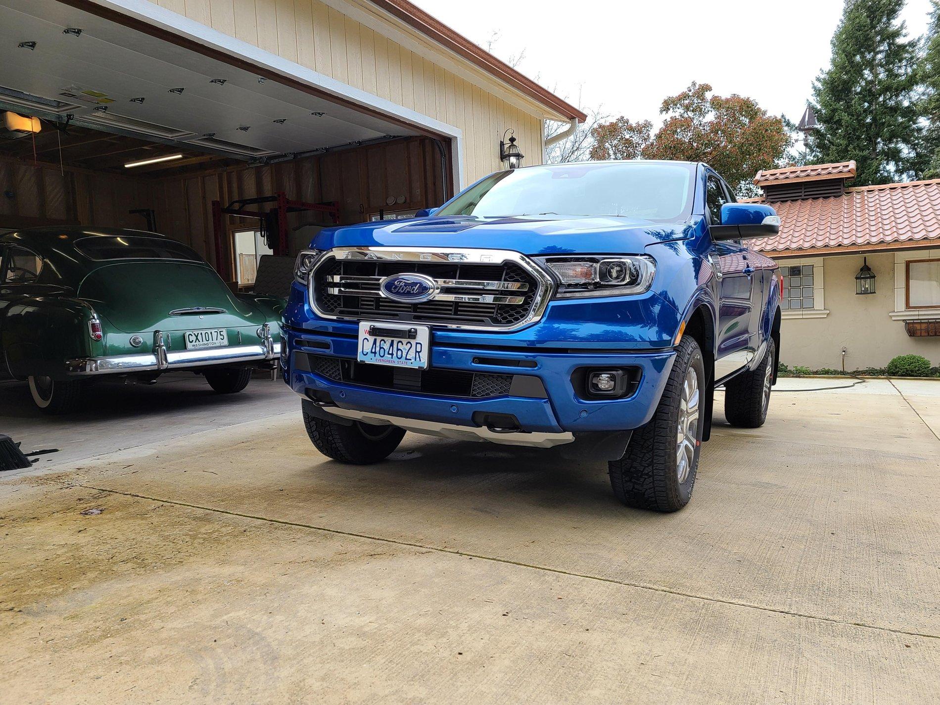

If you want to follow some other adventures in detailing which include the Ranger, here's our thread on the truck.
SCAB build, Seattle WA

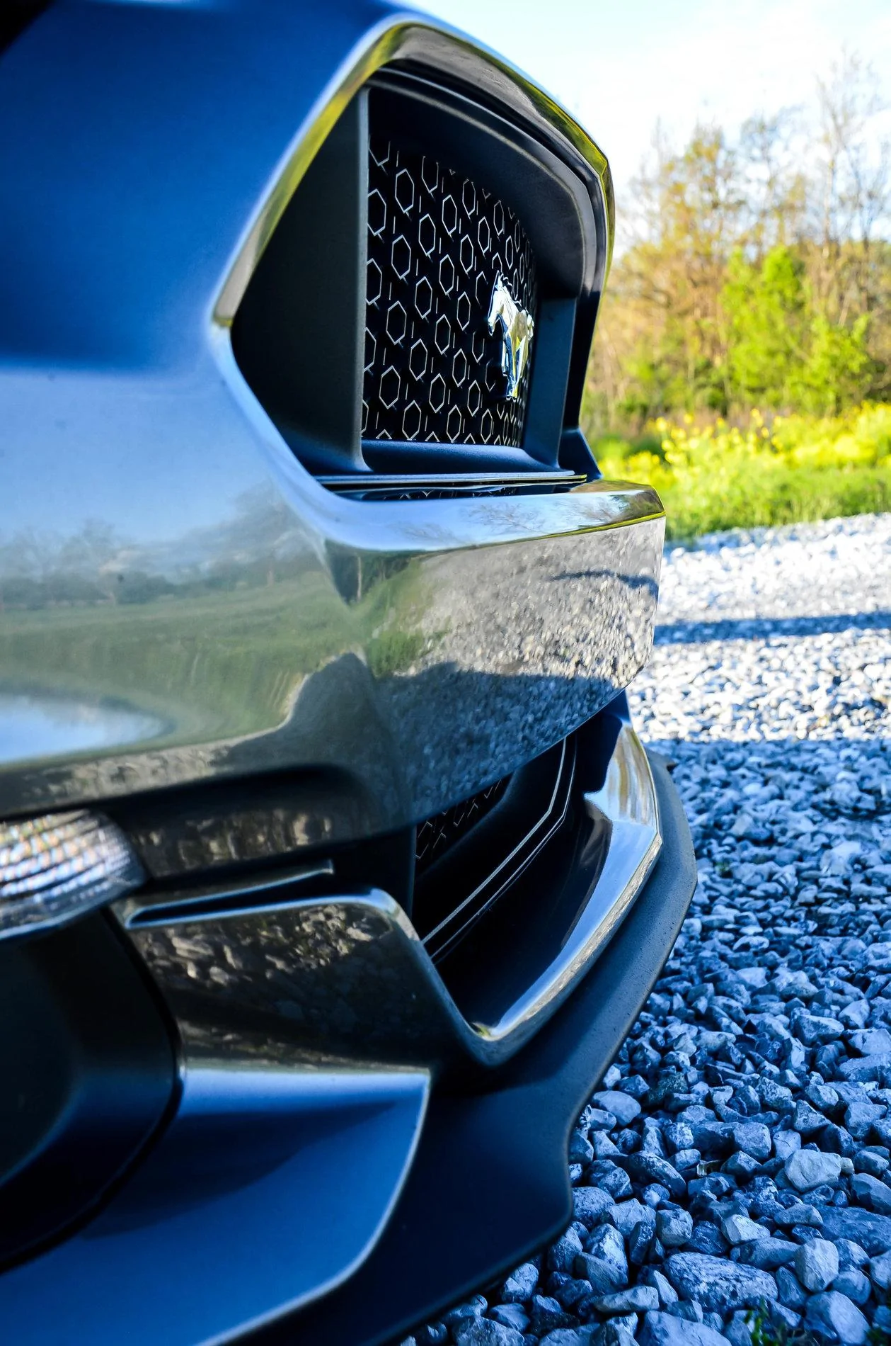

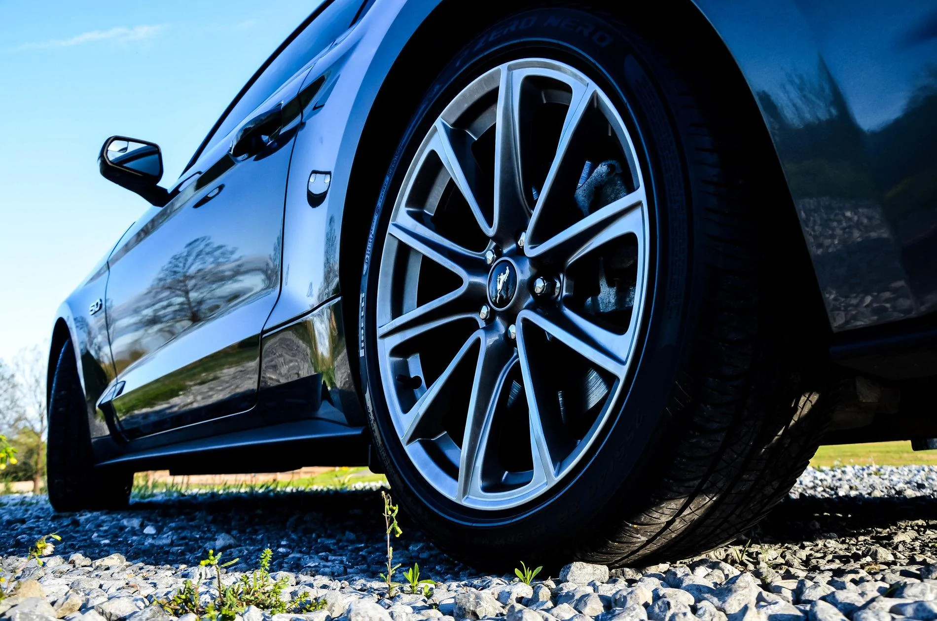

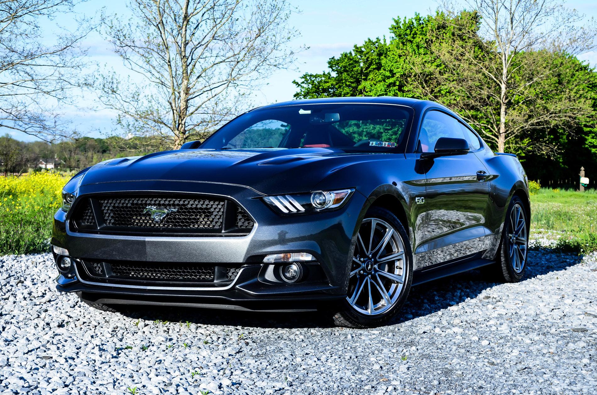

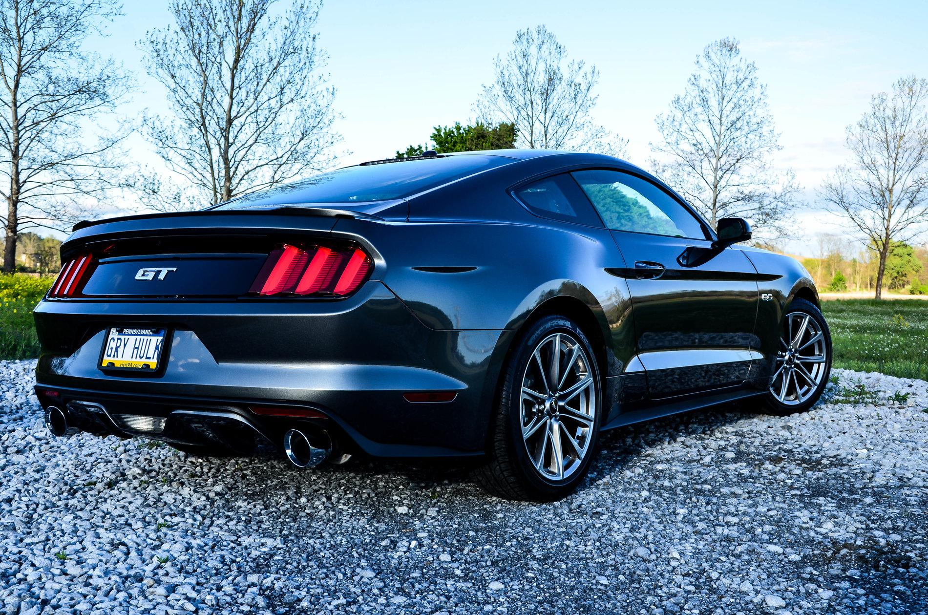

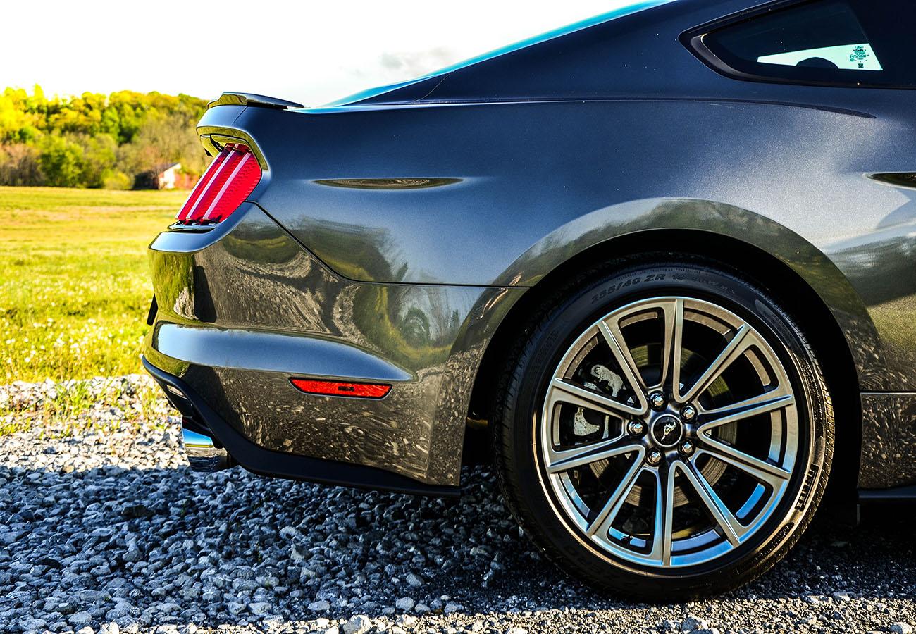

LIGHTNINGBLUE: I think you are my brother from a different mother when it comes to detailing! I am aligned with your comments. I also am a fan of Wolfgang products. I have just reordered what I needed to do a complete paint correction using Wolfgang product and some car pro mixed in their.
Kimball, Yes, LT is correct on how ceramic coatings could possibly damage your paint. If not applied correctly and you let it flash without wiping off the excess it will look terrible. I have not seen this happen, I’ve only read about it and saw pictures in detailing forums. Some say you can not run your vehicle through a standard car wash as the Chemicals may stain your finish. I have not seen this myself. LT is also correct that a lot of your questions can be answered on a detailing forum. I joined one years ago that is associated with auto geek. Go to their website for a link to the forum and join. I’m a good weekend warrior that has been detailing cars since the 80’s. But it’s just a hobby for. There are pro’s on that web site that are happy to talk detailing. Mike Phelps will answer your questions some times as well. Mike is the detailing czar as far as I am concerned, His advise and technique video’s are great.

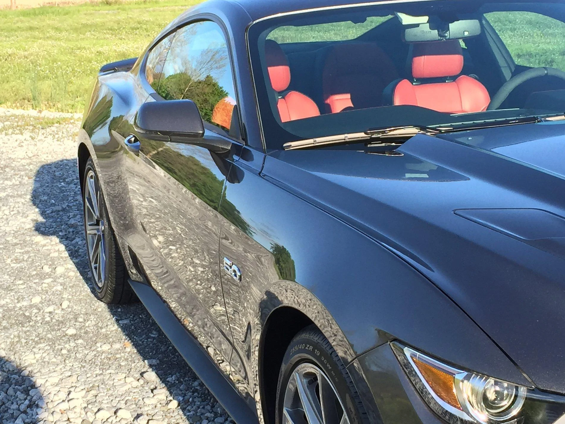

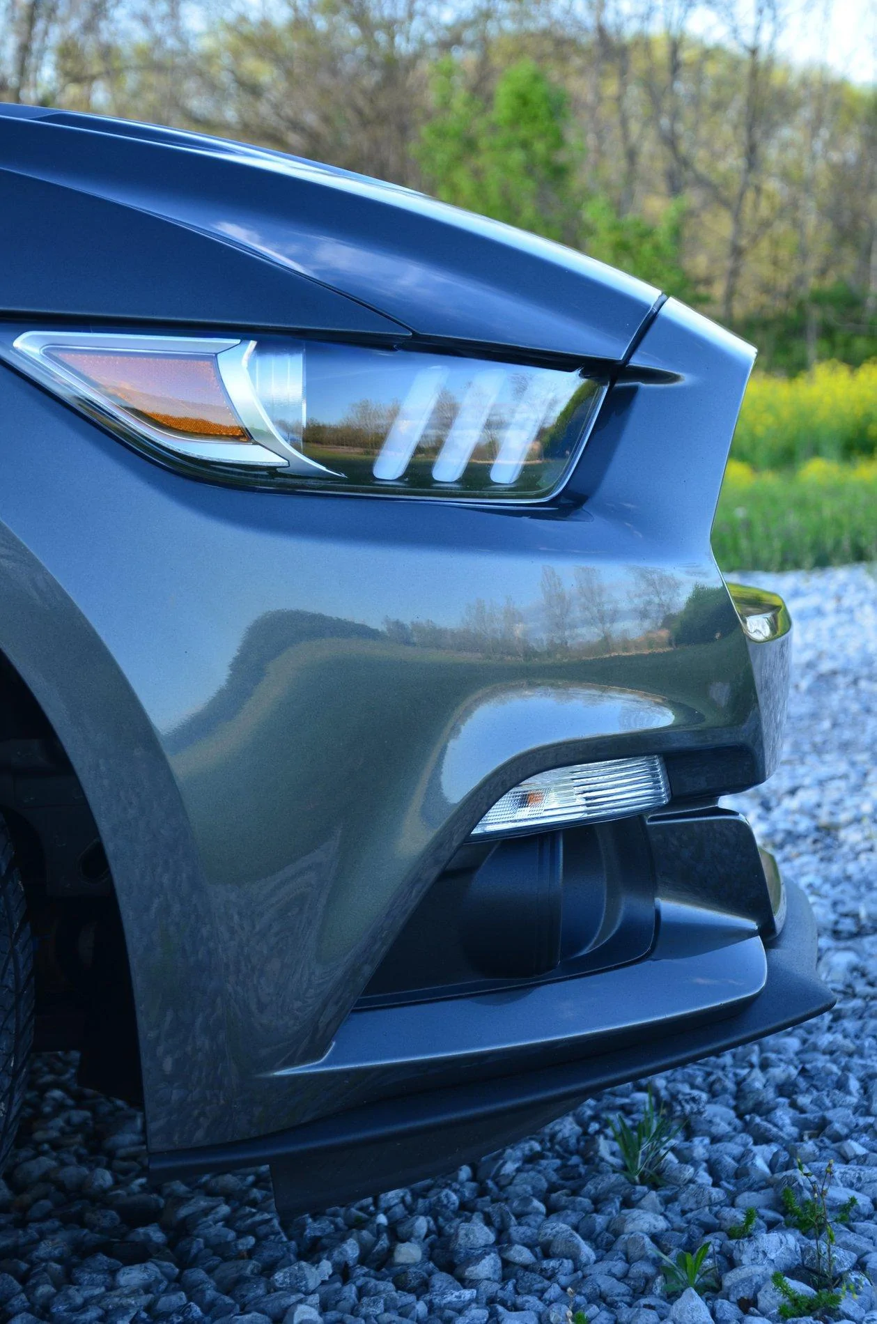

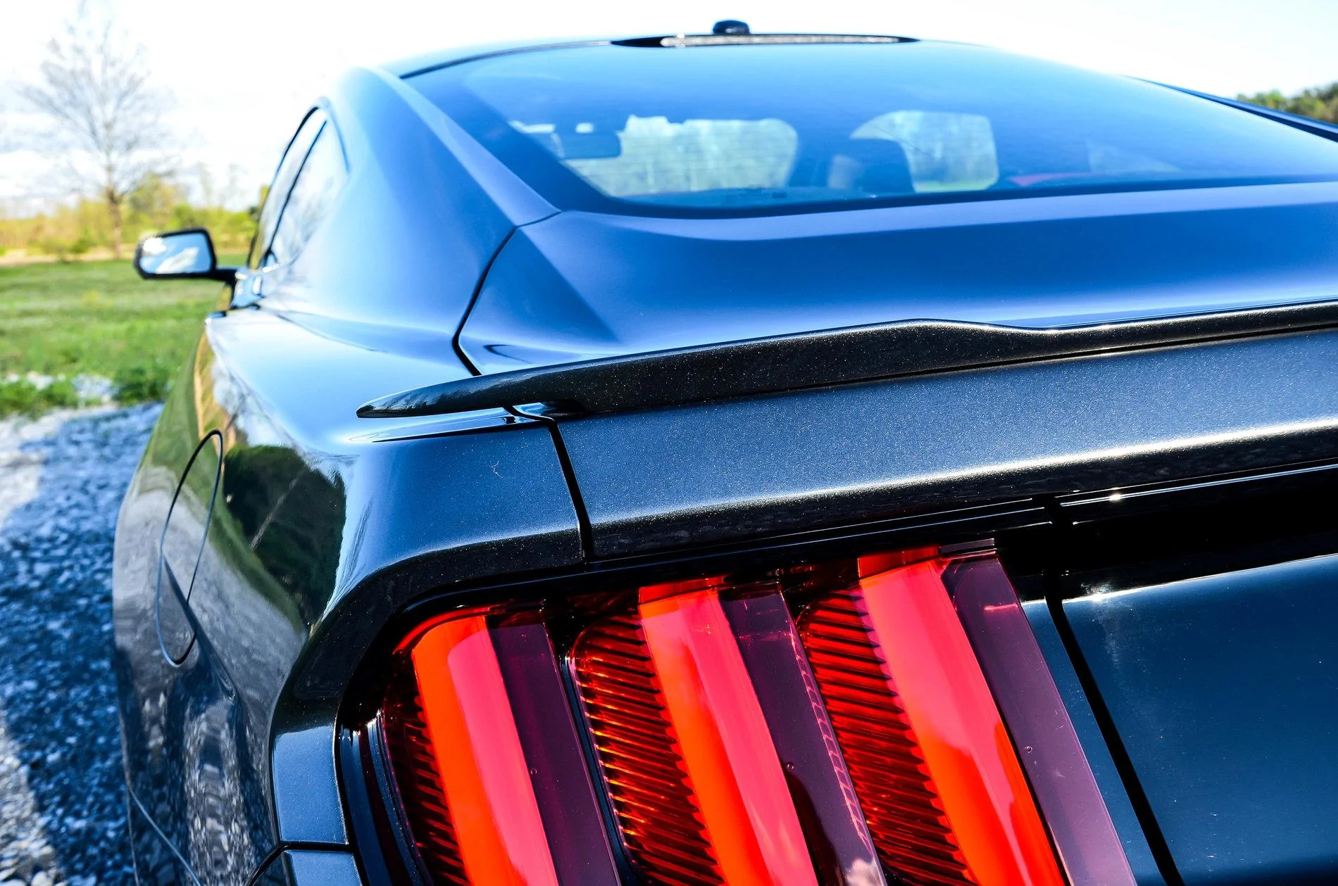

below is my Mustang after it had a ceramic coat applied to it in Oct 2016. It’s relation to our trucks is the paint. It is the Ford Magnetic Grey. I told the sales guy to not let the dealership prep the car for me at all. I would take care of it. I did the paint correction, but then handed it off to a professional detailer that was certified to install Modesta ceramic finishes. IMHO, Modesta is the best ceramic out there, you and I can not buy it, it has to be installed buy a certified detailer on their product. That detailer has become my friend now and has given me great advice over the last 4 years. Each time it gets washed, it gets another spray coating of carpro reload to freshen up the ceramic coating. My Mustang still looks like this and the coating is still working after 4 years. It has a 10 year life span according to the manufacturer,
if you are going to apply your ceramic with one of the ones out there, just watch the video’s on how to use it. Maybe practice on something else that you don’t care about. I have the hood from my 2014 Mustang, magnetic grey, that was pelted with hail. It was damaged so bad it had to be replaced. Can’t fix aluminum body panel parts. I told the shop to save the hood for me, most of the time it lives on my garage wall. Sometimes, it’s used as my Ginny pig.
Something to think about, I bought a buffer when I first started that was over $350 dollars and I still have it today. It still works like it did when new. Good tools will serve you well. You spent a lot on that truck. You spending a lot buying good detailing products, buy quality tools.
I can’t sling my original buffer like I did in the 80’s, because of its weight, but it’s still great on the horizontal surfaces. It’s a Gem buffer with an 18 inch pad. The fricking unit has a cast aluminum body. I think it weights near 20 Lbs. using it on vertical surfaces (the sides) is like throwing a bowling ball 50-60 times for each side. The unit is a complete monster. It only has an on/off switch. One speed. I love it!
