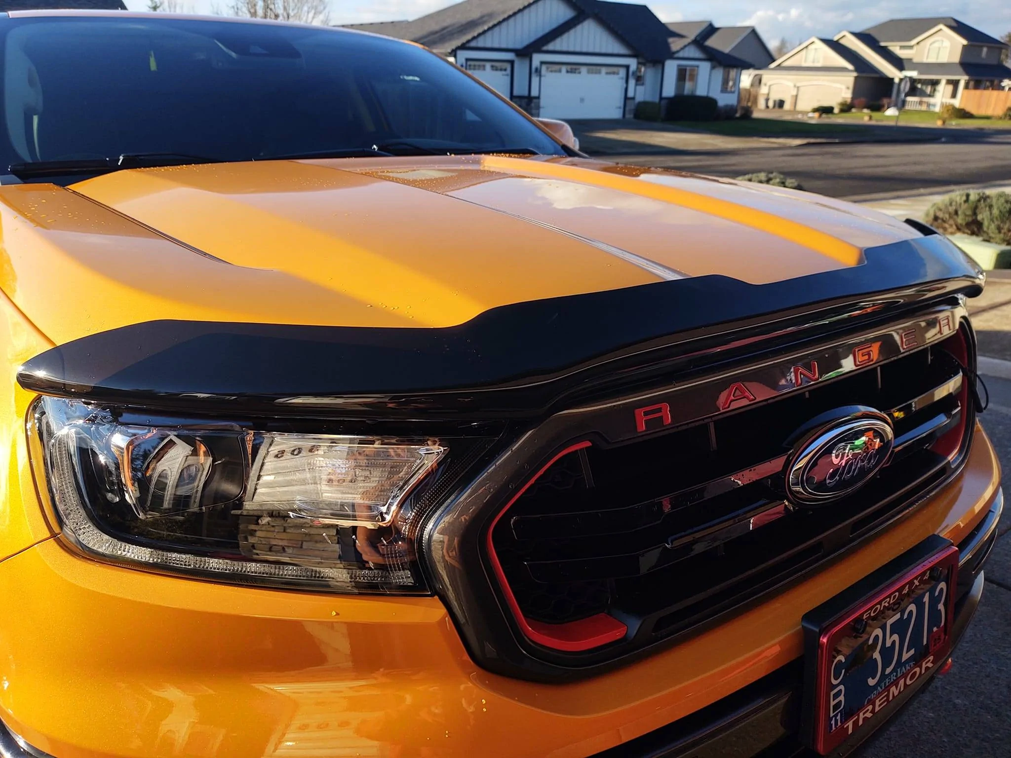

I have a 2021 Ranger Tremor. I do not drive much at night, but, on a short trip last night I had 2 people flash me as if my high beams were on. They were not and my lights appear to be properly aimed. Is this just an issue that oncoming drivers are not use to the white LEDs? Or that having a taller truck, perhaps due to their vehicle height...it just appears to them that my high beams are on?
(I have not has a vehicle with LEDs before)

Thanks for merging my post over to this one. I read all 5 pages of comments.
Mine is a stock Lariat Tremor. My take; If the oncoming car sits at a different height or too low...nothing I can do about that. My guess is that my headlights are aimed to a factory "sweet spot" and that is where they are supposed to be by law here. I cannot adjust them to fit everyone else's vehicle height or how high or low they sit in their seat. It is MORE important that I see the roadway, that I can see hazards, see potential deer/game, etc. I will be as courteous as possible and tend not to turn my high beams on to show the other driver that they were not. When the roadway is clear of oncoming traffic, I have the light bars in the front bumper and ditch lights to light my way (and hope a 747 does not mistake the highway as a runway!) Thanks for all the responses here and hope you all have a GREAT CHRISTMAS!!! :rockon: ?????
