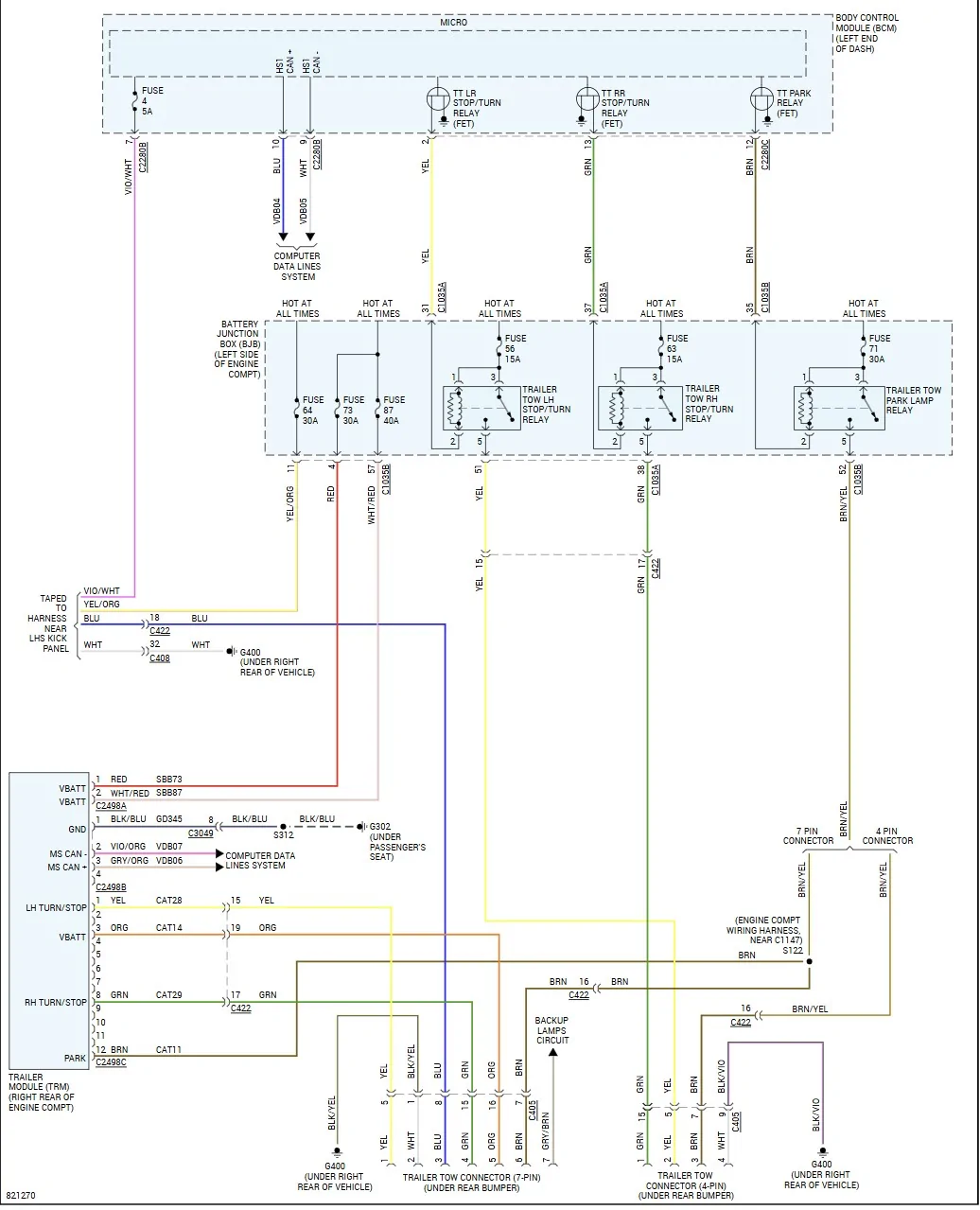

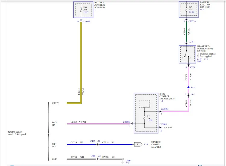

Understand that you are missing (1) wire that runs back to the Trailer Connector
The (Blue) Wire at C405 Pin 8 - Should (Dead End) at that connector.
This is the (Trailer Brake-Activation) wire and is the reason you need the new harness as if I am correct (The Blue Wire) Terminates and Dead Ends at C405
Also understand that the Ford wiring diagrams are not truly an exact match to how its actually wired.

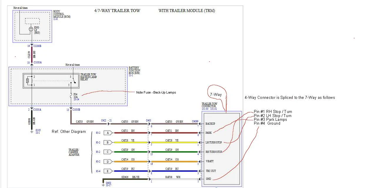

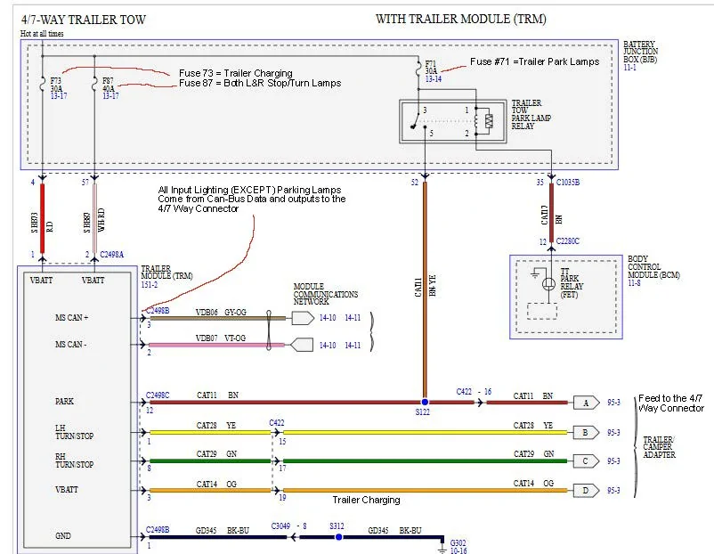

Point is that all Rangers have the Trailer Module even if you only have the 4-Way connector and the lights route through it - with the below diagram - it does not show that.
It also does not show the (splice) for the 4//7 Way split for those that have both connectors.

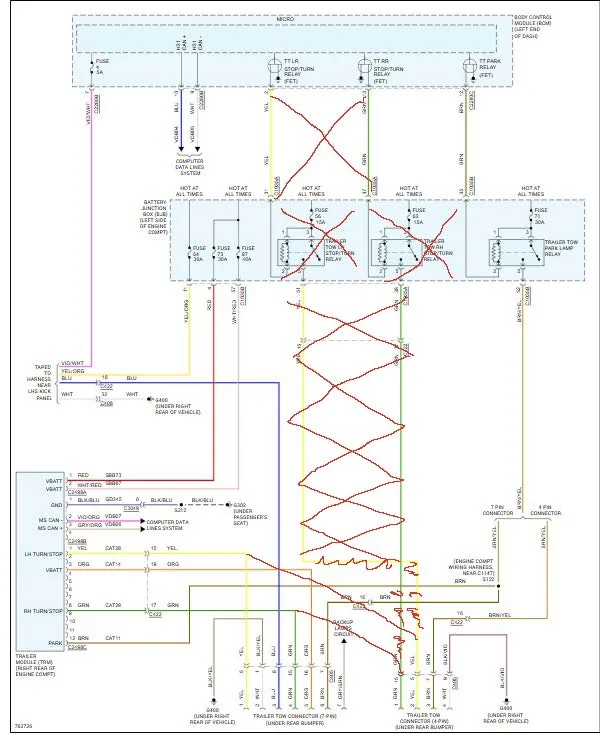

Understand by looking at the diagram below and note the (4-Wires) (Taped) - note how they route - This is where you are getting confused.
These may clear it up better (Diagrams)
I put this together to help clear the confusion.
Corrected Diagram

Actually there are (3) wires that dead end at the C405 connector if you only have the 4-pin trailer connector. Besides the blue brake controller wire there also the 12V auxillary power wire (orange) and the backup light wire.
